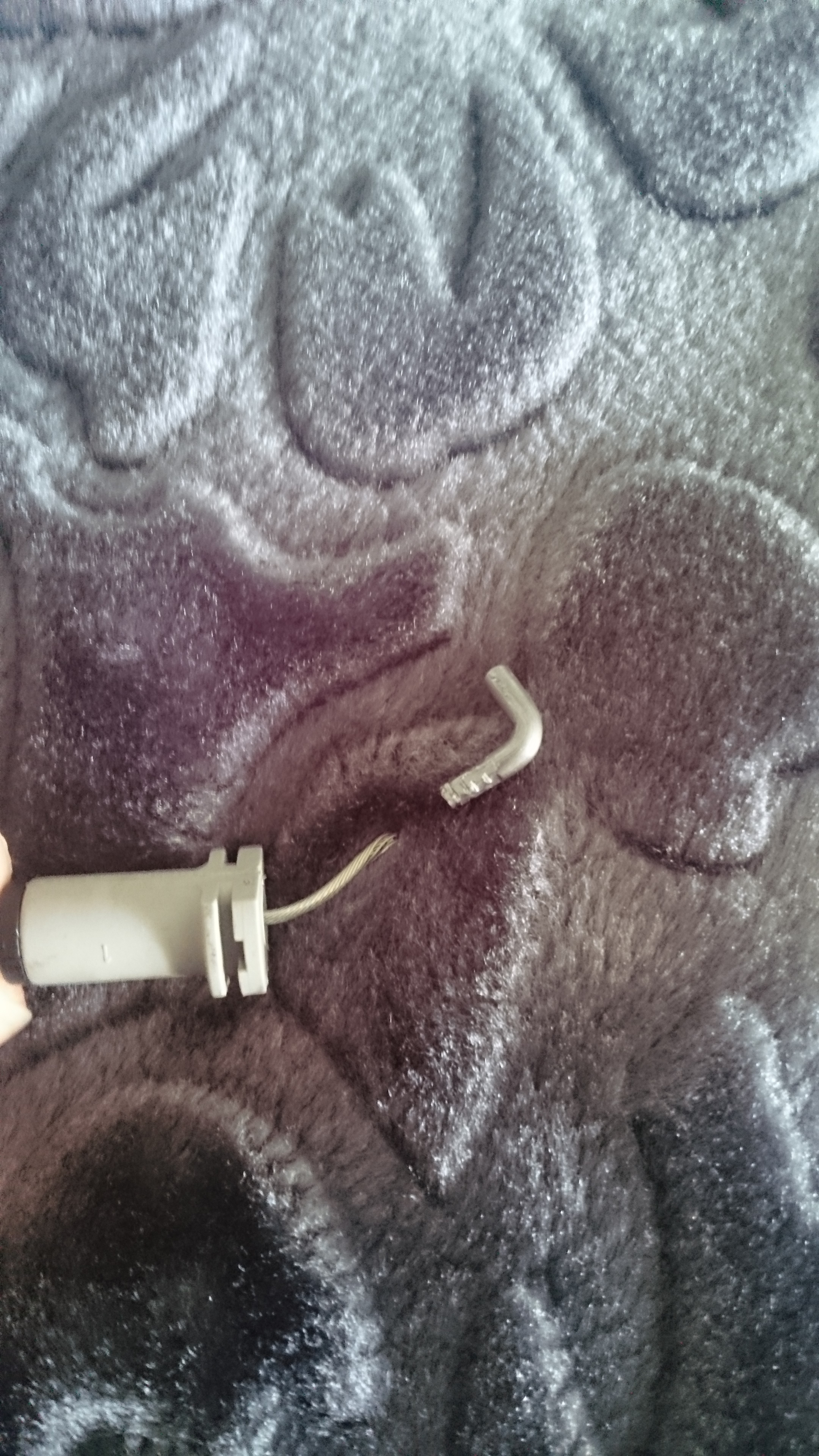

How can I fix a VW Passat B5 sedan boot lid that no longer opens from the outside handle or key because the release cable seems broken?
The release cable between the cylinder/handle and the lock is broken, and the actuator itself still moves, but the cable is loose and does not pull the lock lever [#17454441][#17454461] To fix it, shorten the black cable sheath/armor rather than cutting the steel cable, so more cable protrudes and can reach the lock lever again [#17456771] The cable length is fixed, so the repair is to trim the armor experimentally by a few centimeters until the cable end comes out through the lever opening and the connector fits properly [#17456526][#17456771] You can then secure the cable with a suitable connector, and if needed shorten the armor on a straighter section and join it back with tape or heat shrink to keep it centered [#17455954][#17456771]

    Do you have a broken cable from the cylinder / from the flap side / connecting it to the lock?
    Maybe it broke up in the middle of the armor, or the armor got out of the handle on the cylinder.
    vw passat b5 - Locked boot lid in the b5 sedan after lifts 2003
    In the film, the actuator works, only the rope is as if loose, unstretched, not pulling towards the lock.
    Edit
    A torn cord in a green place made of white plastic, nothing comes out of the hole, and probably should the cord? In the video at certain moments it probably shows.

    @ g107r You're right, broken line. You can see in the video that I haven't seen before.

    vw passat b5 - Locked boot lid in the b5 sedan after lifts 2003 vw passat b5 - Locked boot lid in the b5 sedan after lifts 2003 vw passat b5 - Locked boot lid in the b5 sedan after lifts 2003
    You're right, the broken link I pulled out, now I have to somehow connect that broken link.

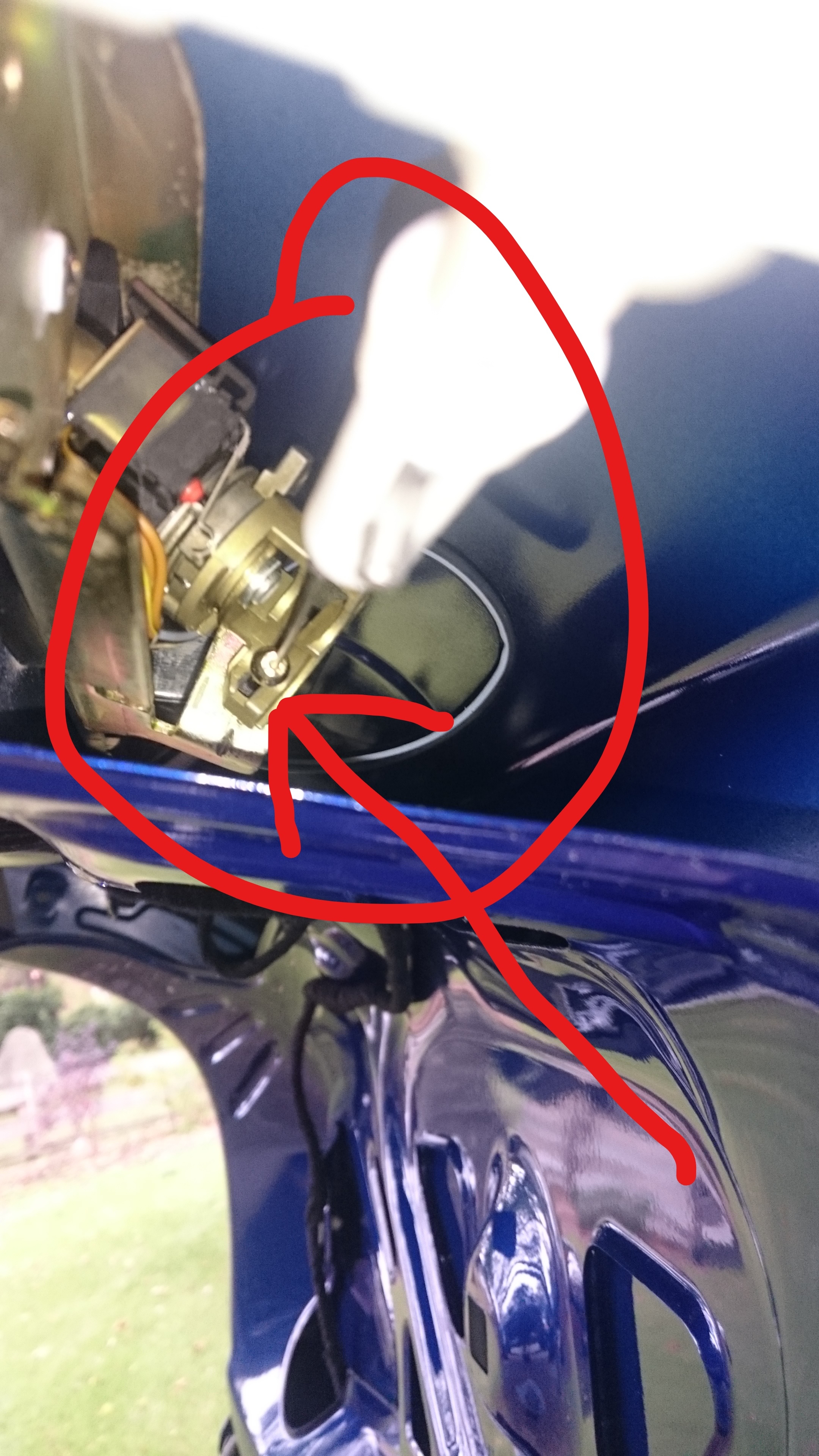

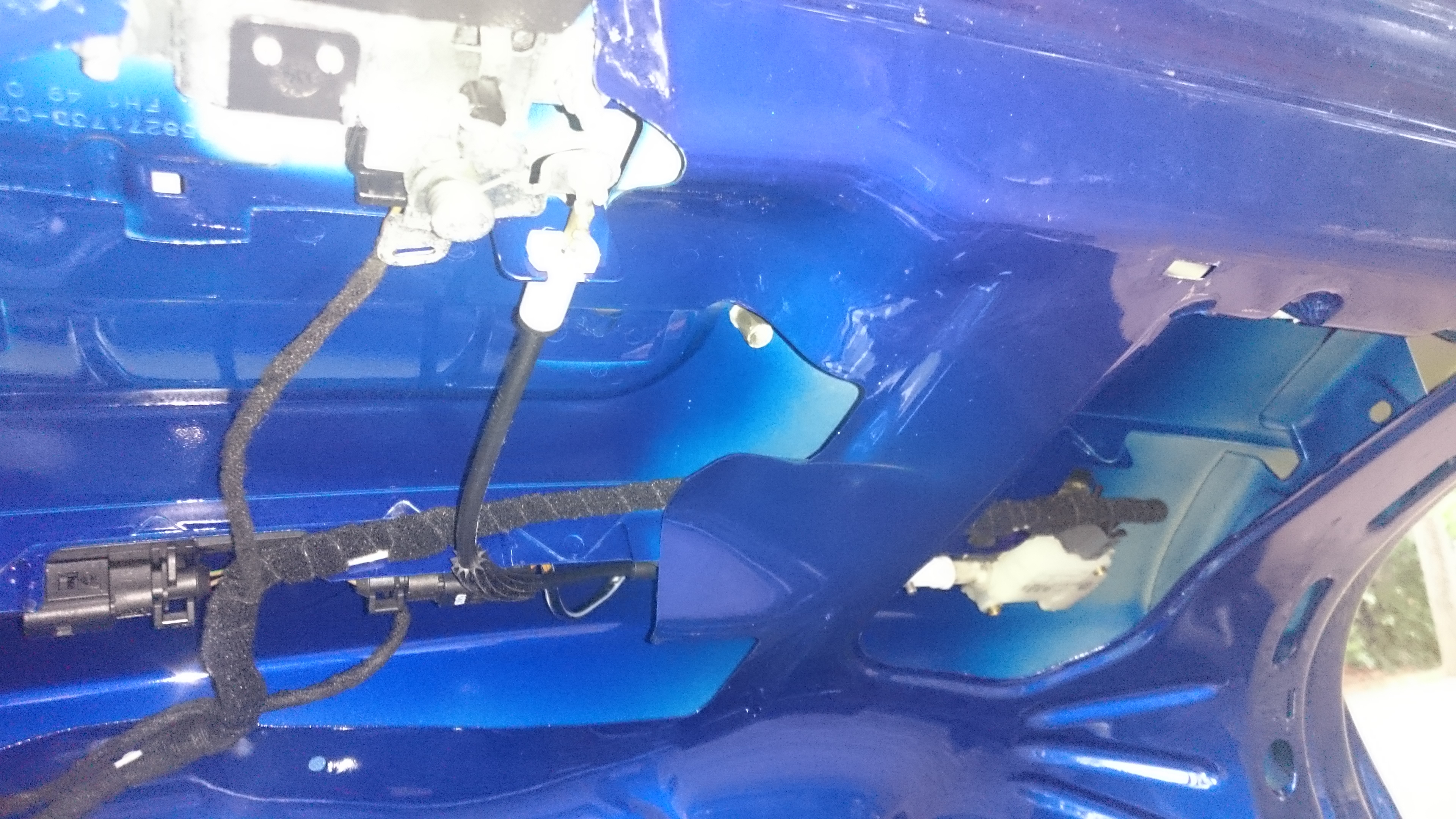

    vw passat b5 - Locked boot lid in the b5 sedan after lifts 2003 vw passat b5 - Locked boot lid in the b5 sedan after lifts 2003 vw passat b5 - Locked boot lid in the b5 sedan after lifts 2003 vw passat b5 - Locked boot lid in the b5 sedan after lifts 2003 vw passat b5 - Locked boot lid in the b5 sedan after lifts 2003 vw passat b5 - Locked boot lid in the b5 sedan after lifts 2003
    [Film: 7d9427490a] https://filmy.elektroda.pl/2_1537716608.mp4 [/ film: 7d9427490a]
    I attached the line in the pictures marked in green as you recommended but still the trunk does not open
    and in the pictures the place marked in red and with a bit is the moment when I do not know if I put on this well, whether it is to be before or after
    I also attach a video after installing this cable and closing the trunk from the inside but still does not open.
    And pull it all the way to the end of the cord marked in red.
    For mine, it should be like a green arrow, and it will not be, because with this connector you extended the line, the length of which is quite strictly defined, or the connector does not hide in the armor :) because he can't :) and the cable movement is too low ...
    Seriously, you don't see how the lever from the big toe moved / in the earlier film, WATCH it /, and how does it move now?

    You treat it as a whole, and it consists of two elements in total. The black armor has a broken steel cord.
    You would have to remove one final plastic from the armor and shorten / experimentally / armor, e.g. 2cm - as long as you need to pull the cable out of the armor so that it comes out through the hole in the lever opening the lock. The end of the cable next to the actuator is to be as marked in green - initially, because I suppose it would be there.
    You will not use this bent element that has been torn off, now you will put the cable in the lever and secure it, turn the electrical connector on one or better two screws - like the wires for which it is intended.
    OR cut the armor on a more straight, not folded, as seen in the flap, and shorten one end by the needed centimeters. Connect by wrapping with a tape, or heat shrink, a plastic piece of pen, when the armor would enter quite tightly. So to stiffen and center two pieces of cut armor. If the art did not want to get off the armor ...
    Something like this should work, the whole line will be more straight, not after the arc as it was. 2-3 cm will not change anything and you have 2-3 attempts to cut it before you completely straighten the lock-cylinder arch.
    We do not cut the rope, it has a fixed length. - if not for the stupid end at the cylinder, you would buy and bicycle ...
    You shorten the armor itself, the steel cable protrudes more.
    You would make it longer, the rope would be hidden.
    You have to shorten it enough so that the cable comes out through the levers and makes it possible to twist the ankle.
