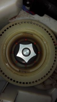

    Maybe someone will help the grinder in my coffee machine after cleaning it gets clogged after trying to make one coffee, this is how the grinder looks after cleaning, Krups EA8080 Coffee Machine Grinder Clogging Post-Cleaning: Observations and Queries
    in an empty mill without coffee, the coin mechanism normally rotates
    Added after 57 [second]:
    [Film: 94a7019584] https://filmy.elektroda.pl/77_1513000612.mp4 [/ film: 94a7019584]
    so the coffee maker behaves when making the first coffee after cleaning

    The mill is already bad, the shoulder is worn, try to set a little thicker grinding.
    Unfortunately, the setting of thicker grinding is not enough for you or do you think to change the entire grinder or just replace the coin mechanism with these blades?
  • #4 16884669
    pawlok7797
    Posts: 115
    Rate: 107
    As you can set the blades themselves, you can easily replace them. As the original part, there is a whole grinder. I suggest also when replacing the mill replace gaskets on the piston often when you let the mill glue.
    #6 16885116
    pawlok7797
    Posts: 115
    Rate: 107
    As for the gaskets, however, I would suggest original blacks, In the mills I never changed the blades themselves, I think you can try, especially for the difference in price between the new mill is big
  • #7 16885176
    malybhoy
    just wonder if this mill is not too exploited anymore and replacing the blades themselves will help in the short run
  • #8 16885357
    pawlok7797
    Posts: 115
    Rate: 107
    It's hard to say the engines in these mills very rarely sit down, usually it is so that the piston seal starts to release and seal the coffee outlet and wipes the blades.
  • #9 16889754

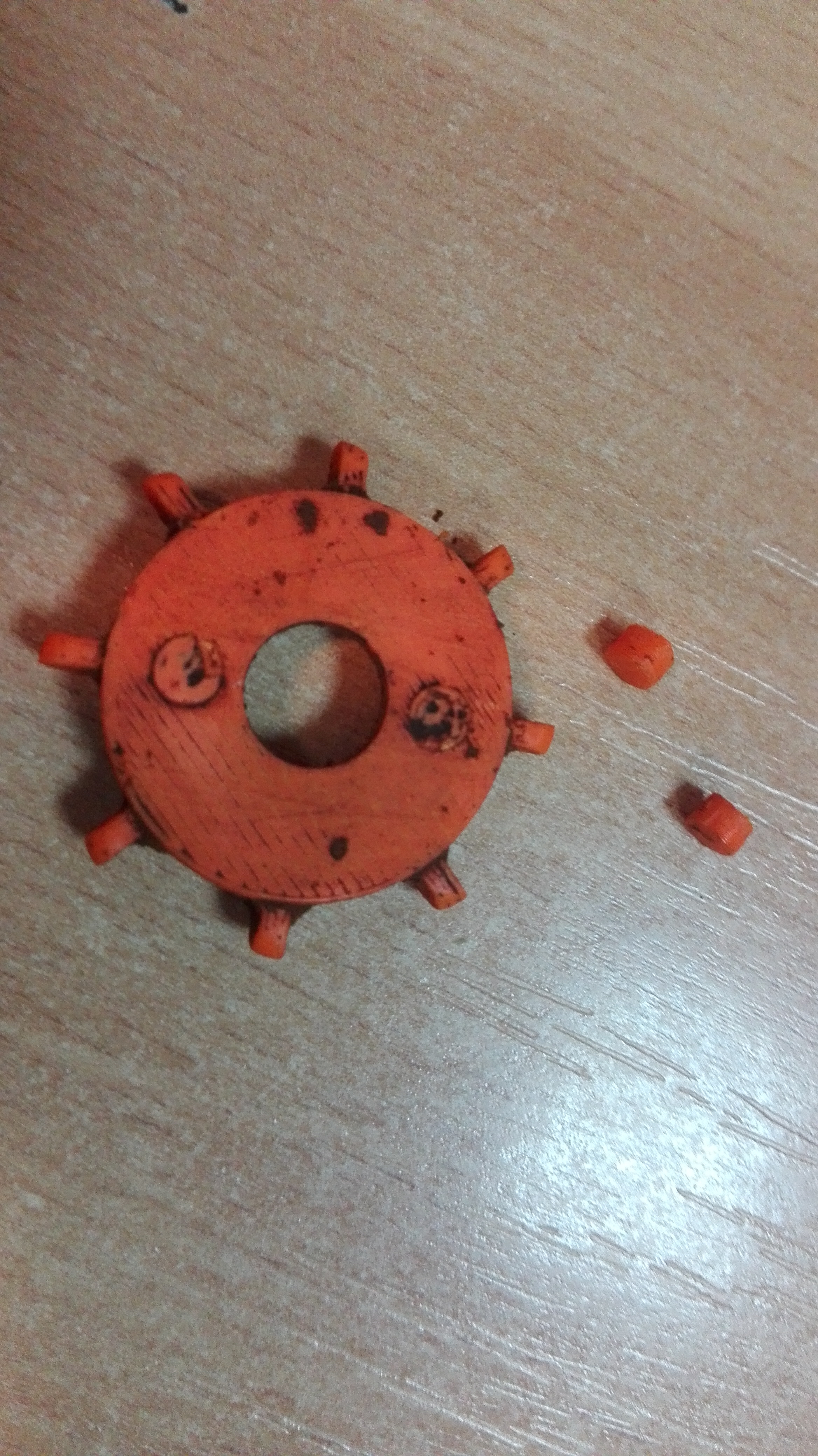

    malybhoy
    culprit found, broken hooks that attach the scraper with the stem :)
