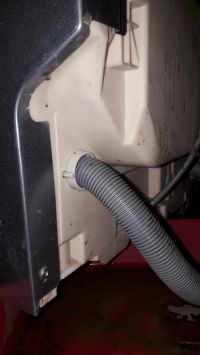

    Hello, I have a big problem, a water leak appeared at the dirty water drainage hose. What can be seen in the photos. I was looking for photos of how my dishwasher is built, but not effective :(
    I am looking exactly how the drain tank is built and how it is mounted in the housing, because I can not see anything. The hose is available for purchase, but I also can't see how it is attached to the dishwasher. What I currently have is not dismantled because so far the dishwasher works and I try not to flood my neighbor. I am asking for a hint of users of similar equipment. I can add that the machine cleans very well by choosing the right cubes, taking care of clarity.

    Unscrew the right side (the one next to the snake) and everything will be clear. The hose is connected inside to the drain pump.

    There's a hole in the hose and there's a leak. Hose to be replaced and it will be after the problem.
    As Zibi wrote + remove the front plate (the one under the door of the dishwasher and you will be able to admire the hose in all its splendor. When disassembling, it is more convenient to break off the old hose at the casing.
    Generally, in these dishwashers, rearranging the hose is not the most pleasant one, but there is no tragedy either.

    Thanks for the hint. After removing the side, the damage appeared. The hose breaks right after the dishwasher. It must be replaced because the possibility of further cracks will damage it. At the moment I have tightened the hole very tightly with the tape and it is not leaking.
