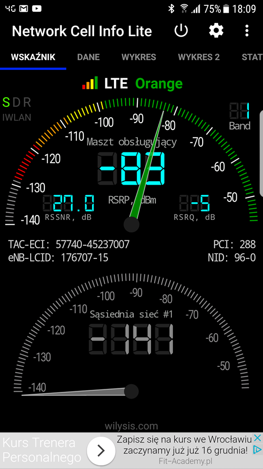

    I installed the network cell info application and my lte on the orange phone shows me RSRP -90 / -86 on the rssnr 23/25 scale rsrq -4 / -5 within these limits

    Show screen from NCI, it's ECI, eNB. Signal parameters good as speed? As for Play, first make tests on the Internet Pre-paid card at Play for 9 with a 100GB bonus. I will describe the way to DIL on RBM on Kart5 and the way to RWK at PW. And the router is weak as for such money. Without aggregation of LTE bands, only 3 category LTE, WiFi in N, 100Mbps LAN ports, without the possibility of forcing specific LTE bands.

    I sent a screen with the settings from the program on the phone
    And as for the router, I can buy it for PLN 50 :) so it's not expensive, but what router do you recommend? but not cosmically expensive

    Where does this price come from? These 50 zlotys is worth it if of course fit. But this is not a test from Bydgoszcz, only from Lower Silesia and a connection on LTE800 Orange with BTS Drołtowice.

    yes, because I am currently in drołtowice in the countryside, I just wanted to find out if this is a good connection, to compare the power to connect when I am in Bydgoszcz
