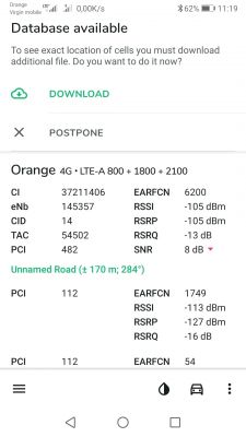

    I've done some reading but I'm still green. Currently I am in the process of choosing an LTE Orange office internet router. My GPS location: 53.131131 17.797786 53?07'52.07'' N 17?47'52.03'' E (Lochowice 86-065). I haven't done any cell phone tests yet - I plan to do so in the near future and will post the data.
    Orange offers me 3 routers b818 - PLN 720, b618 - PLN 432 and B535-232 for PLN 384 gross. After the tests, if necessary, buy a roof antenna. I have a cable run from the mediabox (in the garage) to the top of the chimney.

    After all, there is nothing to think about here, the choice is one, i.e. B818, the others are useless for Orange in this location, but the basis will be the tests of this operator that are needed to select an external antenna, this one is of course the basis and necessary. What is the cable released on the roof, there should be two with an impedance of 50 Ohm.

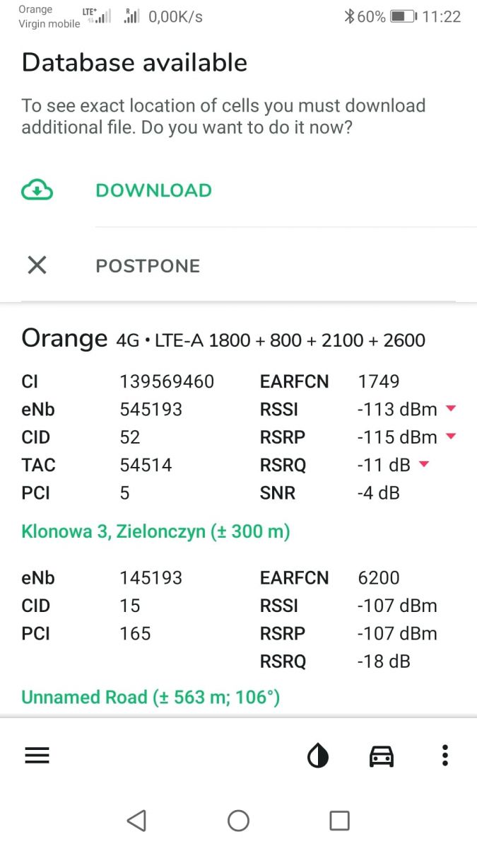

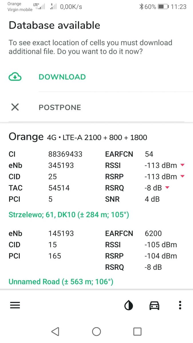

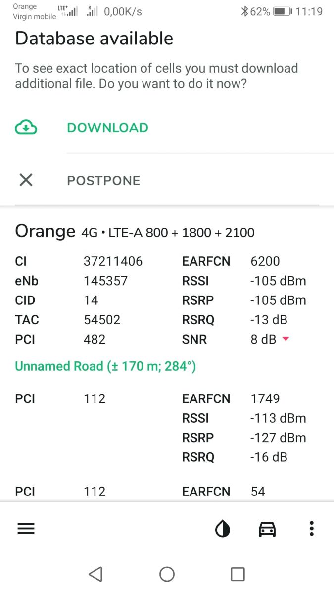

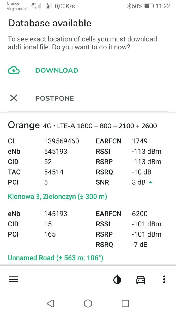

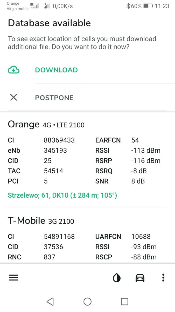

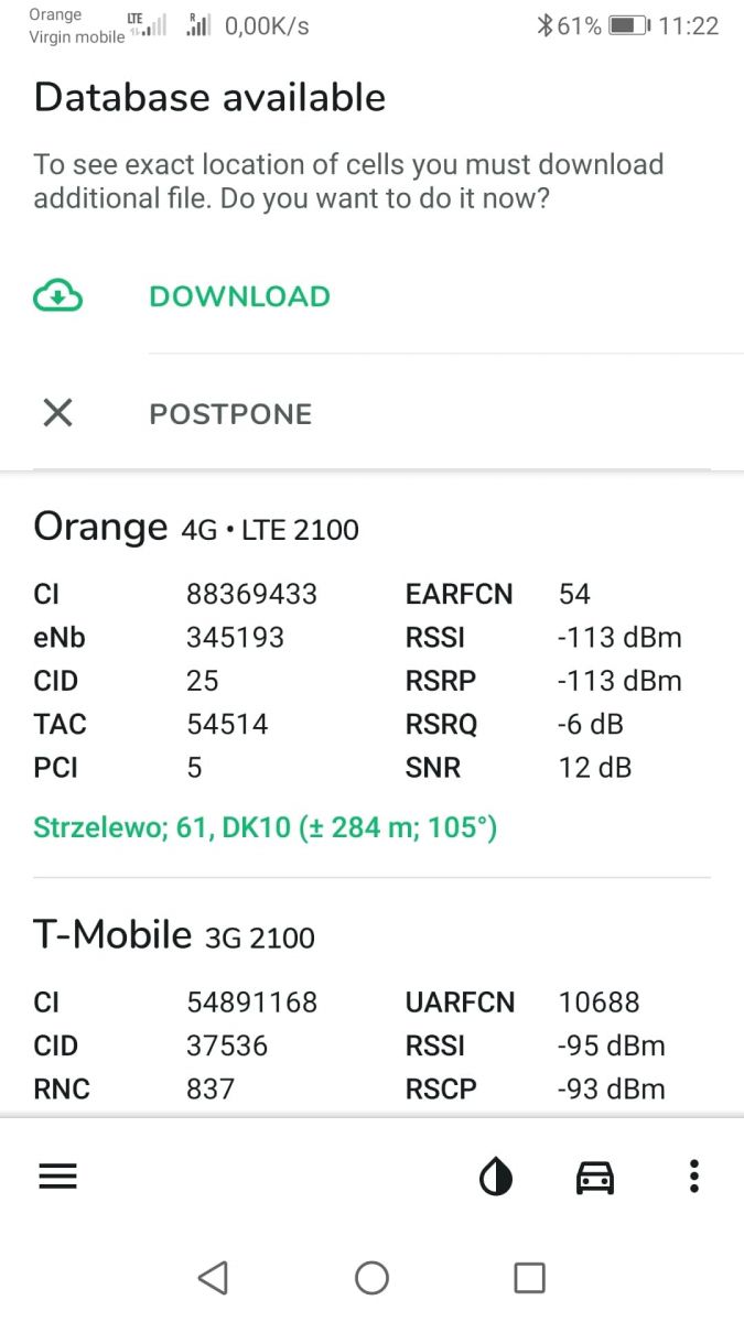

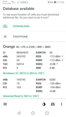

    Cables do not matter so far and you have to pull new two to the external antenna anyway, the key is whether you have already chosen a router and will it be B818? Because on it you will have to do specific band and eNB tests, preferably putting it outside, based on them, the selection of the antenna and setting it to a specific BTS. And as for the specialist in antennas, cables for LTE, there are practically no such.

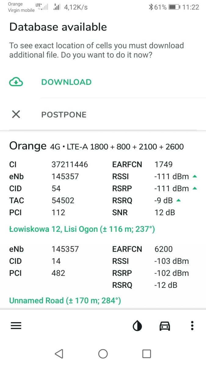

    I came with the phone near the house and took some netmonster screenshots
