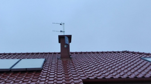

    Today I'm planning to mount 2 antennas atk 10 on the roof and I wanted to ask how to mount them on a metal tube. Horizontally below, vertically above or vice versa? And the optimal distance between them is 60 cm?
    Can it be the case that I connect the lower level, put on the left (Rx) socket of the B315 router, set the best value accordingly. Later, I put the second one above vertically, connect to the socket on the right side of the router (Tx), also set the optimal values by turning the antenna ...?

    Mount as you write and cables for B315 can always be swapped. Antennas towards the same BTS. You check the parameters after setting both.

    And this main, horizontal can be upstairs? It's always 50 cm higher, I get on the roof ...

    50cm is no difference, and we are talking about antenna and dipole elements vertically and horizontally.

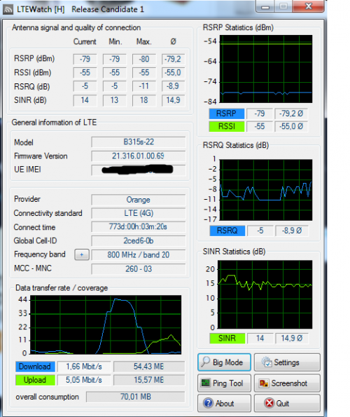

    The results of my work:
    Condition without antenna from yesterday at around 23:00 (little overloaded BTS)
    RSRP -100
    RSSI -74
    RSRQ -9
    SINR - 13
    Condition after assembly 2 x atk 10
    Installing 2 LTE ATK-10 Antennas on Metal Tube: Optimal Distance, Orientation & B315 Router Setup
    At 15:00
    BOMB!
    Installing 2 LTE ATK-10 Antennas on Metal Tube: Optimal Distance, Orientation & B315 Router Setup [/URL]
    I'm doing a test tomorrow morning :)
    Thanks to mothers451! you are doing an amazing job in this forum!

    Added after 14 [hours] 21 [minutes]:
    Gentlemen, how is this possible! At 800 Mhz?
    Measurement on different servers:
    I understand that bts in the countryside ... unloaded ....
    But such speed? Does it work though, 2 x theoretical 75 Mbps?
  • #10 16902301
    makosuu
    Posts: 2984
    Help: 369
    Rate: 370
    This speed is not possible on LTE 800 Orange. Here max 75 Mbps.
  • #11 16904013
    mysiul
    Posts: 29
    Well, it happened only once to me, after a few days of use, I see that max 70.
    I don't know what it was .... :D
