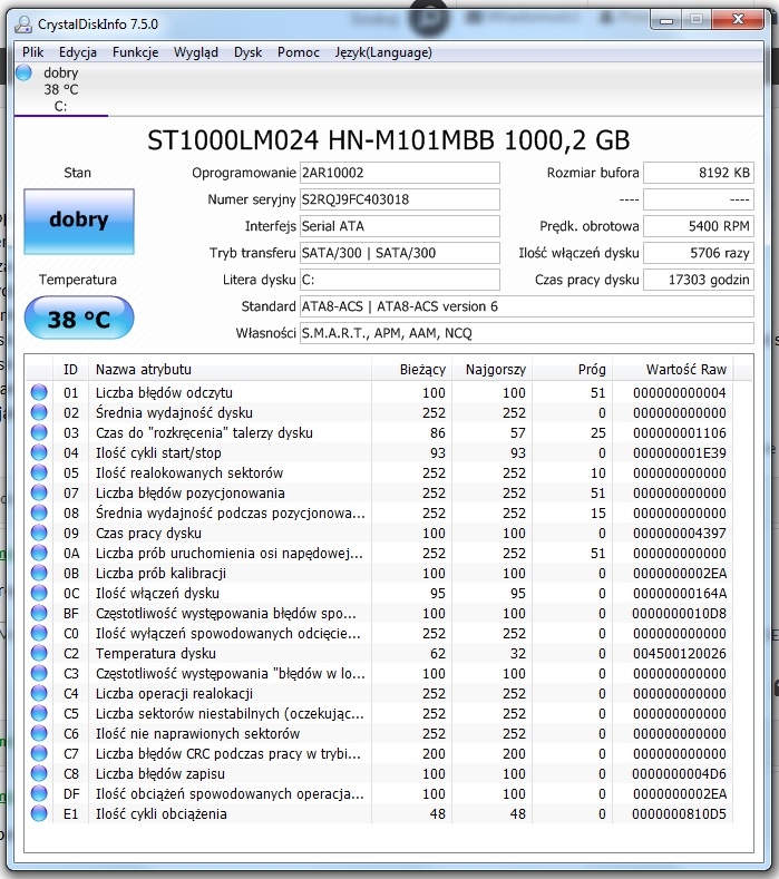

  • #2 16893878
    Kasek21
    Posts: 45661
    Help: 4981
    Rate: 3547
    Post the screen from CrystalDiskInfo.

    As mati221p wrote:
    Attributes 01, 03, 0B, C8 - mechanical problems of the drive
    the drive is over and that's it.
    Buy a good SSD and it will be after the problem and also much faster.

    artaa wrote:
    But you get your doctorate ;-)
    Certainly not me.
    The parameters, by the way, regarding the surface condition, but they have nothing to do with the fact that the disk does not want to work in a frame in a laptop and it works without a frame. Yesterday I spent half a day to figure out what it was all about. The first time I have encountered such a thing, the disk in the frame does not work and without the frame it works. In my post, I provided a link to my topic with such a problem and wrote a way around it.
