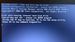

    Hello. This morning my laptop broke ... it was used normally and suddenly (I personally did not see it) an error popped up and the laptop reset but there is a problem, it cannot see the disk ...
    And something like that pops up after this della logo, the problem is that neither F1 nor F2 works for me ...
    Dell E6400 Laptop Fails to Recognize Drive: Diagnosis and Potential Fixes
    While charging, when the Dell logo is displayed, the laptop makes such a noise
    [movie: f48cae2948] https://filmy.elektroda.pl/37_1513617635.mp4 [/ movie: f48cae2948]
    Can the laptop still be saved?

    Obviously damaged HDD, the sound as if the heads were parked on the plate. Replace the HDD and the laptop will "flicker".
    PS. The HDD is pulled out from the side. On youtube, search for E6400 HDD replacement.

    So nothing can be done about it, you have to buy a new disk? And where can I find such a disk? Can it be an ordinary disk like a computer or what it looks like because I don't know much about laptops. After entering even in google e6400, the drive has no offers, allegro also nothing

    Dianton wrote:
    the disc cannot be removed, or at least I cannot.
    It should be enough to unscrew two screws and eject the HDD with a pocket (or service remains.)
    Looking at the sound, it rather remains to replace the HDD.
    You can ask what to buy - 2.5 "HDD or SSD depending on your needs and budget.

    Thank you, so I am looking for a 2.5, yes?

    Yes, you want a 2.5 SATA drive.

    I bought this disk and now the question is is it possible to somehow recover data from this old disk? you would probably need to replace the electronics?

    Not electronics, the drive is mechanically damaged, if the data was valuable, take it to a professional company dealing with recovery.

    Okay. in any case, the laptop came to life. Thank you for your help.
