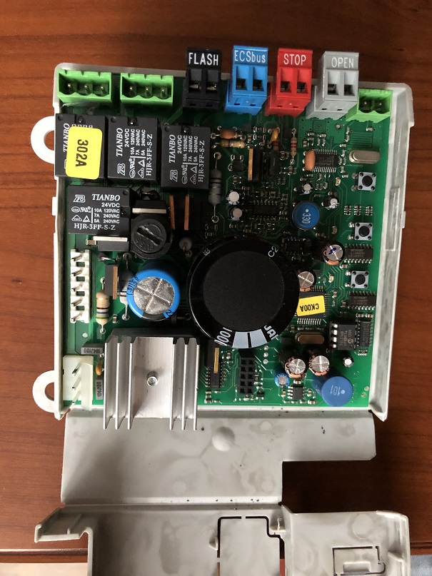

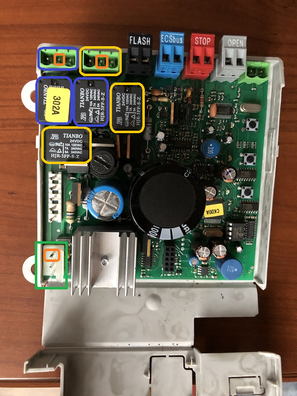

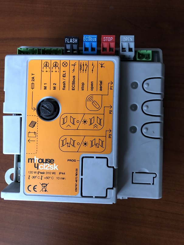

    Hi,
    I wanted to fix the Mhouse cl2sk gate control panel. When voltage is applied the relay(s) click but the gate does not open and the "ECSbus" light starts flashing rapidly. Can anyone help in the form of repairing the control panel?
    • MHOUSE CL2SK Gate Control Panel Not Opening: ECSbus Flashing, Relay Clicks, Repair Tips IMG_0082.jpg (145.8 KB) You must be logged in to download this attachment.
    • MHOUSE CL2SK Gate Control Panel Not Opening: ECSbus Flashing, Relay Clicks, Repair Tips IMG_0083.jpg (190.32 KB) You must be logged in to download this attachment.

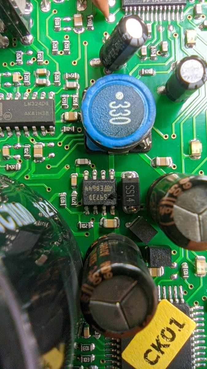

    Hello. I have a problem with the same switchboard. My dog got on it, bit the cables (already repaired) but one element marked with a black circle next to the antenna socket crumbled, it is probably a resistor connecting the antenna screen to ground. I need its value, you can't see any inscription in the photo, but you can measure it with a meter. Thanks in advance.
    • MHOUSE CL2SK Gate Control Panel Not Opening: ECSbus Flashing, Relay Clicks, Repair Tips 4638507000_1456072312[1].jpg (1.34 MB) You must be logged in to download this attachment.
    This is an smd capacitor, but I do not know what value it is, and the 2 red ball is the L5973D system

    Does anyone know what the part number for this IC is? MHOUSE CL2SK Gate Control Panel Not Opening: ECSbus Flashing, Relay Clicks, Repair Tips

    L5973D breaks down most often, it is difficult to replace it because it has a terma falling underneath. And 4 others are damaged in the process. If it is damaged, I replace 5 systems in total.

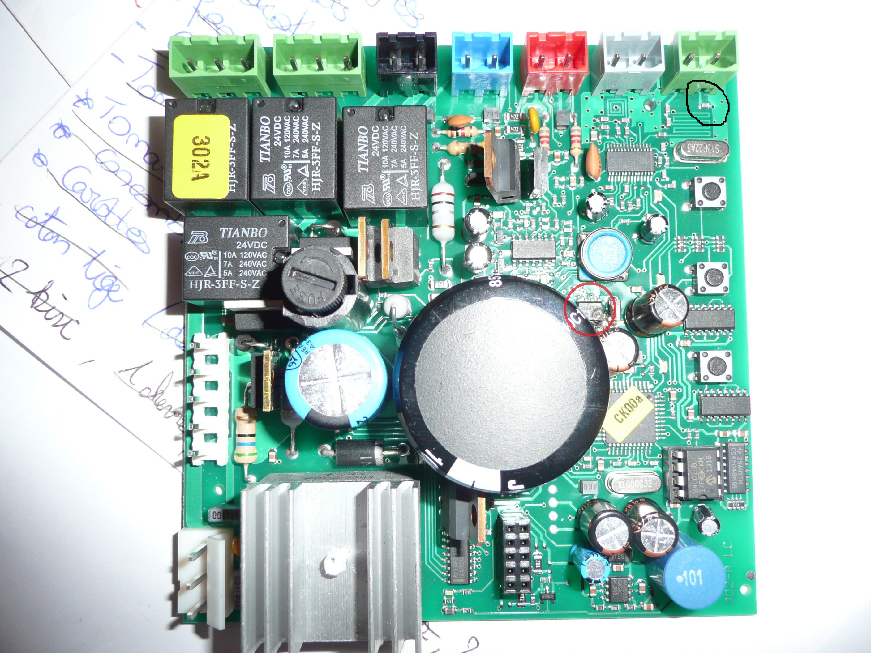

    #21 21085546
    ZgredekLCD
    Posts: 19
    Hey,
    I also have a problem with the controller, I would like to ask about a very basic thing, it is about the power connector of the board (marked in green), why are there 3 pins? The one marked in orange is ground, and the other two are from what? I understand as if there were two + / - pins, but what is the third one responsible for?
    It is also interesting that ~23V AC goes in there.
    Generally I have the problem that one side of the gate opens and the other does not (no voltage on the output connector), surely it is not the gate motor, because I swapped the connectors and then the other motor is activated.
    Controller board with highlighted power connector and components. .
    Protective?

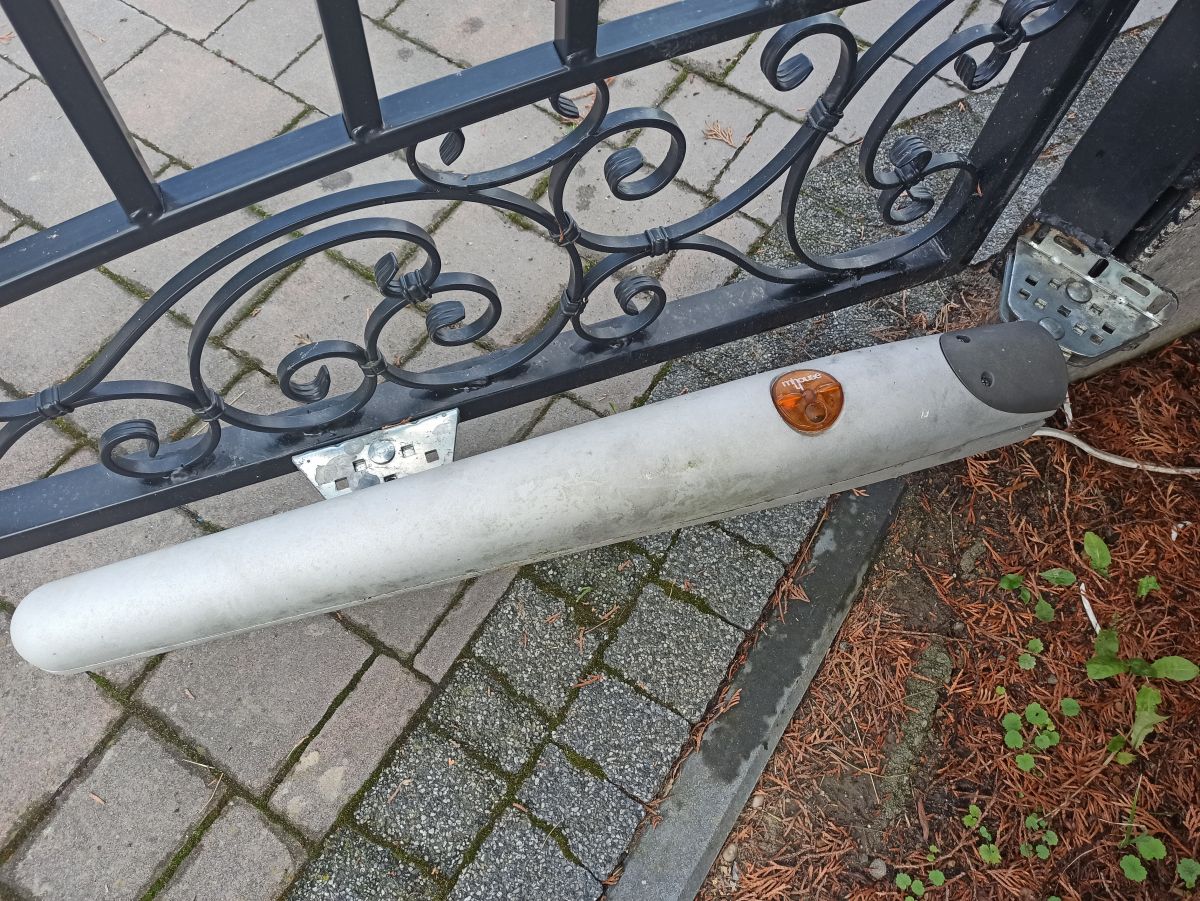

    Hello, have you found the reason why one leaf of the gate does not open ? I have the same problem, after replacing the TIP127, the inverter circuit and these 4 circuits fed from this inverter seemingly works but does not open one gate leaf ?
  • Poor cable joints and actuator friction can trigger obstruction detection
    #28 21888941
    ZgredekLCD
    Posts: 19
    In my case, the problem was indirectly related to the actuators; I had the cables extended and they were quite poorly "bolted" together - although I'm not sure if this was the reason. On the other hand, it certainly helped to oil the actuator (there was a lot of dirt on the guide), the gate itself and to do a re-trim. By default, this mechanism works by measuring the current flowing into the motor - if there is more resistance, it will treat this as an obstruction and stop opening.
