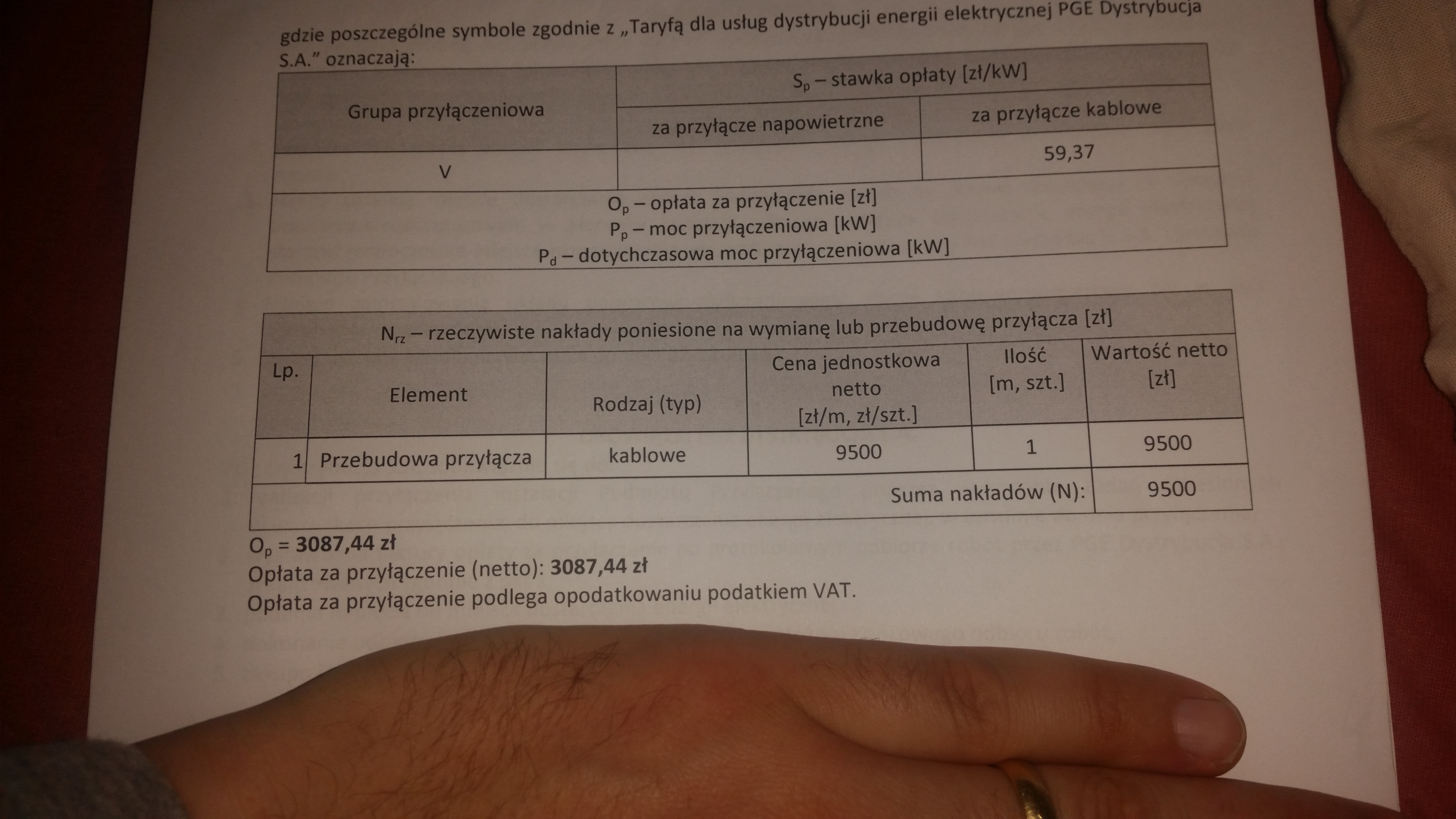

    I got new connection conditions for 3 phases from 1phase. The cost of connection in the ground is 3100 PLN net! What is the price? Box in the fence 3mb from the switching station. A neighbor for a new connection of 70mb to the house paid 800 zlotys for 11kw. Why should I pay so much?

    Terms of the first page. I applied for changing the connection from 1phase to 3 and raising power from 4 to 16kw. There is an overhead line and in the application I indicated that it has to be a cable in the fence. What should I do to make it cheaper? Conversations with the Lord with PGE always end with a quarrel because he does not want to help, they only advise with a fochem they ask what they want?
    Is the solution with liquidation of the overhead line ms sense? I understand that I will not have electricity for at least 6 months but the amount for me 3k is unacceptable. Maybe it is an option to put a mailbox, it will be cheaper?
    • Comparing Power Change Costs to 16kw at PGE: 3100 PLN for 3 Phases vs 800 Zlotys for 11kw 15134958223792098769757.jpg (4.79 MB) You must be logged in to download this attachment.
    • Comparing Power Change Costs to 16kw at PGE: 3100 PLN for 3 Phases vs 800 Zlotys for 11kw IMG_20171217_081836.jpg (1.26 MB) You must be logged in to download this attachment.

    Read, for example, for the general concept, https://kb.pl/porady/ile-kosztuje-przylacz-energetyczne-jakie-formalnosci-musisz-spelnic/ .A whether the neighbor paid or not we do not know, every such case is treated individually and depends on a lot of conditions. Eg Energy Company can build a new connection for free as part of the modernization of the line.
    I suspect that here is the whole problem, since you want cable, you have to cover the costs, but I can be wrong, I do not know PGE's customs.
    In Tauron there is no problem to build 200 m of lines in the price of the connection.

    There is no problem like a silent, the author wrote that "distributes" 3 meters from the fence, i.e. cable line. Real costs charged 9,500 zlotys, and this may include the replacement of a cable connection, maybe some cable in the network nn, and it is still unknown what .

    What is another is the increase in power and the related exchange of connections, and a new connection is something else. With a new connection, you pay only a flat rate for the ordered power, you pay for extra power when you increase the power and exchange the connection, and you participate in the cost of replacing the connection

    Anyway, I can not speed up the connections and maybe they will connect me for next winter! However, the price is unacceptable because the cable is 3800 PLN and the air is 2500 PLN.
