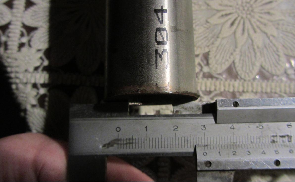

    I have 33.6 mm stainless steel outside and 30 mm inside - see below
    Then Slimyak would have a diameter of about 29.6-7 to be sliding.

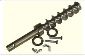

    I see that a colleague has never machined a stitch. Making such a screw is not difficult, but time-consuming, due to the large number of passes. In addition, the stainless steel rolls very badly. Making such a screw on order with the material I value at a minimum of PLN 200.
    Your stainless steel tube is the cheapest grade of stainless steel. In addition, it has an internal seam, which excludes cooperation with the snail. The pipe has a thin wall - threading is not an option.
    Check yourself on the goggles "wolf shaft", maybe you can buy cheap. Possibly, I can recommend Spomasz.

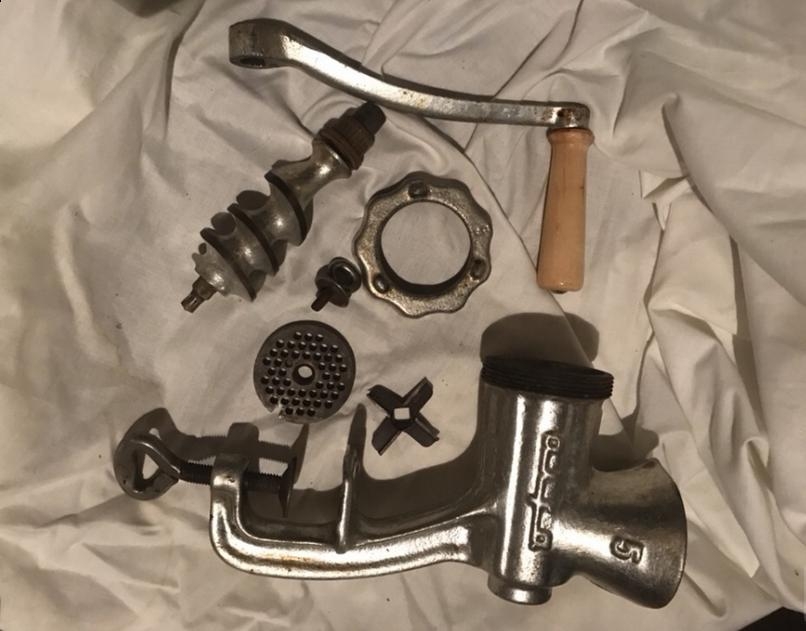

    You've probably given me a good idea with this meat roller - I will try to use a manual meat grinder.

    Generally speaking, you can, but it will be hard. Faster would be a knife, slight imperfection of the cone on the horse and could turn the drill.
    I think you could use the screw from the gear, but it will not be stainless anymore.

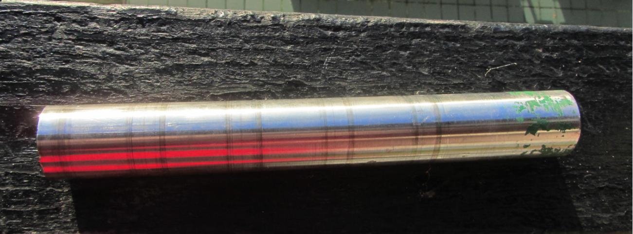

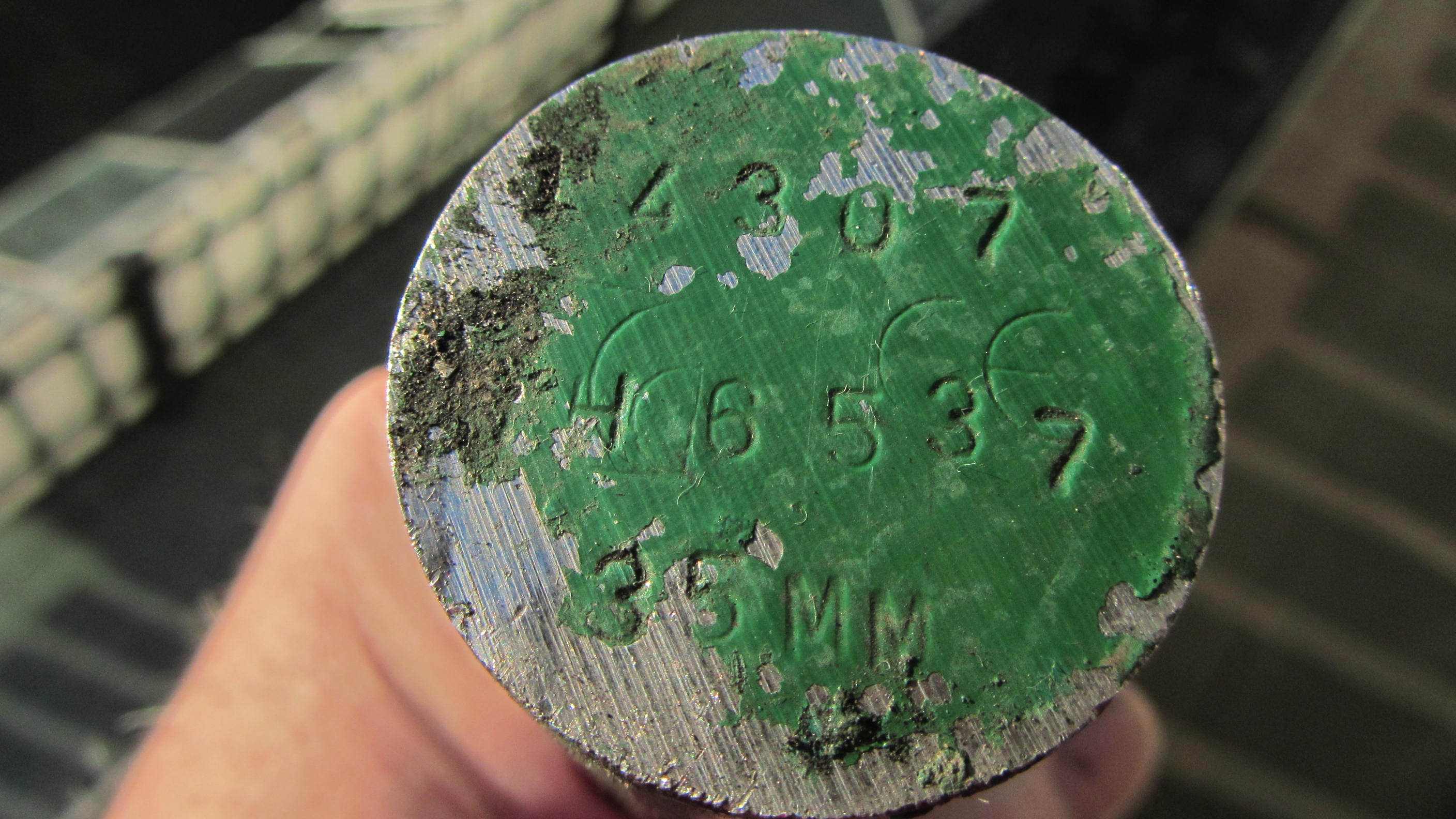

    I got a 35 mm roller on the scrap metal to be stainless l = 260
    The weight of almost 2 kg - 8 zlotys I paid.
    It will be fine.
    Cold Extrusion Domestic Squeezer: Slimak, Stainless Steel, Turner Tips, 250mm Length, 16-18mm Bolt
    High-alloy steel - chromium-nickel steel 1.4307,
