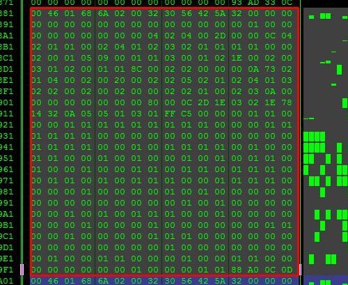

    it's complicated for a layman
    So far you have not understood what I am talking about, there is no point in dragging it - without any offense - nobody is born with it -
    this is about editing on binary files in the HEX view
    additionally there is knowledge and equipment for reading binary data (programmer)
    because you need to read the eeprom batch
    edit hex
    will calculate a checksum
    upload to eeprom
    check changes in DB in the scope of encoding etc .....
    As it is not known which cell in the batch the entry concerns, such operations can be performed from a few to a dozen or so ... several dozen
    Sometimes the encodings get related (not one to change)
    for example, the change to electric mirrors concerns two places in the load
    and both need to be tracked down and changed
    sometimes the change is not only from 00 to 01 but in coding there are often several possibilities (lines) it can be the HEX range --- omit - 00 and FF

    I have already written if bsi coding online (but without online) editing on a hex batch.
    Peugeot 208 - Installation of factory rear parking sensors and BSI coding
    this is an example of a programming area - you need to determine which cell you are talking about and change it accordingly.
    I will add that in different SW versions of flash for bsi the layout can be completely different
    e.g. in one hook it will be on cell 33 and in the other on 123
    I will tell you that if I had to do it, I would act on the principle of semi-exclusion.
    you change half, count the sum, you upload and check if the coding has changed, if you don't, you know that it is in the second half
    now you divide the half in half and do the same ... until you reach ...
    I will add from the programming periods there may be several in the batch
    and what is very important - to achieve the intended goal, the checksum must be correctly calculated
    otherwise - a configuration error

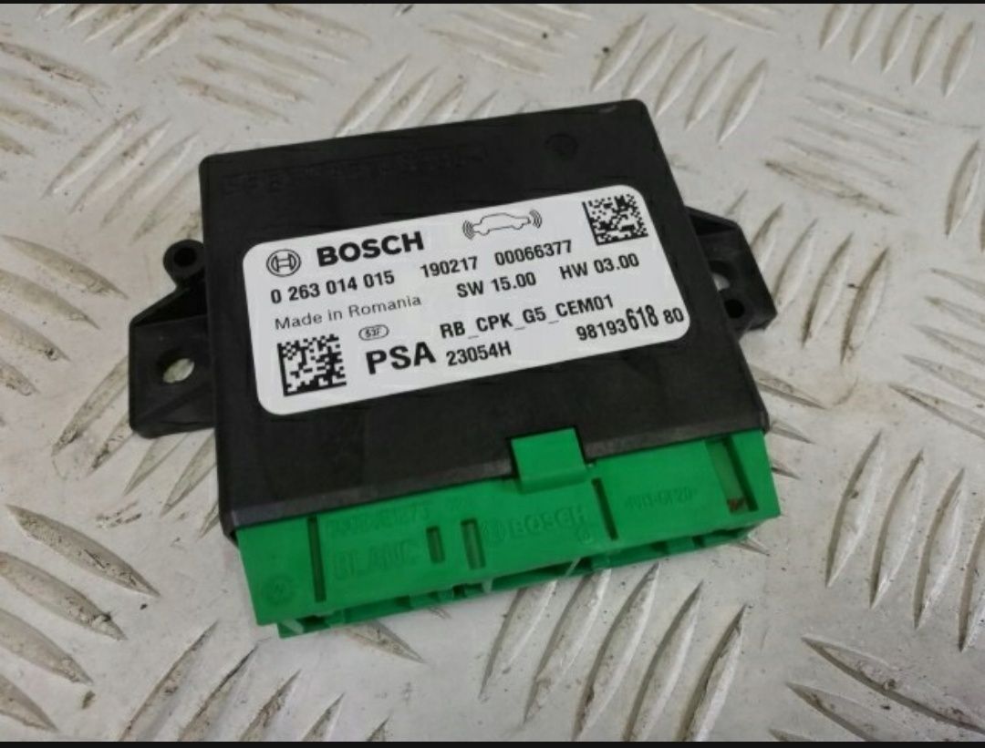

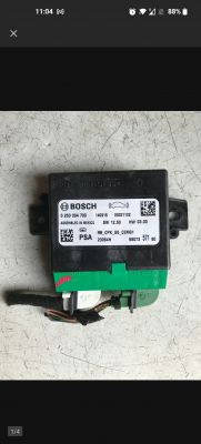

  • Need the correct PDC module and front bumper drilling
    #43 19841514
    Luq01
    Hello. I have a Peugeot 208 2015 facelift with a parktronic for the rear and I would also like to add it to the front. I have an original beam with sensors on the front, 4 baskets. I currently lack 2 baskets to mount front sensors and a PDC module. And now the question is what module should I choose? Will this one be right?
    Is it necessary to replace the front bumper shell? Can't "drill" yourself?
  • #44 19841596
    melas
    Posts: 1552
    Help: 138
    Rate: 689
    The module is for the front and rear as much as possible, the bumper is your creativity or a purchase for parks.
  • #45 19841672
    Luq01
    So I understand that the number of the module does not matter - as long as the drawing shows the front and back pages? Because on a popular website I found 2 PDC modules for 208 that differ in numbers and production. Is there any deeper difference between them? Peugeot 208 - Installation of factory rear parking sensors and BSI coding Peugeot 208 - Installation of factory rear parking sensors and BSI coding

    Problem solved. PSA sensors 9675202477 are required for the controller with the number 0263004465 with the software version 9.00
