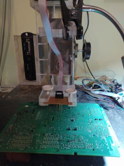

    And there is already a prototype needle plate for the BDM frame

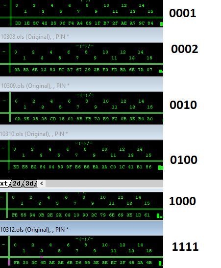

    Currently, I do not have the full knowledge of the PIN CODE algorithm
    below are examples of PIN in FL3 HWD5
    BSI DELPHI series EL HW D6 - TELECODING READING BSI peugeot 208 II corsa F
    To the administrator - I know that I wrote the same in two places, but I did it due to the different number of people watching the topic.
    After a dozen or so tests in several BSI DELPHI, the case looks like this:
    In the same BSI, whatever changes in the eeprom data - the immo code after entering e.g. 0001 is always the same coded.
    If the code 0001 is entered in another BSI model, this PIN is coded differently:
    So in different BSIs: EL3, EL4, FI, 3 FI5 ... code 0001 will be a different string.
    It is easy to conclude that either there is another algorithm ... or there is some variable in the algorithm ..... (it's not vin - I checked).

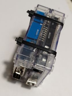

    Breadboards came in
    BSI DELPHI series EL HW D6 - TELECODING READING BSI peugeot 208 II corsa F BSI DELPHI series EL HW D6 - TELECODING READING BSI peugeot 208 II corsa F
    I upload the project on HW6 -

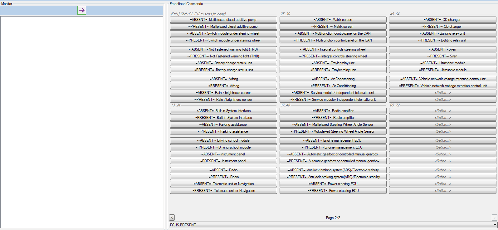

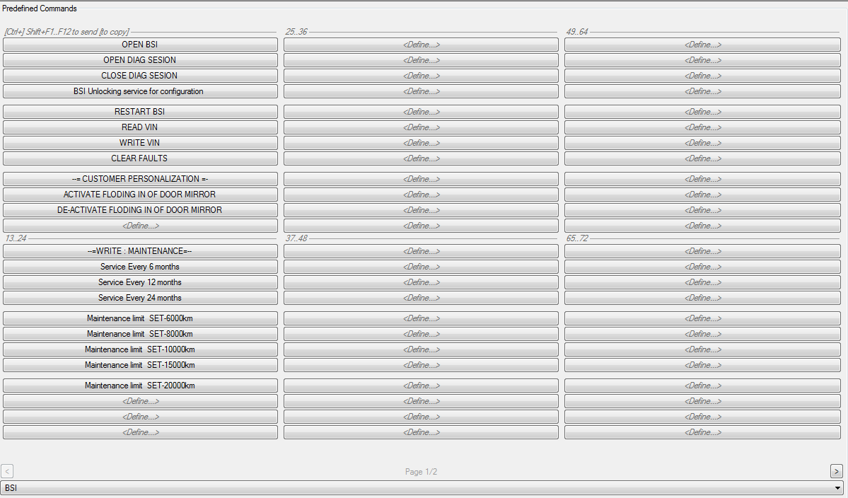

    NAC RCC Configuration Works Great
    You can rip the backup
    parameters can be changed
    menu functions
    add functions etc ...
    If you mix too much, you can always restore.

    works even more, just mapping BSI configuration :)
    • BSI DELPHI series EL HW D6 - TELECODING READING BSI peugeot 208 II corsa F Bsi.png (38.56 KB) You must be logged in to download this attachment.
    • BSI DELPHI series EL HW D6 - TELECODING READING BSI peugeot 208 II corsa F ecus present.png (66.16 KB) You must be logged in to download this attachment.

    I wrote that it maps, that is, I do :) it's not found, only one BSI has fallen, the other has a problem with backlighting (something fell) but I ordered a new one, because I do not want to unsolder
