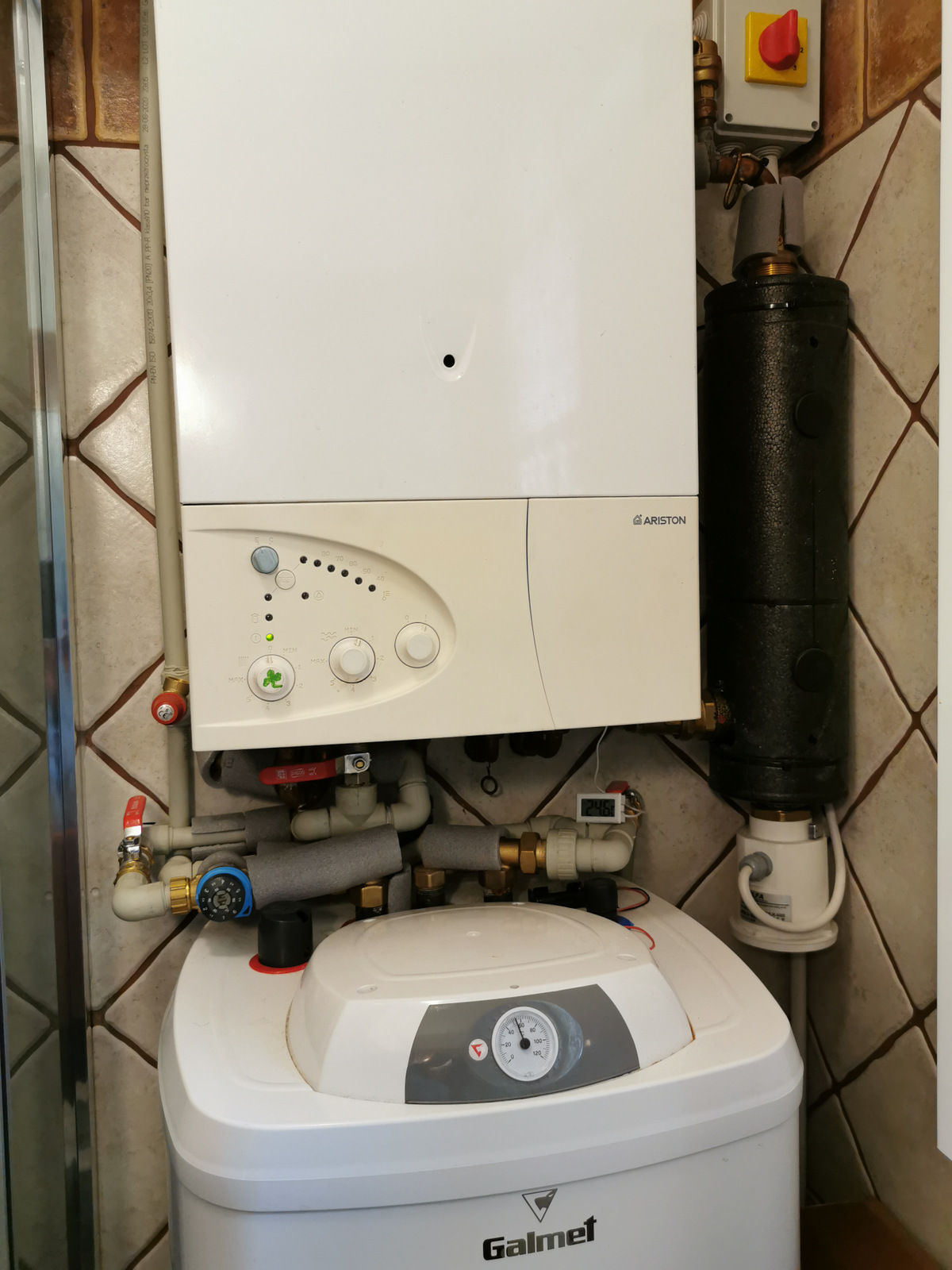

    I found http://www.elterm.pl/pl/produkty-elektryczny-...plywowy-ogrzewacz-instalacji-co-strzelec.html
    The Elterm ST heater (Strzelec) is the simplest solution that allows the construction of a hybrid boiler room based on traditional fuel (gas, coal, wood) and electricity obtained from photovoltaics.
    The device is connected to the heating circuit at the outlet of a traditional furnace in a boiler room.

    In my case, a gas boiler in the bathroom on the ground floor, so the "losses" go to heating this room, the boiler with a closed KS, i.e. losses to the chimney.
    I will try to what temperature outside this 6KW is enough for me, I will install the heater on the return, because if he can't do it, it will be supported by a gas boiler and a fireplace. The radiators are oversized and I heat no more than 45C.
    I assume that the electric heater will be able to reach -2C, and in severe frosts, I light the fireplace anyway.
    The Sagittarius heater will fit me on the right side of the stove.

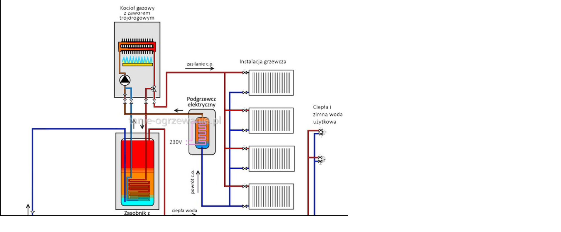

    If I had to play something like this on a low budget, I would:
    Thermostat> relay> heater in the hot utility water heater + hot utility water and central heating pumps

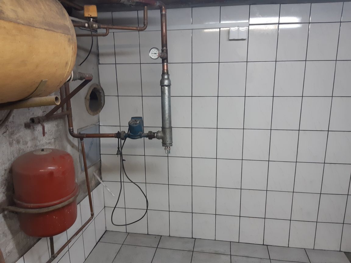

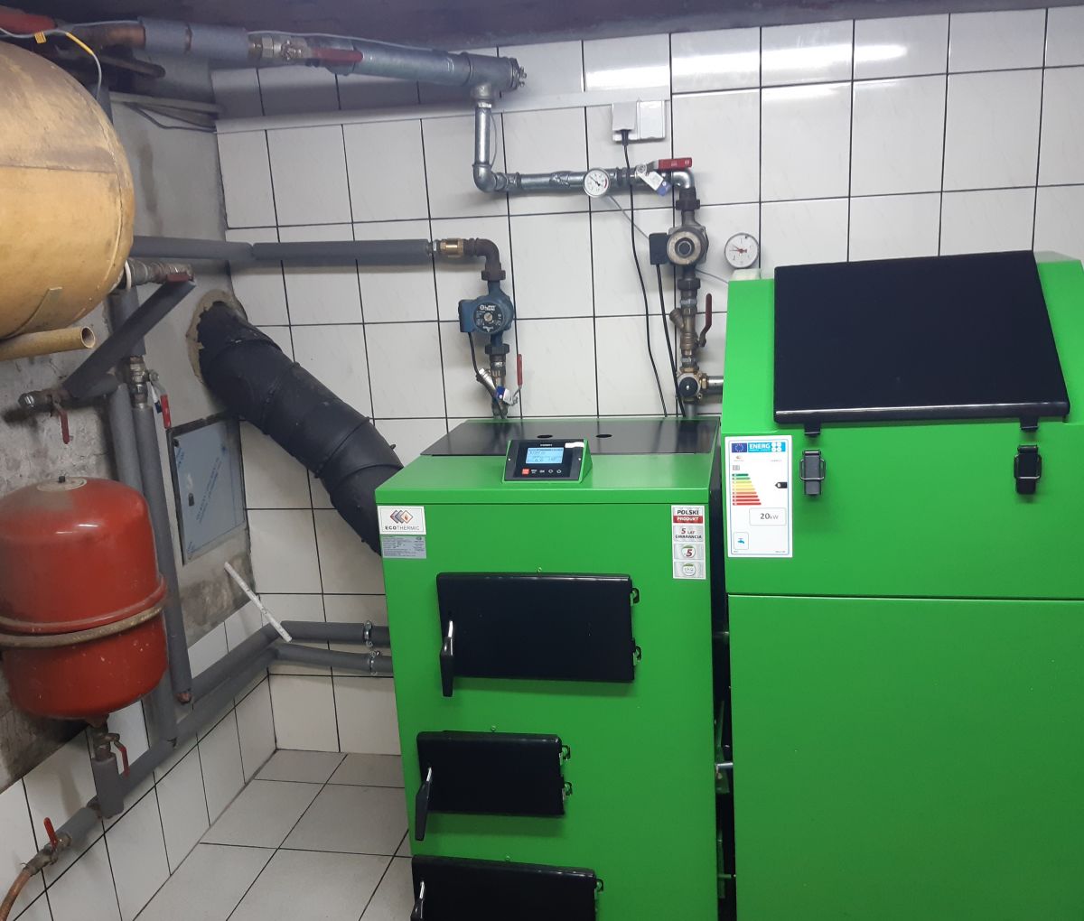

    In the fall of 2020, I was renovating the chimney (ceramic insert) and replacing the boiler with 5 eco. All this lasted (with the expectation of a new boiler) a month, when at the end of October the temperatures dropped to + 2 degrees - in order not to freeze quickly (5 hours with the purchase of details and venting the installation) I installed such a contraption:
    heater 3x 1.4kW
    pipe 5/4 "
    reductions
    pump
    Electric Instantaneous Water Heater for Central Heating: Anti-Freeze Solution for CO Circuit
    It was connected with the "quick and short" method to the 3f power supply to distribute the load - it worked :)
    To obtain a temperature of 22 degrees at home, it was necessary to turn on two heaters and they had to work practically 18 hours / 24 to maintain this temperature.
    During the assembly of the boiler, this "invention" was installed on the power supply to the installation - we will see how much electricity will be left after the summer, it will be used in the fall
    with such data, we have 50kWh of consumption per day - 1500kWh per month, it is about PLN 933 a month :( - unless we have some "own" electricity
    but to heat only with electricity in this way, we have a little, counting 6 months at 1500 = 9000kWh plus you would have to take 2-3 thousand more for the situation when the temperature drops below zero and you will have to turn on the third heater - i.e. 10kW on the roof is not enough :(

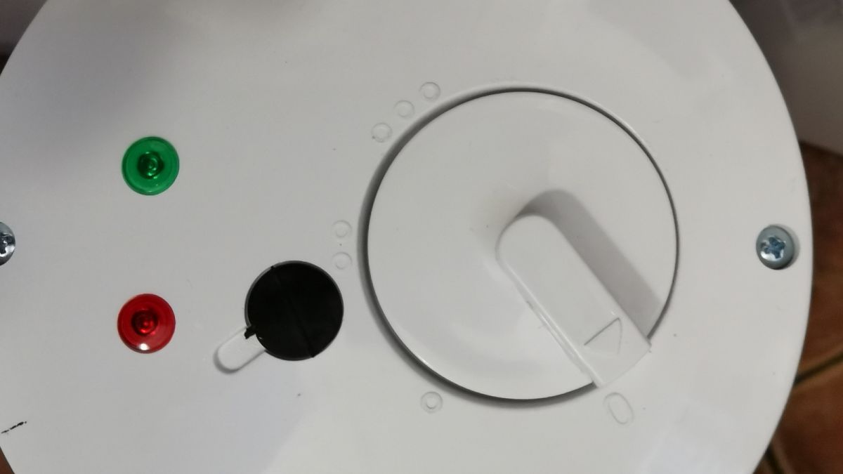

    Electric Instantaneous Water Heater for Central Heating: Anti-Freeze Solution for CO CircuitIMG_202105...112918.jpg (391.02 kB)You must be logged in to download this attachment.
    For me it worked without any problems all winter, I added the possibility to turn on each phase separately, with -5C outside the heater 2kW (only 1 phase is on) keeps the radiators at 45C.
    Conclusion, I could only heat my house with electricity from a 6kw heater

    It's great that I found this topic, because I'm just thinking about installing a CO additional heater on the return from the installation. I am targeting the 2-3kW, single-phase version, because this is the only electricity I have with a gas CO furnace
    The additional heater would use the excess electricity from PV, there will be some 700kWh to be utilized. I called Termet (producer) but they can't really tell me how many degrees such an additional heater can raise the water temperature. The documentation on their site is less than poor. I heat with low temperature, currently 38 degrees. This goes to the heaters on the first floor and the floor heating on the ground floor.
    However, I think that 700kWh is not a lot and if I connect a 3kW auxiliary heater, it will "pull" it out of the network in about 10 days.
    Theoretically, you can even determine how it will affect your gas bill. If last year I used 5160kWh of gas from 2.12 to 3.02 (from the bill), then taking into account the cost of the variable network fee of 1kWh of gas, it cost me PLN 0.1616. These 700kWh are worth about PLN 113. Not much, but gas prices are rising and I have a surplus of electricity.
    Looking at these numbers, the cost of installing such an additional heater will pay off in a few nice years (if the heaters last). Of course, the change in gas prices will affect this, but it should not be expected that the return will be faster than 5 years (cost of purchase + installation). In conclusion: on average it pays off with such a surplus. You can think about adding panels, but it only worsens the balance, because gas is still relatively cheap. But in the long run, who knows what it will be like?
