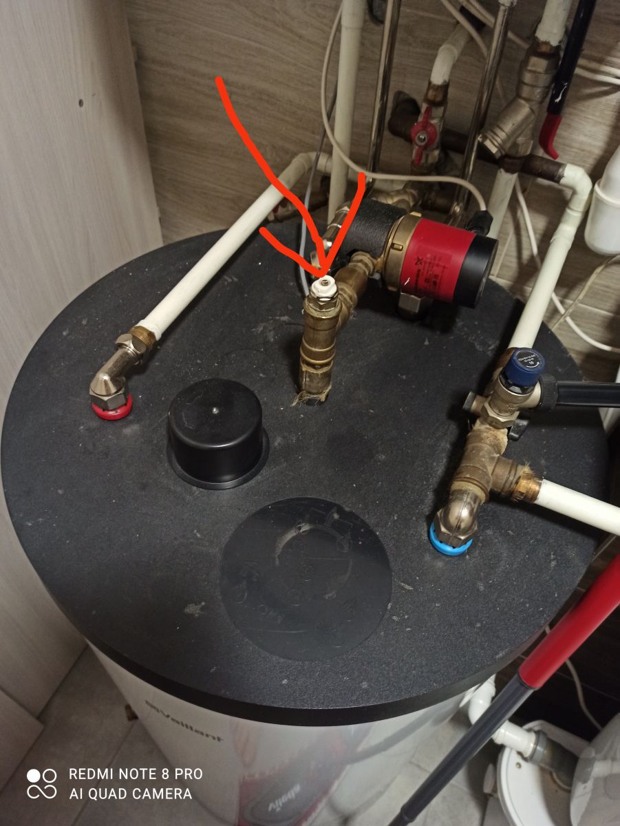

    Hello. I want to install an electric heater to the Vaillant vih r 150/6 B tank. Theoretically, there is no such option. But apparently you can put it in place of the water drain. Has anyone practiced this?

    Well done YOU :D how to mount the heater in the place of the water drain, which is 1/2 "
    The only place where the heater could be mounted is where the magnesium anode is screwed in, but I do not advise removing the anode.

    You can install a 1/2" heater with a tee, such as a radiator heater, max power 600W. You screw the drain valve into the tee. You can do it even without draining the water.

    In fact, there is a 1/2 anode thread, I would not like to remove it, but there is one more place where it could be mounted. I mark the arrow. What do you think? Installation of an electric heater in the Vaillant vih r 150/6 B storage tank [img-0]

    All spigots from above are a bad idea. The one marked for DHW circulation, as well as for ZW and DHW, have plastic inserts installed inside - such tubes that direct water to the right place in the tank:
    ZW - is the longest and reaches the bottom of the tank
    DHW - is the shortest because it has to collect water from the top of the tank
    circulation - is of medium length because it is to direct the returning HUW more or less in the middle.
    If you mount the heater there somehow, it will be wrapped in a tube - it will have a cover that will prevent proper heat dissipation.
    The most correct mounting location is the drain from the tank - only I have never dismantled this valve and I do not know what the thread is there.

    The heater at the top will heat only 10% of the tank volume and the thermostat will turn it off. Therefore, the heaters are mounted halfway down the tank.

    Yes, there is 1/2. Only the length of the heater through the coils limits me. The question is what is the maximum length

    Cross-sections of this reservoir are available online. They show that the coil extends to the drain hole. So in my opinion, either no heater will enter, because it will immediately catch on the coil, or practically every heater will enter if it "hit" the gaps between the coils

    I asked the manufacturer of heaters about the possibility of using an electric heater - for a bathroom radiator - with a 1/2" thread, because such a thread is in place of the drain valve in Vaillant tanks and this is the answer I got:
    "The heaters are made of copper covered with a nickel coating, while
    tanks made of ordinary enamelled steel - no in terms of material
    has a problem with electrocorrosion and work in tap water.
    We suggest using a 1500W heater for 120l tanks,
    and 2000W for 150l and 200l tanks.
    The elements have thermostats with an adjustment range of 10-65 degrees Celsius, both
    also have immersion length (thread + heating element)
    520mm."
    1500W
    2000W
    I will just ask what if the heating element touches the coil in the tank - will there be a "corrosion point"?
    I am not sure if there is free space for the heater in these tanks, will the coil collide?
    "As a rule, we do not recommend the use of heaters in the event of a collision with the coil.
    At metal/metal contact, the heat dissipation occurs in a different way, which can lead to uneven heating of the heating element. In addition, each time there are so-called stray currents which may negatively affect the heating elements/tank. Contact to the coil would close the circuit, which could lead to faster operation. In such cases, the heating element on the thread should be insulated with insulating material."
    They go in length, but I don't know if they will touch the coil.
    It was also good to use a tee as for heaters for bathroom radiators and mount the heater through the hole, and the drain valve back on the outlet.
    I haven't done it myself, but I'll give it a try when I get the chance.

    Dora message - the heater went in without a problem.
    I turned the drain valve. Together with the heater there was a tee for assembly so I could screw the drain valve back into the side branch of the tee. Only between the muff in the tank and the tee I gave a short 1/2 "extension so that there was easy access to the drain valve. I had to tune the extension - drill its hole because it had a "hexagonal hole" and the heater did not enter it. The heater did nothing. Satisfied customer.
    I carried out the operation on a 120L tank + 2kW heater.
