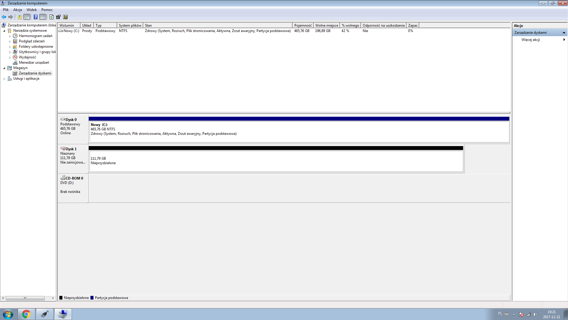

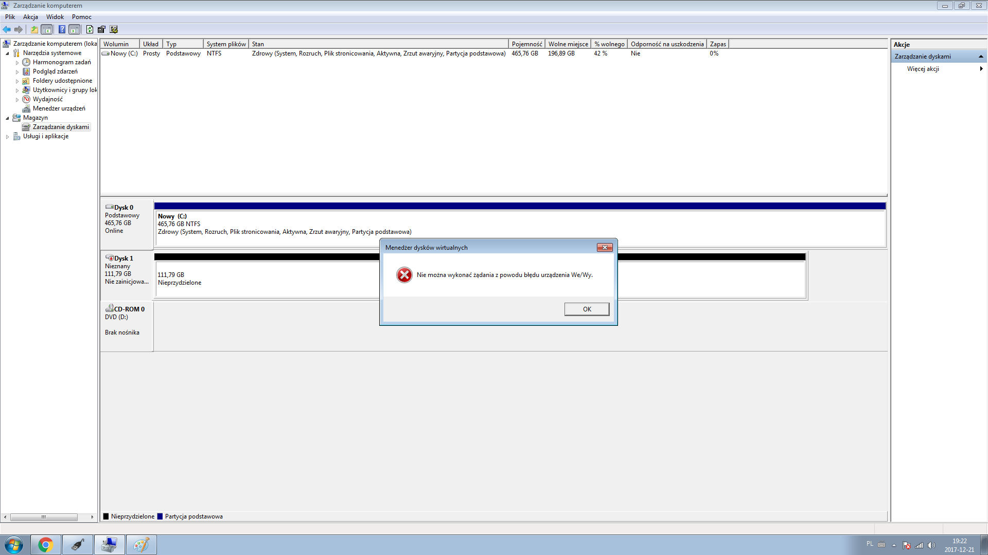

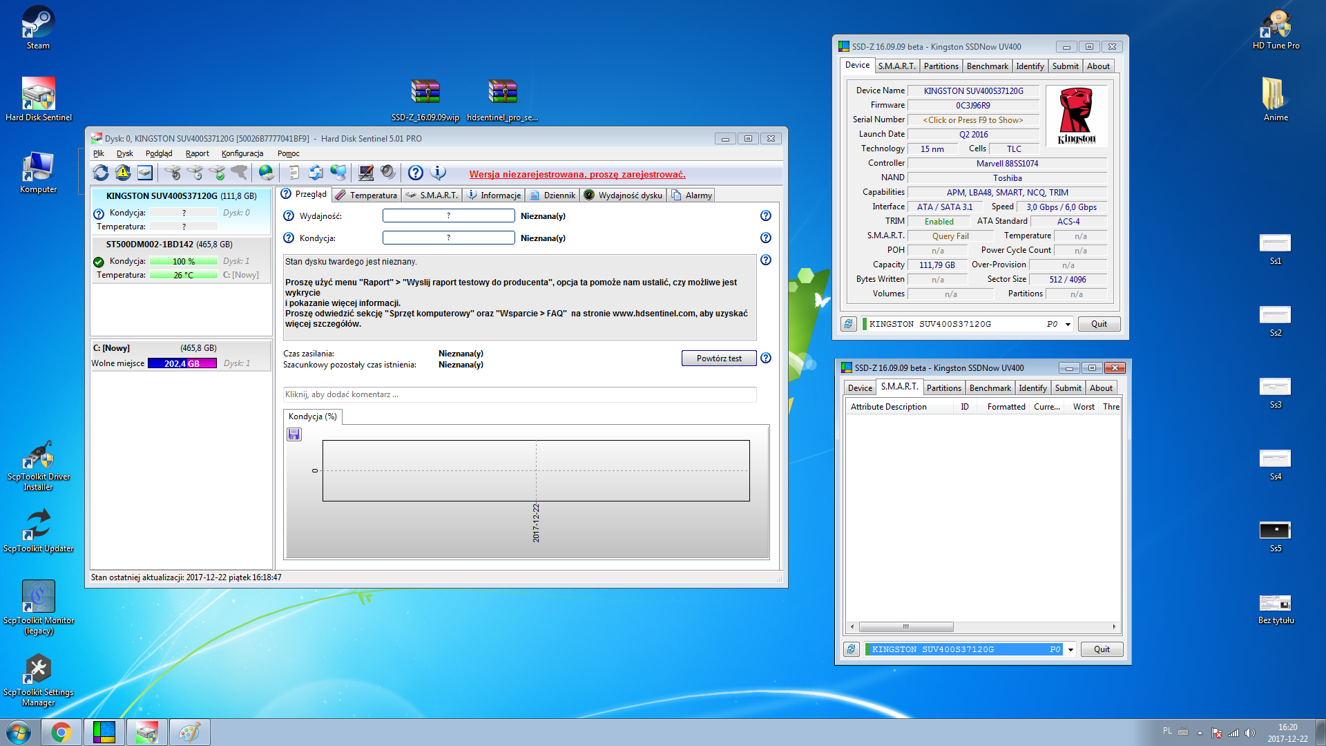

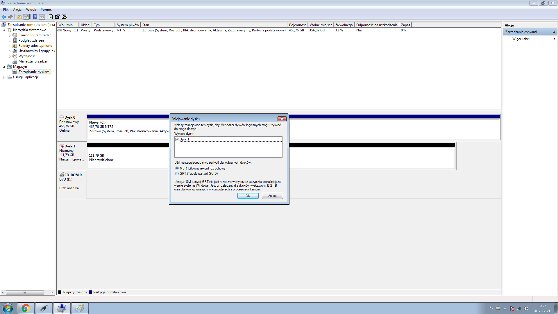

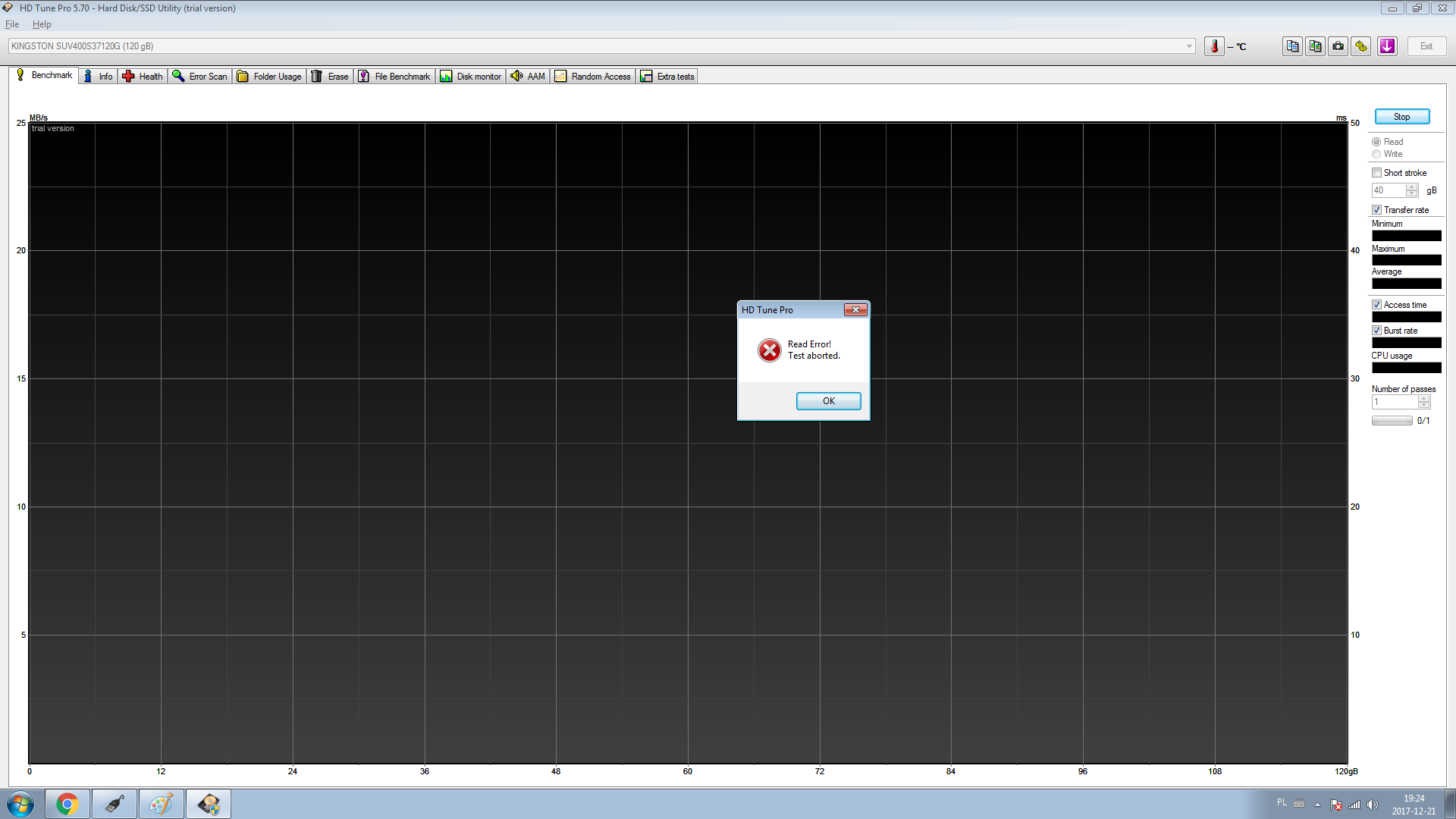

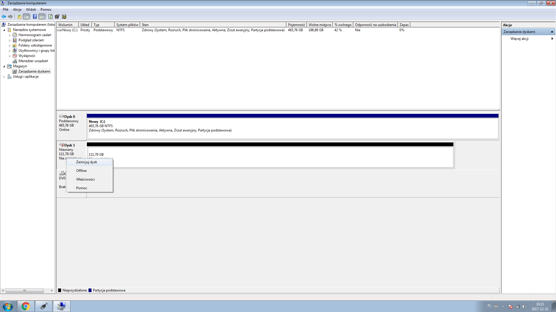

    As in the topic - SSD cannot be initialized. Recently, I gave the SSD drive for replacement, because it broke down and I had it under warranty. Of course, after 3 weeks of waiting .. they gave me a new disc, packed, all great. I plug in and nothing. I tried resetting the BIOS, switching to different SATA inputs and still nothing. I am asking for help, because I do not want to give it back again, not being sure that I am not doing something wrong. In addition, I will add that it is impossible to test it in HD Tune at all (I will show everything on the attached screenshots). Windows detects it and determines its status as good, but that's just that, nothing else can be done with it. I am asking for help, I have been struggling with him for two days and I really don't know what to do anymore.
    •  SSD Failed to Initialize: New Drive, BIOS Reset, SATA Switch, Warranty Replacement Ss5.png (106.46 KB) You must be logged in to download this attachment.
    •  SSD Failed to Initialize: New Drive, BIOS Reset, SATA Switch, Warranty Replacement Ss4.png (107.89 KB) You must be logged in to download this attachment.
    •  SSD Failed to Initialize: New Drive, BIOS Reset, SATA Switch, Warranty Replacement Ss3.png (115.02 KB) You must be logged in to download this attachment.
    •  SSD Failed to Initialize: New Drive, BIOS Reset, SATA Switch, Warranty Replacement Ss2.png (98.61 KB) You must be logged in to download this attachment.
    •  SSD Failed to Initialize: New Drive, BIOS Reset, SATA Switch, Warranty Replacement Ss1.png (97.2 KB) You must be logged in to download this attachment.
  • #3 16907181
    NekiKagari

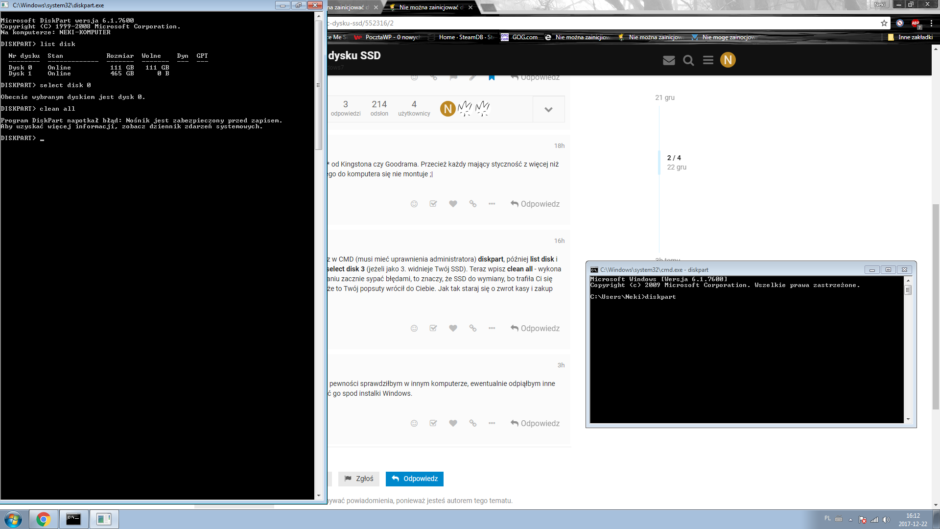

    Robert, here are the screenshots, but the drive is not responding to any of these applications, additionally I gave the cmd list when trying to clean the disk.
    •  SSD Failed to Initialize: New Drive, BIOS Reset, SATA Switch, Warranty Replacement ngbgnvm.png (998.56 KB) You must be logged in to download this attachment.
    •  SSD Failed to Initialize: New Drive, BIOS Reset, SATA Switch, Warranty Replacement uyjvtyt.png (189.94 KB) You must be logged in to download this attachment.

    What immediately "catches the eye":

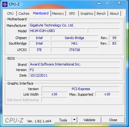

    To which motherboard this SSD is connected, enter the model and BIOS version.
    GParted run ( check also after connecting to other equipment ) and see if there will still be write protection on this SSD. :idea:

    Please pidar, here is the BIOS version and motherboard model. Unfortunately, I currently cannot connect the drive to other equipment.
    •  SSD Failed to Initialize: New Drive, BIOS Reset, SATA Switch, Warranty Replacement Tak.png (42.56 KB) You must be logged in to download this attachment.

    If you don't hook up to another one, it's hard to judge something here, a rather strange case.
    As if the disk was encrypted or somehow?
    He sees it, but you have the write-read lock?
