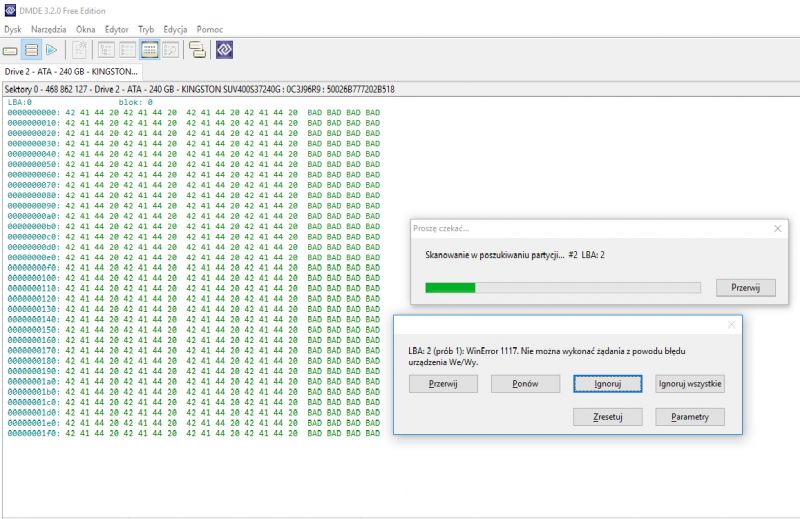

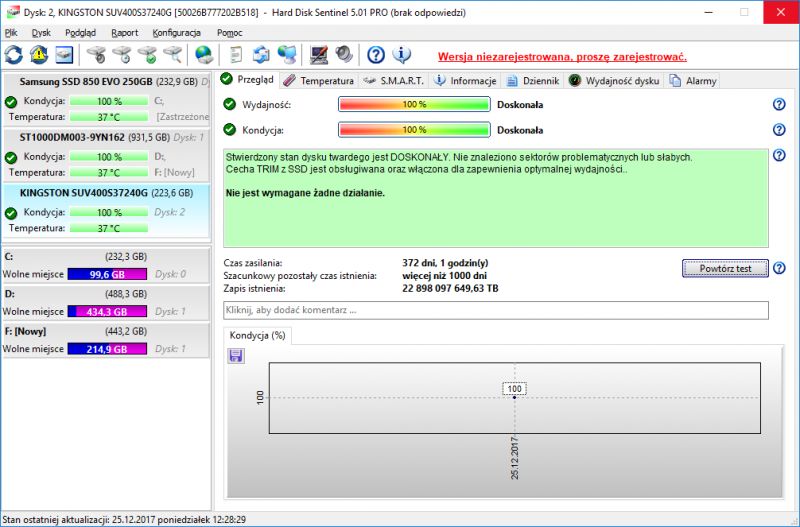

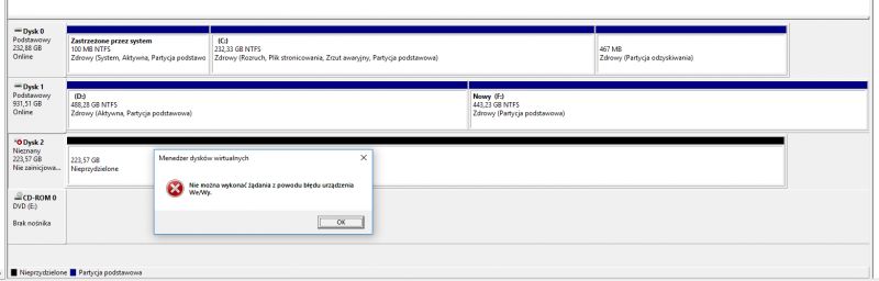

    I purchased an SSD a week ago. It started up and walked no problem until now. Yesterday some error popped up during work (unfortunately I didn't note it). System overhang. I waited a long time but nothing happened so I did a computer reset. After the reset, it takes a long time to start the computer and since then win10 has no access to the disk.
    - BIOS can see the drive
    - Disk Management (Control Panel) can see the disk but cannot initialize.
    - The disk cannot be accessed
    I am asking for a hint what could have happened. The disk is under warranty, try to fix it or send it under warranty? I don't care about disk data.
    Below are some screenshots from different applications.
    What more can I do?

    Check in another PC / other SATA socket / 100% working signal cable. If it is the same - for a guarantee.

    I checked the cable on the CD and the same. On the cable to which this disk was connected, the usual hdd is now going and it's ok.
    I plugged the disk into such a portable pocket and the laptop does not see this disk.
    To fly under guarantees or still try to put into another stationary?

    I do not see any sense.
    The store will do exactly this:
    and if they are sensible traders, they will replace it with a new, working device.

    If you do not have data to recover there, you do not repair anything, only return it under the warranty.
