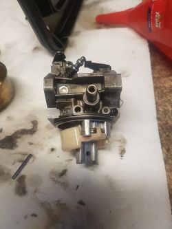

    Hello, it looks like this. I replaced the piston, rings, connecting rod. I put everything together properly, tightened it with proper forces, flooded with oil and here there was a problem when firing. When firing it surprised for a moment, then from the air filter began to spew fuel. After unscrewing the candle from the chamber it just poured. Carburetor during refurbishment I did not disassemble and did not turn anything on it, although I admit that it once caused problems and often at a standstill between mowing, as I forgot to turn off the tap, he was able to pour all the fuel from the tank into the oil. Now, from the carburetor and the chamber, the fuel gushes well. What could be the reason for this situation. Carburetor disassembled, uploading pics. I am also asking for instructions on how to regulate this system, because I used to shoot it a bit, but it did not work.
    Yes, I think maybe how I turned / rotated the engine during the renovation, maybe the float hung? B&S 12.5 HP Engine: Piston Ring Replacement, Scratches on Piston Surface - Is it Suitable? B&S 12.5 HP Engine: Piston Ring Replacement, Scratches on Piston Surface - Is it Suitable?

    kamilkawka wrote:
    although I admit that once it caused problems and often at a standstill between mowing, when I forgot to turn off the tap, he was able to pour all the fuel from the tank into the oil
    In this case and with such symptoms (it is not so much about "turning" but about the fact that it is "pouring" when the tap is open) it is the basis to check if the float and valve are tight and if the correct level of fuel is maintained in the carburetor.

    Don't be afraid of the carburetor, you have a lot of information on the subject on the internet. Disassemble and check that there is no gasoline in the float and if there is a valve closing the fuel supply when the carburetor has the correct fuel level.

    Okay, gentlemen, I cleaned the gas newspaper thoroughly, put it together and everything is OK, there is probably something stuck. The topic can be considered completed.
