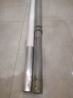

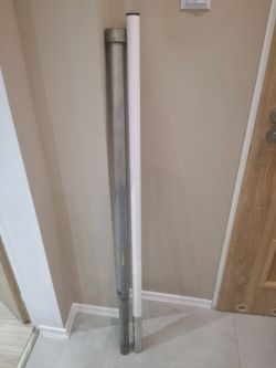

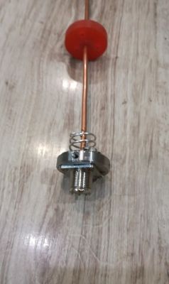

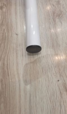

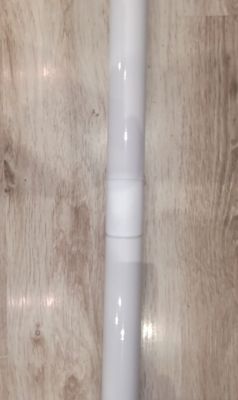

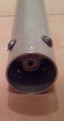

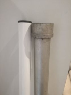

    I decided not to think twice. I went and bought a 40x1.5 pipe and I gave it to both elements. The only thing missing is a coil, a disk for the socket and some invention to center the radiator.
    Radmor 32812/1 Clone: Aluminum vs Steel Tube, Dimensions & Wall Thickness ImportanceDSC00737 (...edium).JPG (70.01 kB)You must be logged in to download this attachment.
    Radmor 32812/1 Clone: Aluminum vs Steel Tube, Dimensions & Wall Thickness ImportanceDSC00735 (...edium).JPG (131.91 kB)You must be logged in to download this attachment.
    The cost of what in the pictures is about PLN 50 including an external PVC pipe that is also waiting. Missing items will not exceed PLN 10, but I have to look for what to figure out for this disc, because in the local store the bars only sell in 4 m sections. It is 3.92m too much. :D
    As for the antenna itself - are you able to point another antenna on VHF with such SWR in such a band? Honestly, I've been looking for a long time. J-ka on the 2m amateur band in the 160MHz band has SWR over 2. So under 174MHz it will probably be deaf. Probably even the usual GP1 / 4 is not so broadband - but unfortunately I could not find a graph showing its SWR anywhere in the entire range of 144-174MHz. So much theory. And in practice - the antenna is highly praised by users. I even met with many opinions that it is better than Discone.

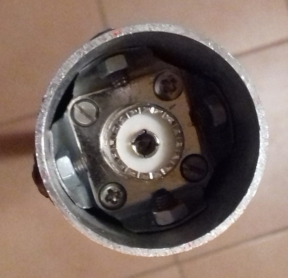

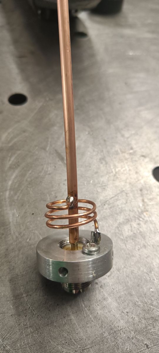

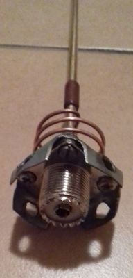

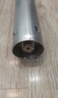

    Radmor 32812/1 Clone: Aluminum vs Steel Tube, Dimensions & Wall Thickness Importance Radmor 32812/1 Clone: Aluminum vs Steel Tube, Dimensions & Wall Thickness Importance Radmor 32812/1 Clone: Aluminum vs Steel Tube, Dimensions & Wall Thickness Importance Radmor 32812/1 Clone: Aluminum vs Steel Tube, Dimensions & Wall Thickness Importance Radmor 32812/1 Clone: Aluminum vs Steel Tube, Dimensions & Wall Thickness Importance
    There will be no aluminum disc. On the UC-1 socket I put two metal strips (the remnant of the chimney clamp attachment) crosswise and refined with a grinder.
    It would be nice to check it now on some professional analyzer, but I do not have access to such things.
    From the initial measurements of reception, the signal in SDR Sharp is 5-7dB stronger than from the classic half-wave dipole on the roof (the stick is in the room for now).
    As I mentioned before, the cost of the whole closed at PLN 60.

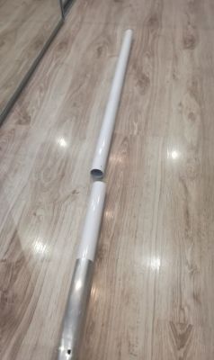

    The usual copper washers that suited my trash collection the most, because I couldn't drill these 4 holes perfectly and I had to match them with a file, which made them a bit too big.
    I think that this fastening of the socket is enough for now. In the end I tried to copy everything except the famous long-term durability. :D
    And finally I checked the antenna outside, at the same height above ground level as my previous classic dipole. The results are:
    Local 145.650 MHz drive:
    - dipole -18dB
    - baton -18dB
    Local 145.7625 MHz drive:
    - -15dB dipole
    - club -3dB
    Local base at 172 MHz:
    - dipole -20dB
    - club -6dB
    Local drive 439.200 MHz:
    - dipole -20dB
    - club -16dB
    Generally you can see a big improvement, except for one inverter at 145.650 MHz - its the same way. Interesting...

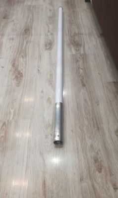

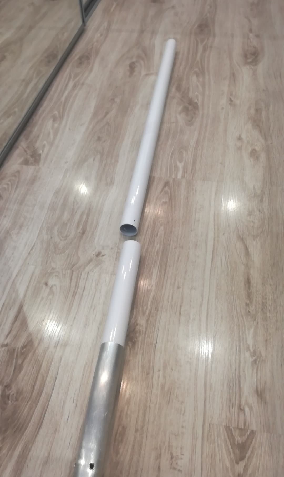

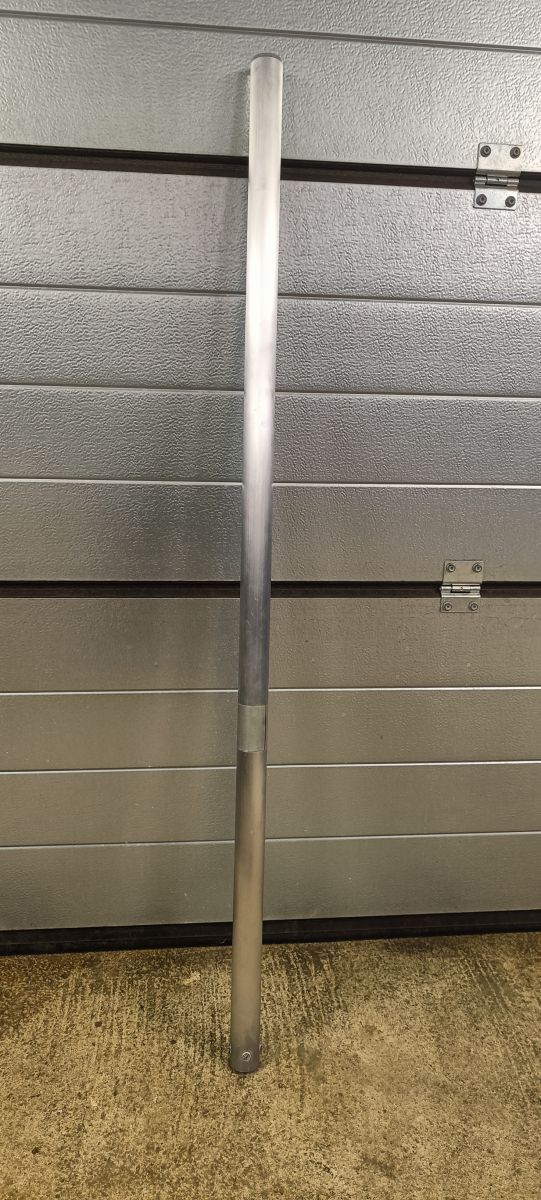

    Complete antenna exposed for testing outside:
    Radmor 32812/1 Clone: Aluminum vs Steel Tube, Dimensions & Wall Thickness Importancepała-st...jpg (96.77 kB)You must be logged in to download this attachment.
    To sum up the topic - it is possible to build a cheap clone of this antenna. However, the measurement of the resulting structure remains the biggest problem. If I manage to do it someday, I will definitely put the results here.

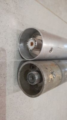

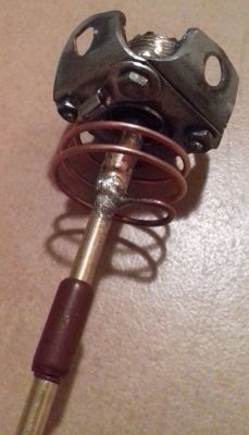

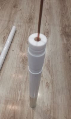

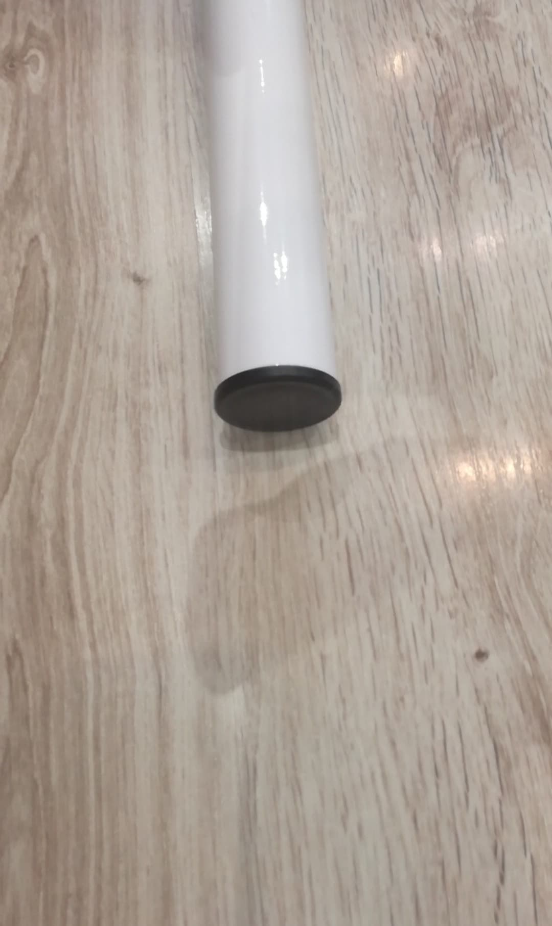

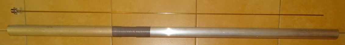

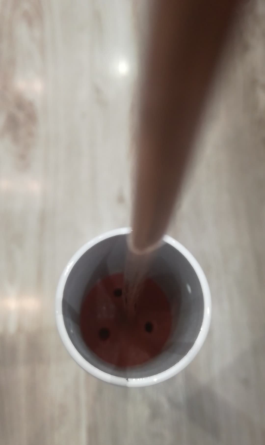

    Hello, I also decided to build a Radmor stick, photos of my performance, best regards

    Very nice and refined workmanship! Will you write a few words about the aluminum disc, the plastic connecting the two pipes and the red radiator stabilizers?
  • #14 17648865
    hetman bielawa
    Posts: 8
    The uc1 socket disk is made of stainless steel, while the insulator is made of polyamide and the spacers are made of rubber ;) The antenna has been powder coated so as not to use a PVC pipe

    This stick is made for the 158MHz band and tuning took place on the extension of the upper aluminum tube.

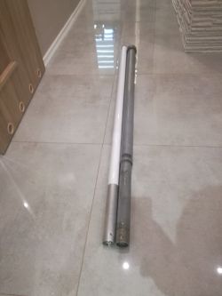

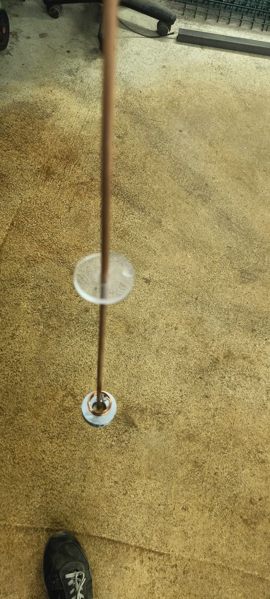

    Gentlemen, I made my own clone according to the attached instructions, I think I did everything correctly, but it turns out that the reception is worse than the antenna mounted on the radio, what could be the problem?, I am providing a photo for your reference.
    Photo of a handmade antenna with a coil and copper rod. DIY antenna mounted on the floor. Long metal pipe standing upright in front of a gray garage door.
