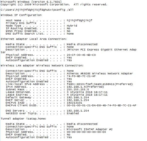

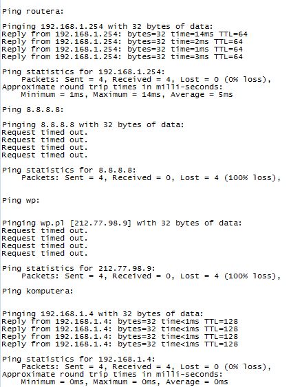

    Give in the form of screenshots:
    ipconfig / all
    ping PC
    router ping
    ping 8.8.8.8
    ping wp.pl
    It looks like there is a problem with the gateway / routing on the PC

  • #12 16933183
    Hawkeye_183
    Posts: 7
    ipconfig / all
    ping PC
    router ping
    ping 8.8.8.8
    ping wp.pl
    pings:
    WiFi Issue: Too Long Server Wait Time, IPv4 and IPv6 No Connection - Atheros AR9285, Netia Internet

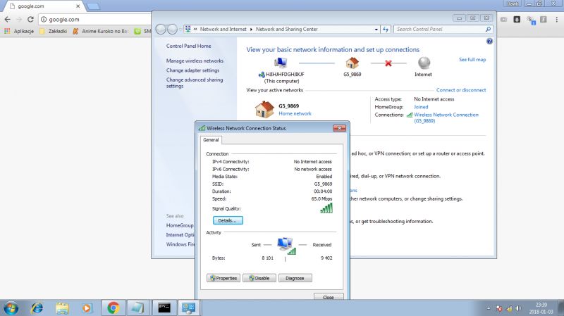

  • #14 16934441
    Hawkeye_183
    Posts: 7
    As I tried to connect after tethering from the phone on cellular data, I had the same lack of net, which is probably a problem with the wifi card
    Screen with wifi tethering
