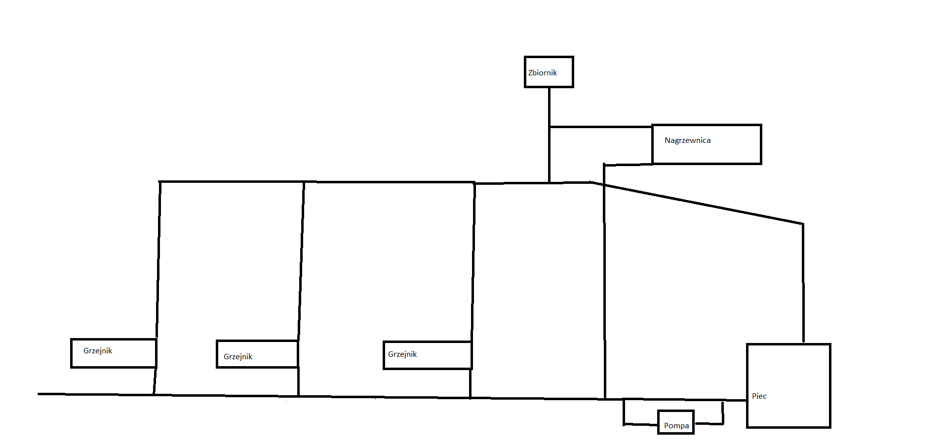

    Hi
    I have 3 heaters installed in the workshop as shown.
    Radiators without a running pump heat so that they cannot be touched.
    I bought a heater and noticed that the power supply is at the bottom and the return is at the top, i.e. the opposite of that on radiators, at least the mark is on the heater.
    And now the question is how to connect it so that it is good? just like radiators? or as it is marked i.e. return top of the heater power down? Water Heater Connection: How to Correctly Connect Workshop Heaters with Opposite Inlets/Outlets
    If so marked in the factory, then connect it.

    hello, buddy, connect as it is marked, i.e. power from the bottom and return at the top, but remember that you need to feed with the diameter of the heater, because if you give a smaller one, it will be a lime. It can also turn out that the temperature given as on radiators it will be too small, then you have to do it at a separate pump and a higher temperature. best regards.

    Connection from below.
    Forced circulation.

    Gentlemen ..
    Power supply from below.
    Pipes from the furnace connected 1.5 m 1 inch steel, then to the heater itself copper pipe fi 28 and with the heater itself reduced to fi 22 because it is in the heater.
    Effect? The oven temperature 50 degrees and the blower in 3rd gear blows with warm air :)
    They scared me after buying that the stove could not do it and I would have to keep the temperature 80 degrees and it is not known if it will not blow cold.
    There is nothing to save on the material because it will do more harm as good.
    Thanks for the hints
