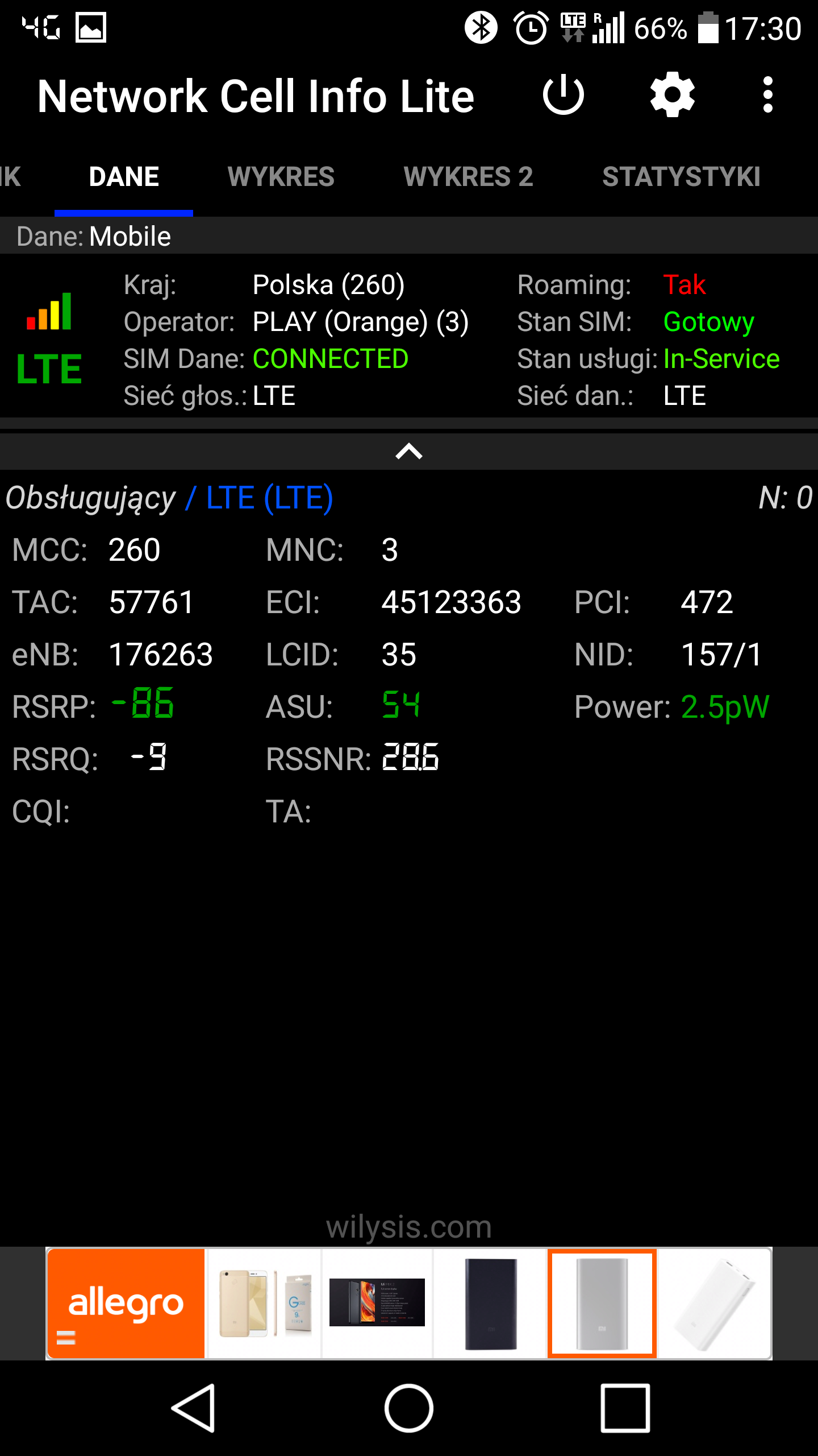

    17.30 is Wilenska Street,

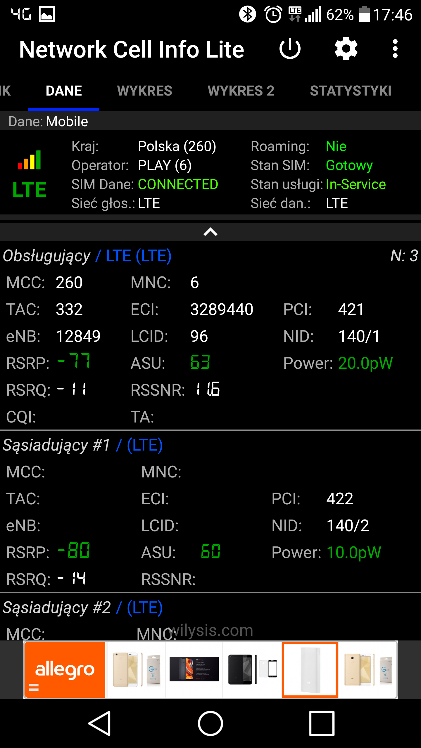

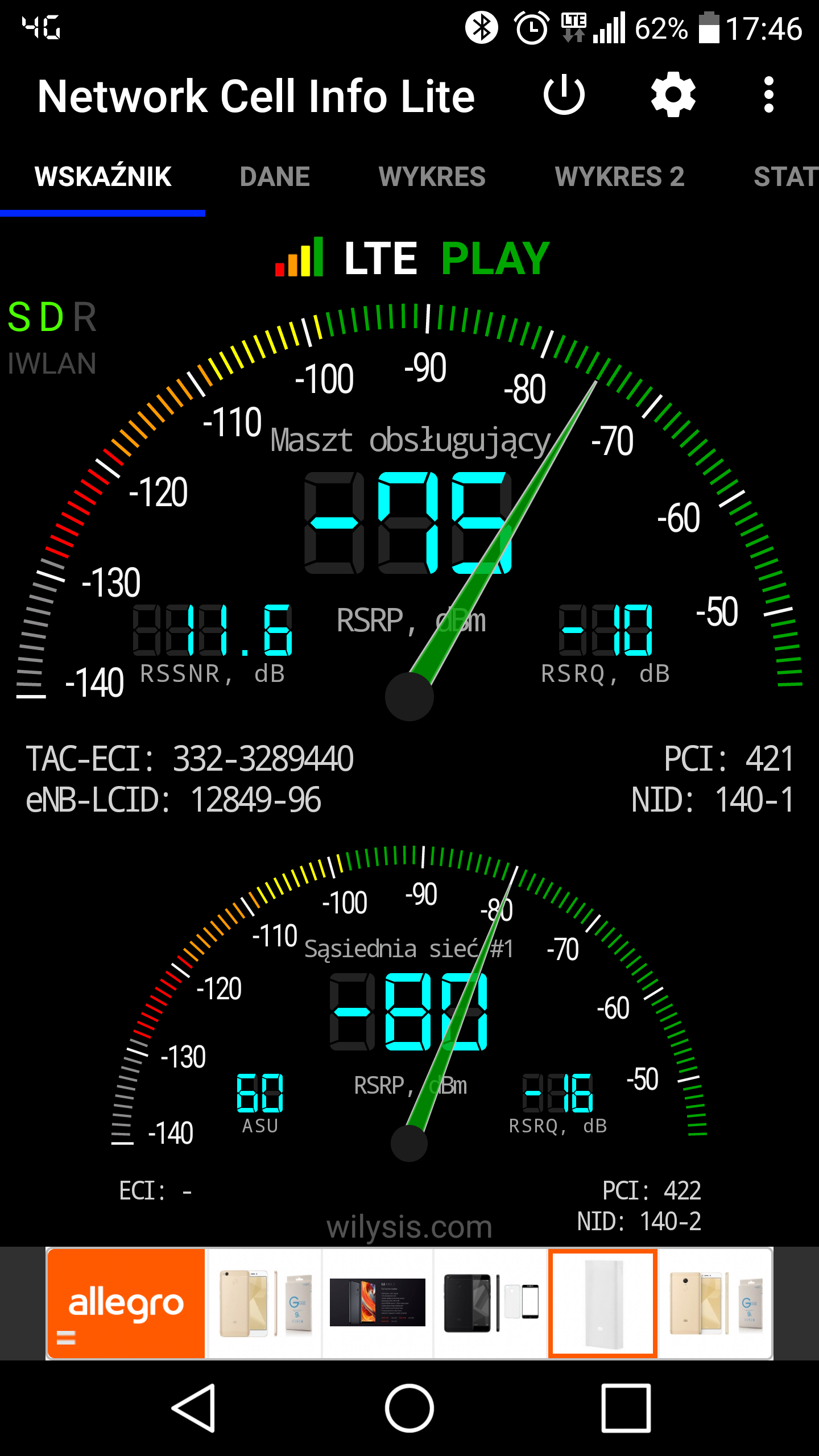

    17.46 Wroclawska 1, Żerniniki Wrocławskie,

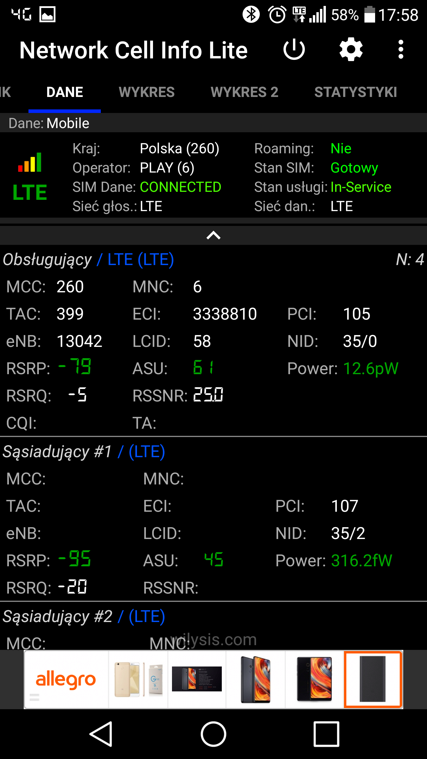

    17.58 Grota-Roweckiego.

    • Best LTE Antenna for Archer MR200 Modem: Recommendations for Wroclaw PLAY Network, Koreanska St. Screenshot_2018-01-15-17-30-23.png (430.53 KB) You must be logged in to download this attachment.
    • Best LTE Antenna for Archer MR200 Modem: Recommendations for Wroclaw PLAY Network, Koreanska St. Screenshot_2018-01-15-17-32-41.png (810.08 KB) You must be logged in to download this attachment.
    • Best LTE Antenna for Archer MR200 Modem: Recommendations for Wroclaw PLAY Network, Koreanska St. Screenshot_2018-01-15-17-46-29.png (433.45 KB) You must be logged in to download this attachment.

    #6 16963500
    matek451
    Posts: 31283
    Help: 4356
    Rate: 5816
    Orange roaming tests irrelevant. So Vilnius is gone. Żerniki LTE1800Play, BTS clogged, DL

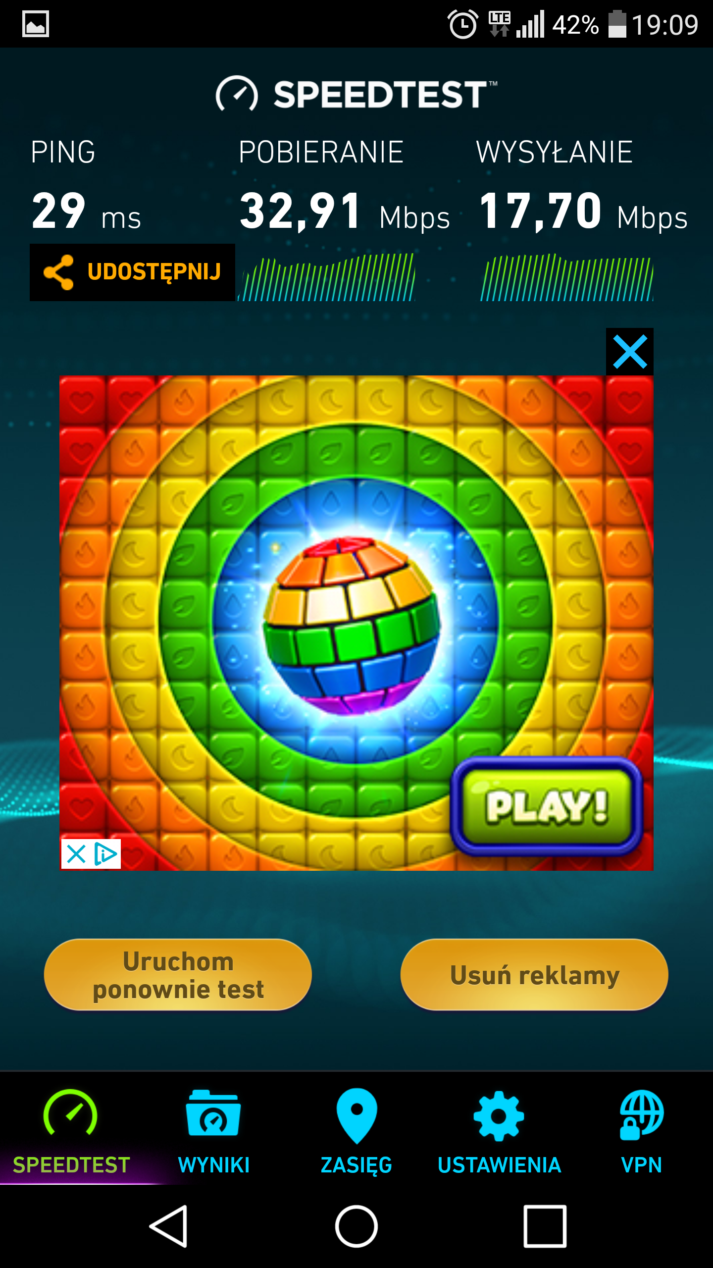

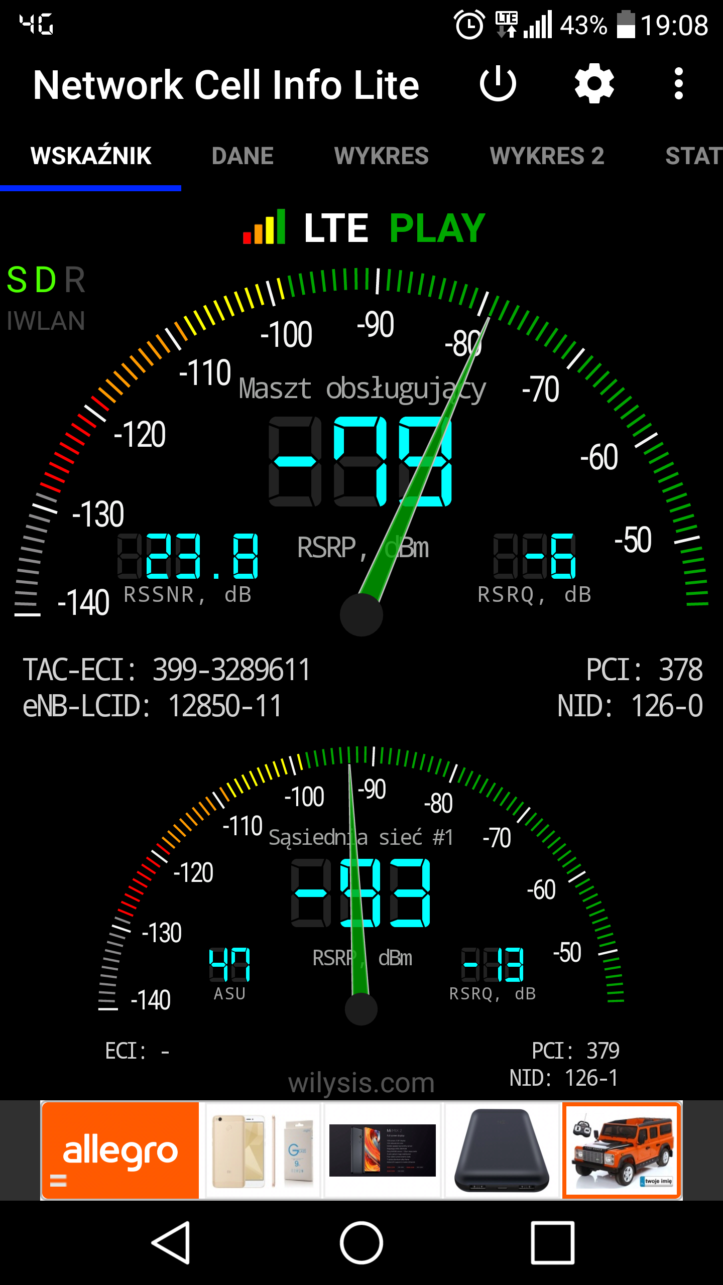

    • Best LTE Antenna for Archer MR200 Modem: Recommendations for Wroclaw PLAY Network, Koreanska St. Screenshot_2018-01-15-19-08-58.png (482.18 KB) You must be logged in to download this attachment.

  • #8 16964307
    matek451
    Posts: 31283
    Help: 4356
    Rate: 5816
    The phone connected to Wileńska with LTE2100 and it is fast, in addition BTS after modernization and on LTE2100 it has 10MHz in MIMO 2x2 and DL up to 75Mb / s. There are also LTE2600 with 20MHz in MIMO2x2 and LTE1800 with 10MHz in MIMO2x2 and LTE800 with 5MHz in MIMO2x2, plus band aggregation. Potential, the antenna at 1800-2600MHz.
