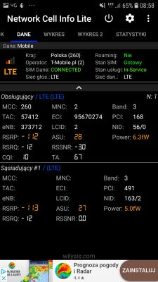

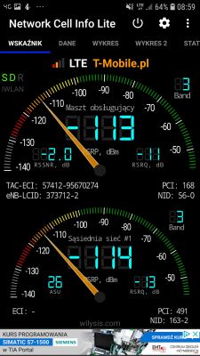

    Unfortunately, I will not change the router.
    I attach screenshots.
    I will be grateful for your help.

    And why the test with T-Mobile like internet on Play? Also, provide the exact location because you connect to the phone with the T-mobie card with BTS Banie on LTE1800NetWorks.

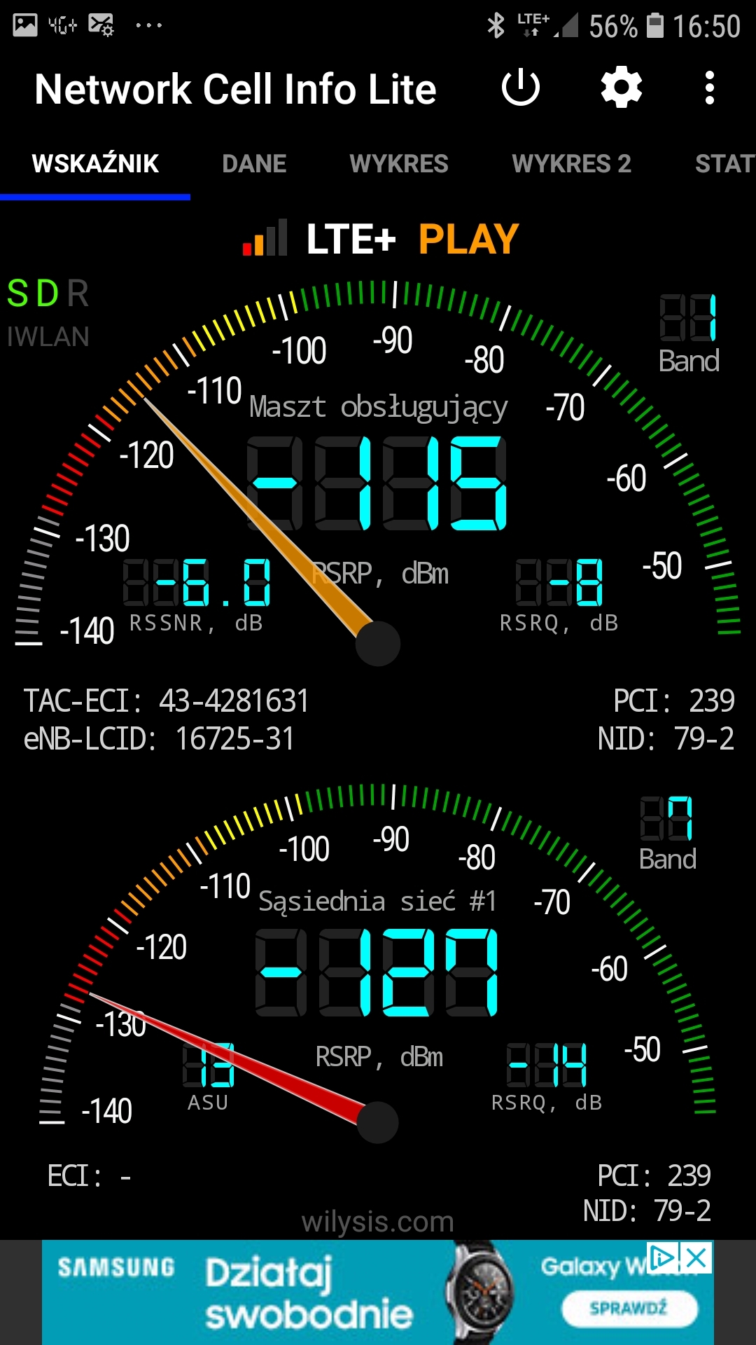

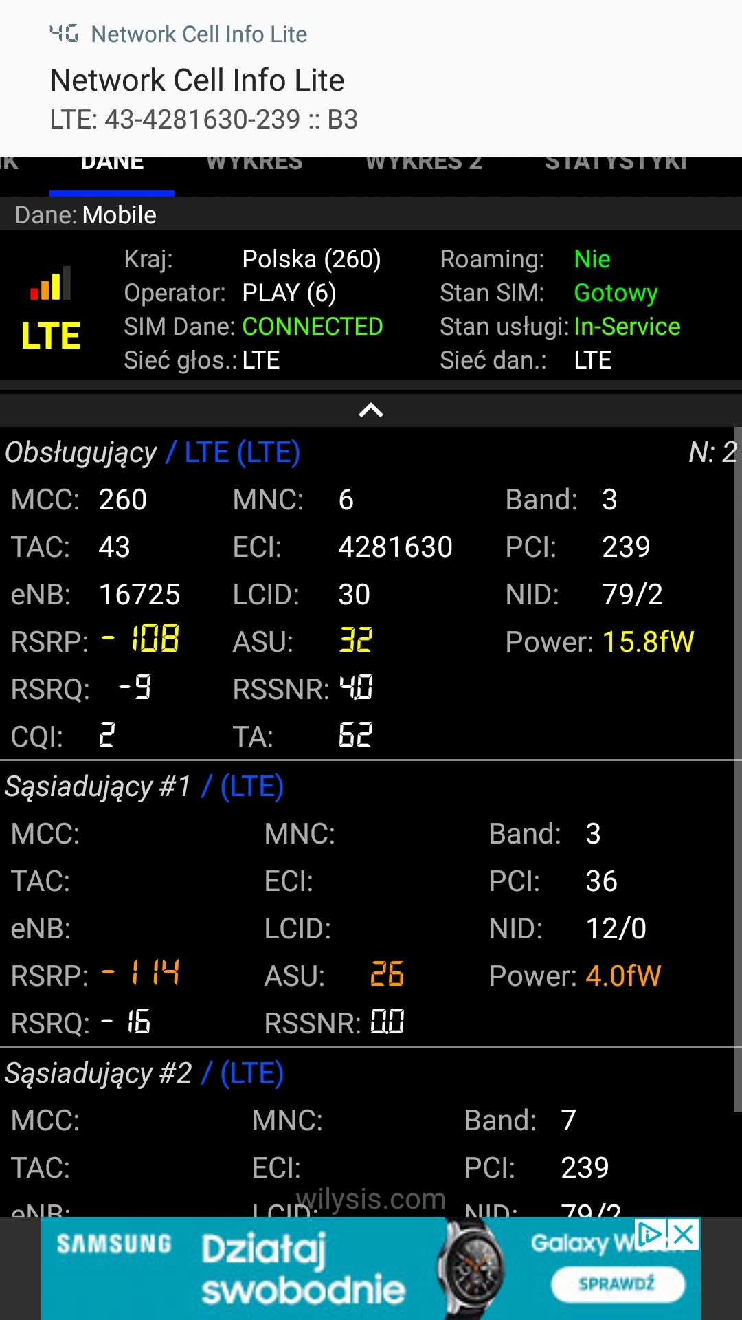

    The town is exactly Żarczyn 74-121.
    Below are screenshots taken on the correct sim card. Seeking Compatible External Antenna Models for TP Link TLMR6400 Router in Remote Area Seeking Compatible External Antenna Models for TP Link TLMR6400 Router in Remote Area

    The phone in Play connects to the aggregation of LTE bands, on the first screen LTE2100 as the baseband and some others to it. the second is LTE1800, the signal is very weak. Home or outdoor test. You log in to BTS Banie, LTE2600, LTE2100, LTE1800 and LTE800 with aggregation are running on it. A bit of a road to BTS and through the forest. An optimal router would be the aggregation of LTE-A bands and the possibility of choosing a specific LTE band. But the basis is an effective directional antenna anyway to improve the signal, even up to the MR-6400. What speeds on the phone with these signal parameters on LTE2100 / LTE1800?

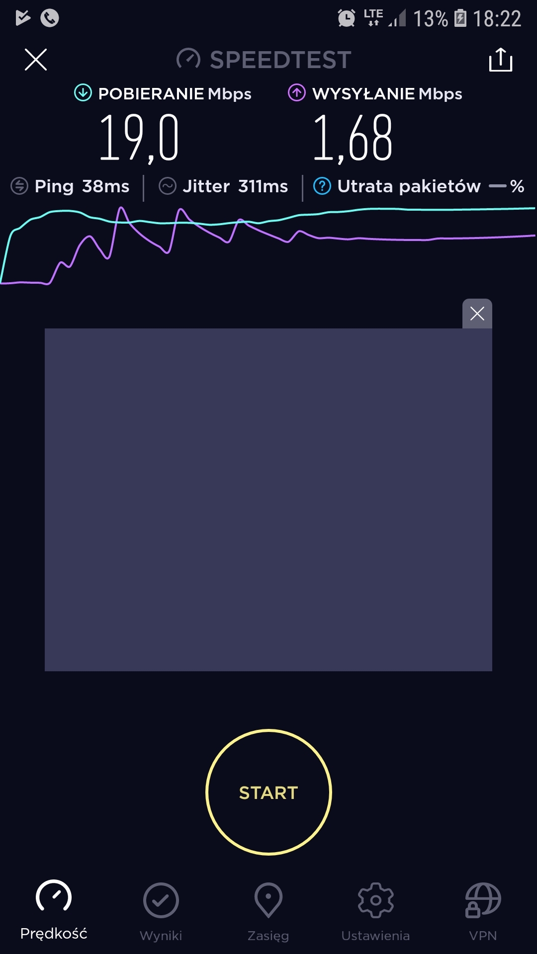

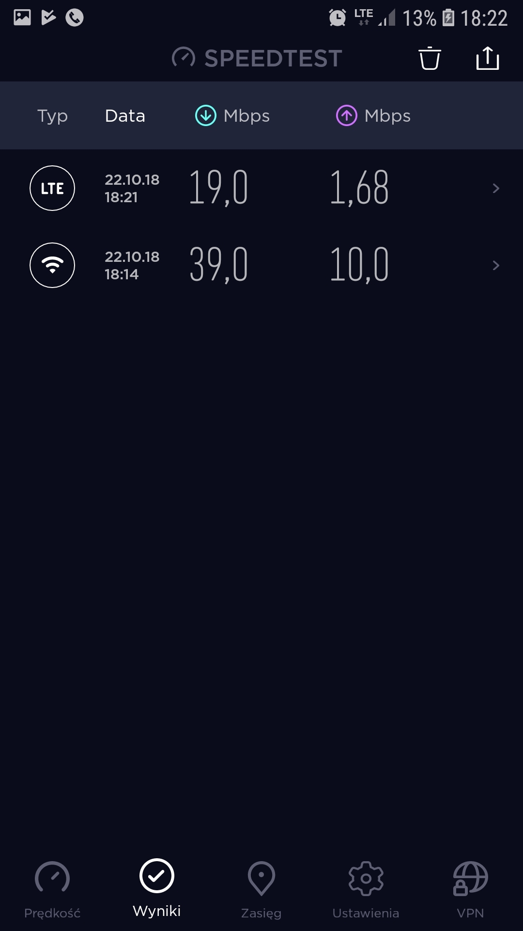

    How can I check the speed?
  • #11 17511254
    Edzien
    Posts: 25
    Rate: 33
    Speedtest below.

    He did not go and he would be useful, but sometimes there is not enough time, people have problems, they still write on PW, on other forums. The speedtest shown is good, one is on a phone with LTE and a Play card? The second one on the right is made after WiFi from what network, router?
  • #14 17516097
    Edzien
    Posts: 25
    Rate: 33
    Yes, one on the phone with the play card inserted, and the other from the Tp Link TLMR6400 router with the same play card inserted.

    The first screen is the aggregation of lte1800 as the baseband plus an additional one from BTS Rybie, the signal at 1800MHz is weak, so probably even worse on lte2100 and LTE2600. The second is LTE1800 from BTS in Dawid, the signal is very weak. The phone is jumping between these BTSs. generally you can see that the potential on BTS is there, the one in Dawid is 5G ready on optical fiber. On MR6400 you will not use aggregation of 3 lte2600 + 1800 + 2100 bands or aggregation of 2 lte2600 + 1800/2100 bands. The LTE2600 band operates at 20MHz width and is assumed to be the fastest but has the smallest range, then lte1800 at 15MHz and LTE2100 at 10MHz. Dual LTE1800-2600MHz 17dbBi antenna from Cybertech. You will not force a specific LTE band on the MR6400, so it is not known whether you will connect to LTE2600 or LTE1800 or LTE2100, although there are good chances that the antenna will improve the signal at 2600mhz enough that the machine will log you into LTE2600.
