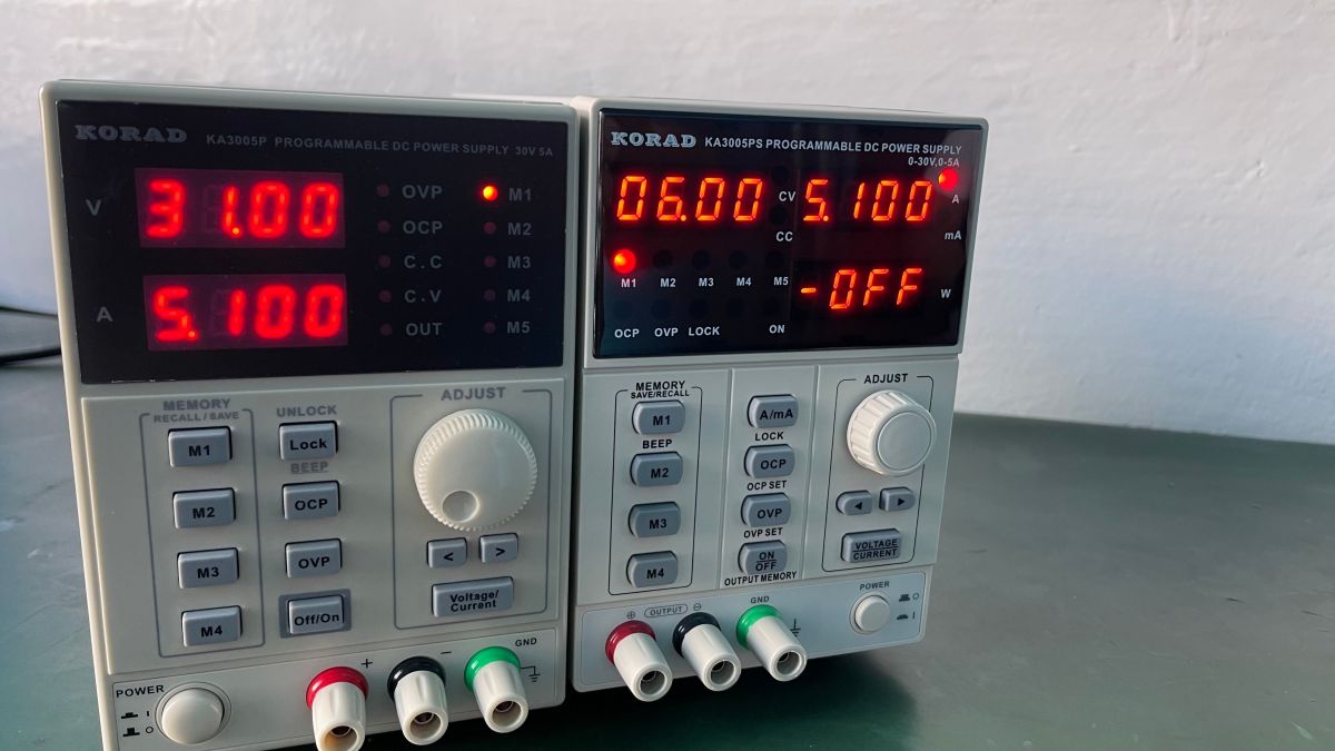

    The prices have already changed to the current ones. For a while there was actually confusion with them old deliveries and new deliveries. The korad version of the ka3005d ka3005P will no longer be sold and will be replaced by the ka3005ps and ka3005ds versions, which have an led display of the current power consumption. the P and D versions are on sale.

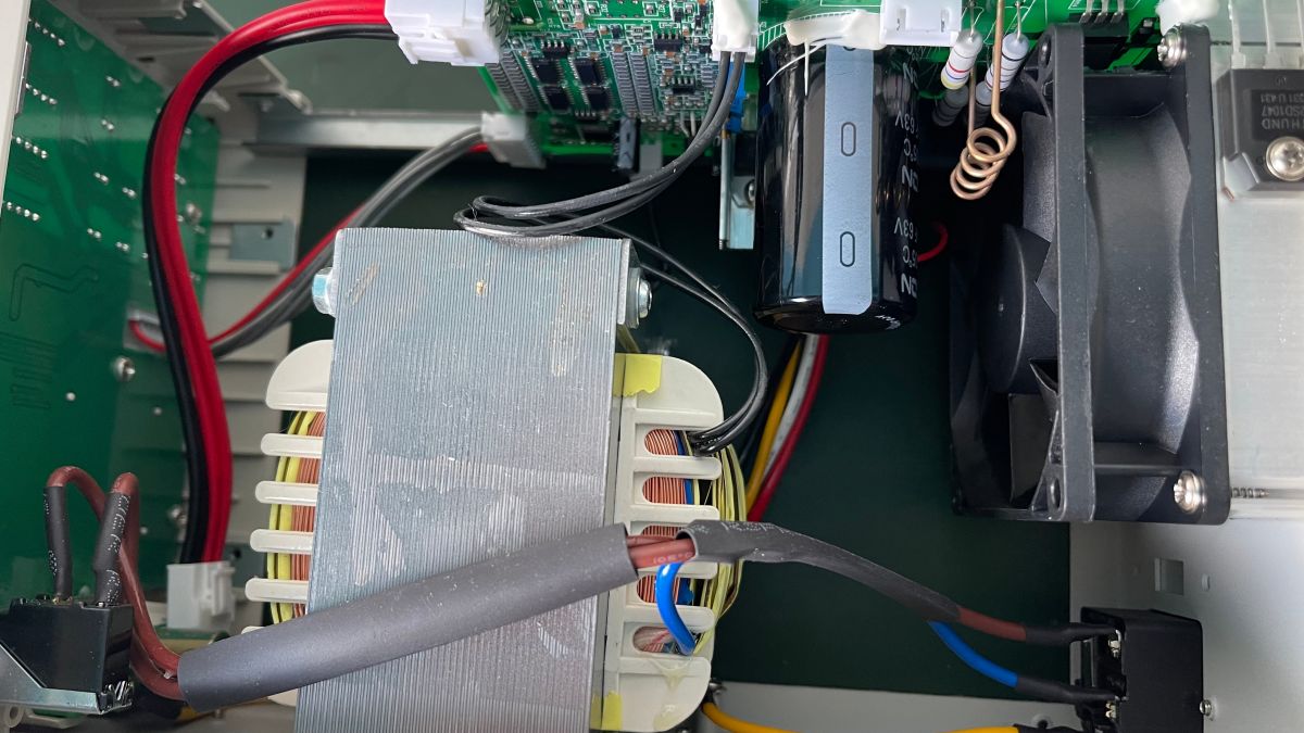

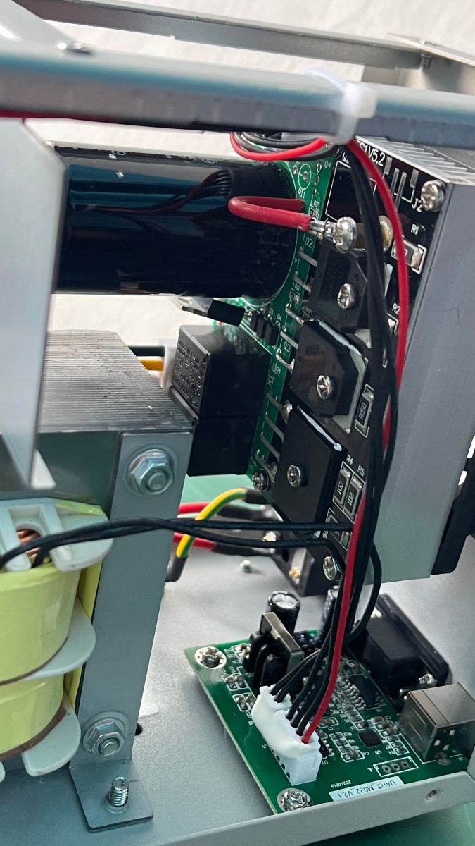

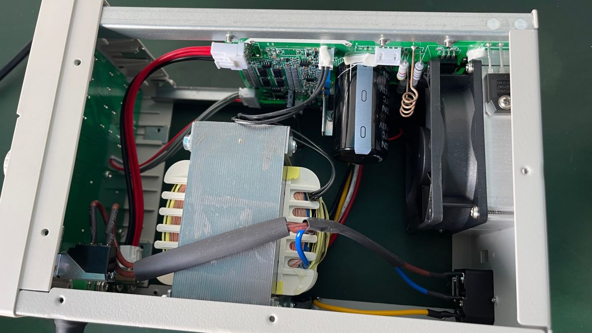

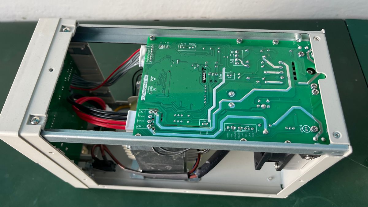

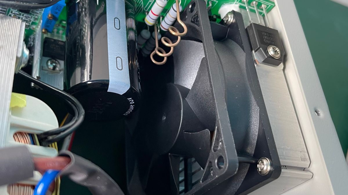

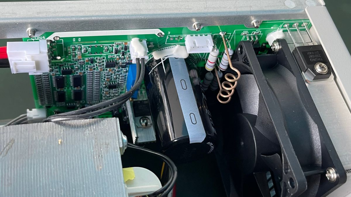

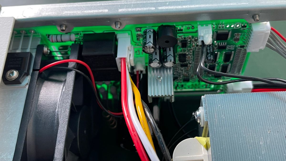

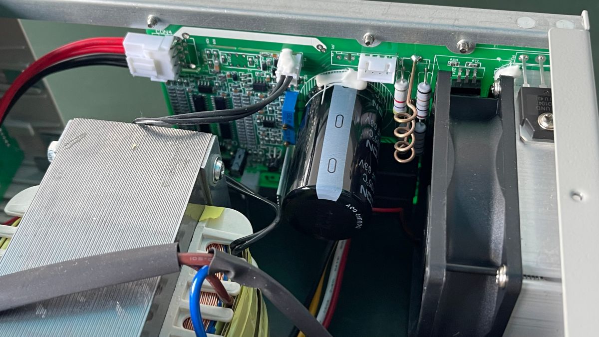

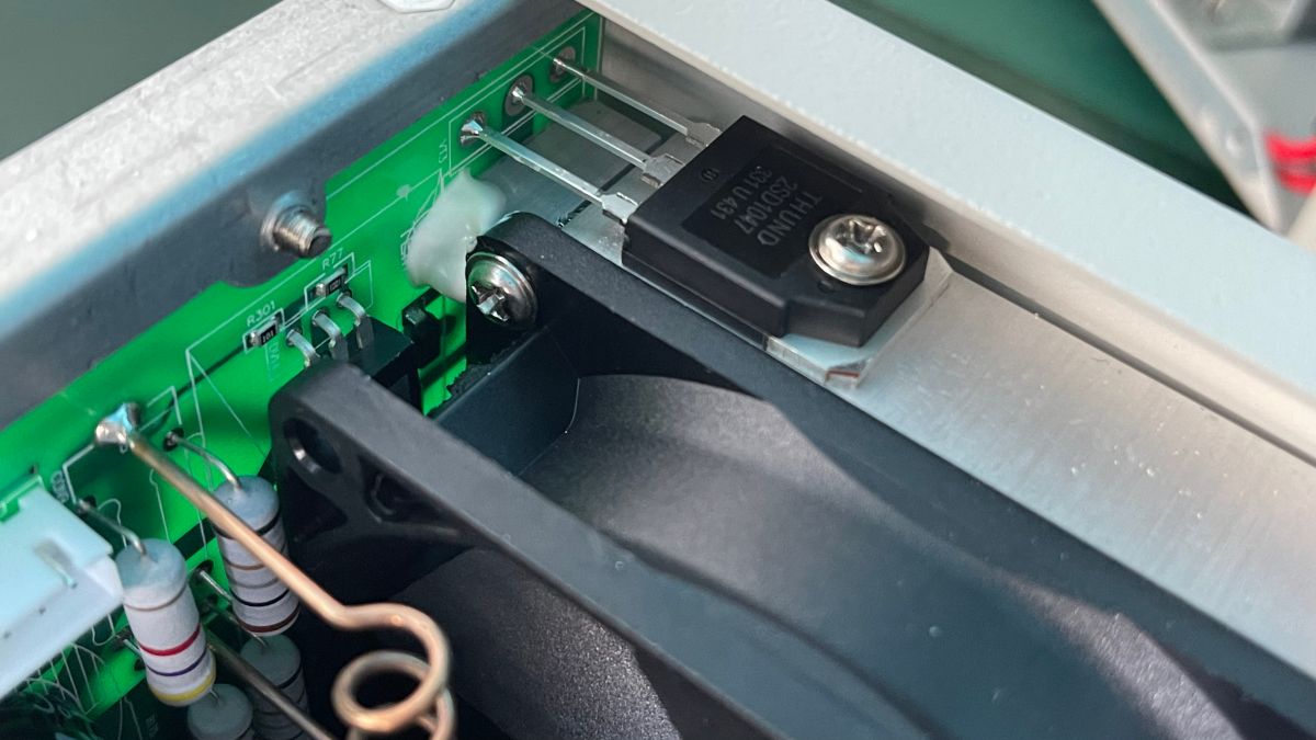

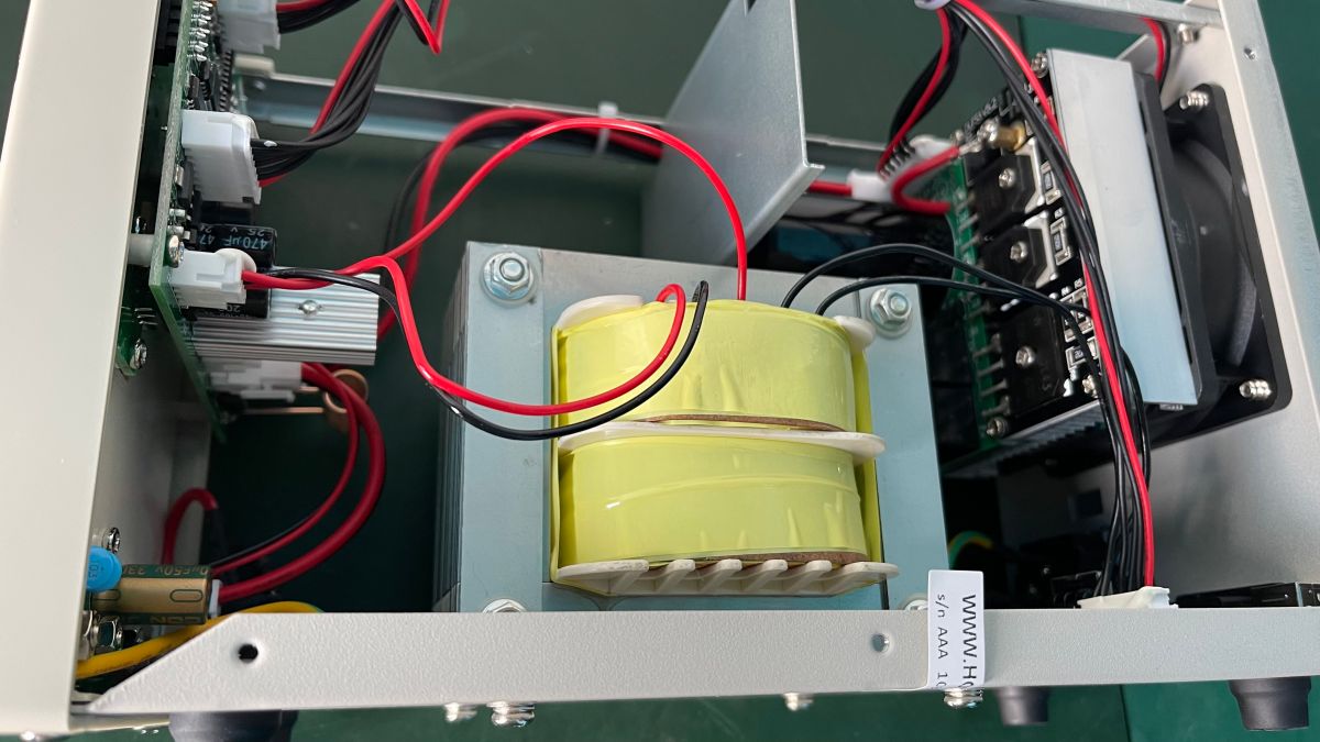

    Photographs of the Korad coil packs for comparison in the ka3005ps and ka3005p versions
    Interior of a Korad power supply with visible electronic components and wires. Interior of a Korad power supply with electronic components and wires. Comparison of Korad power supplies models KA3005P and KA3005PS Interior of a Korad power supply with visible electronic components. Interior of a Korad power supply with a visible transformer and wiring. Interior view of a Korad power supply with electronic components. Printed circuit board inside a Korad power supply. Interior of a Korad power supply showing a circuit board and a fan. . Interior of a Korad power supply with a visible fan and electronic components. Interior of a Korad power supply showing electronic components. View of the interior of a Korad power supply with electronic components, including a transistor and resistors, on a green circuit board. .

    >>21124699 .
    I wonder if they have a calibration option like the old models.
  • #36 21125739
    maz9
    Level 19  
    Posts: 412
    Help: 16
    Rate: 67
    Yes, there is calibration

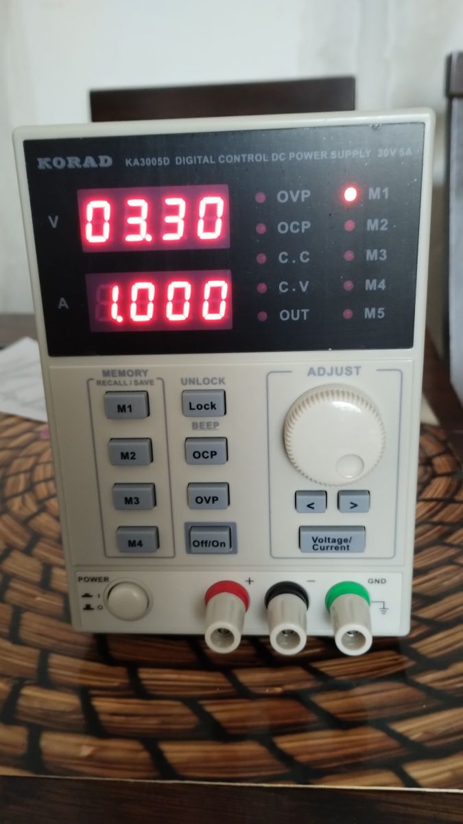

    Have I received a fake Korad? production date 2023.
    https://youtu.be/hWDy3qrTkrY?si=rGWUSqe5-tyTVhjY
    Korad KA3005D digital DC power supply with LED displays.
    EDIT: The lettering is much darker and the filters are more pink than red, while the fan is almost inaudible, maybe it's the manufacturer's changes?
    Interestingly, Velleman ticks an identical one, the LABPS3005D.
    Here the schematic: https://youtu.be/lbONDHU3YLk?si=wBtdm4GGdrDrjCpa

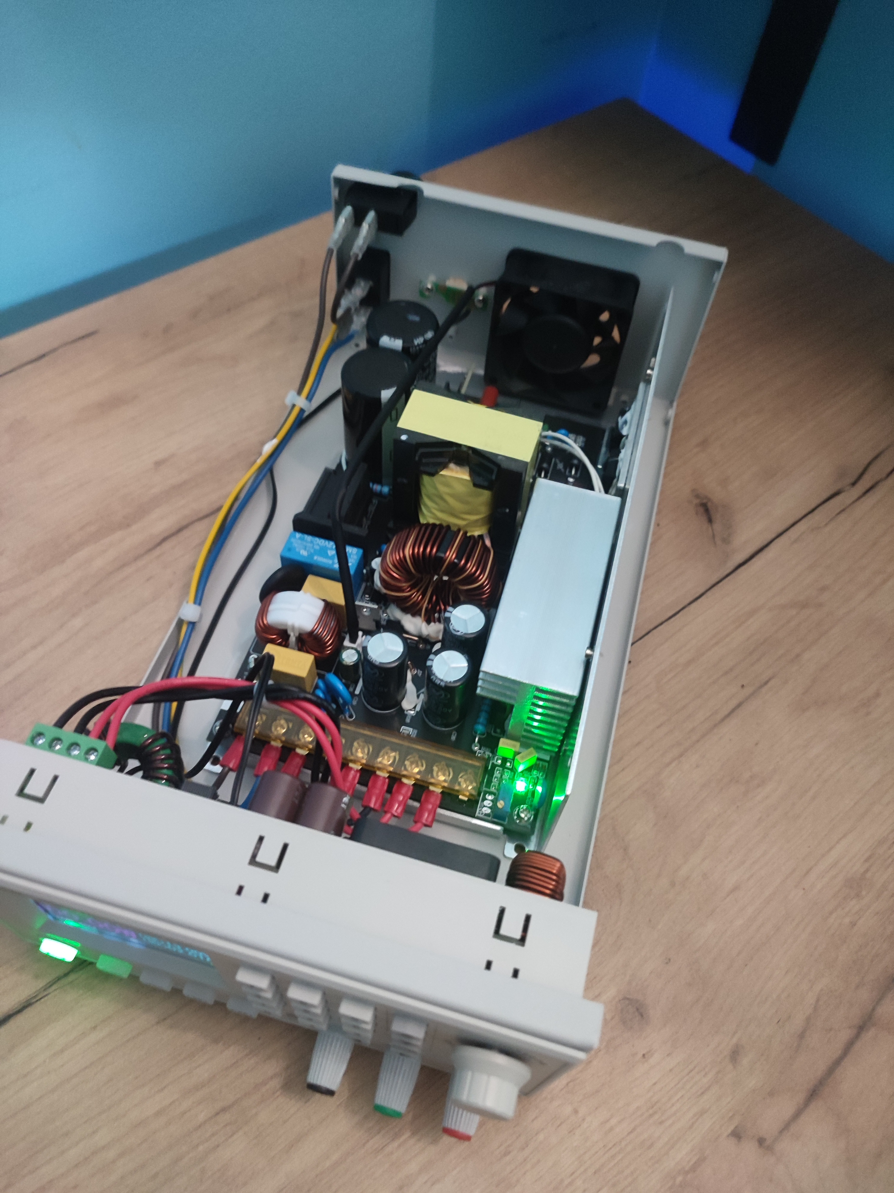

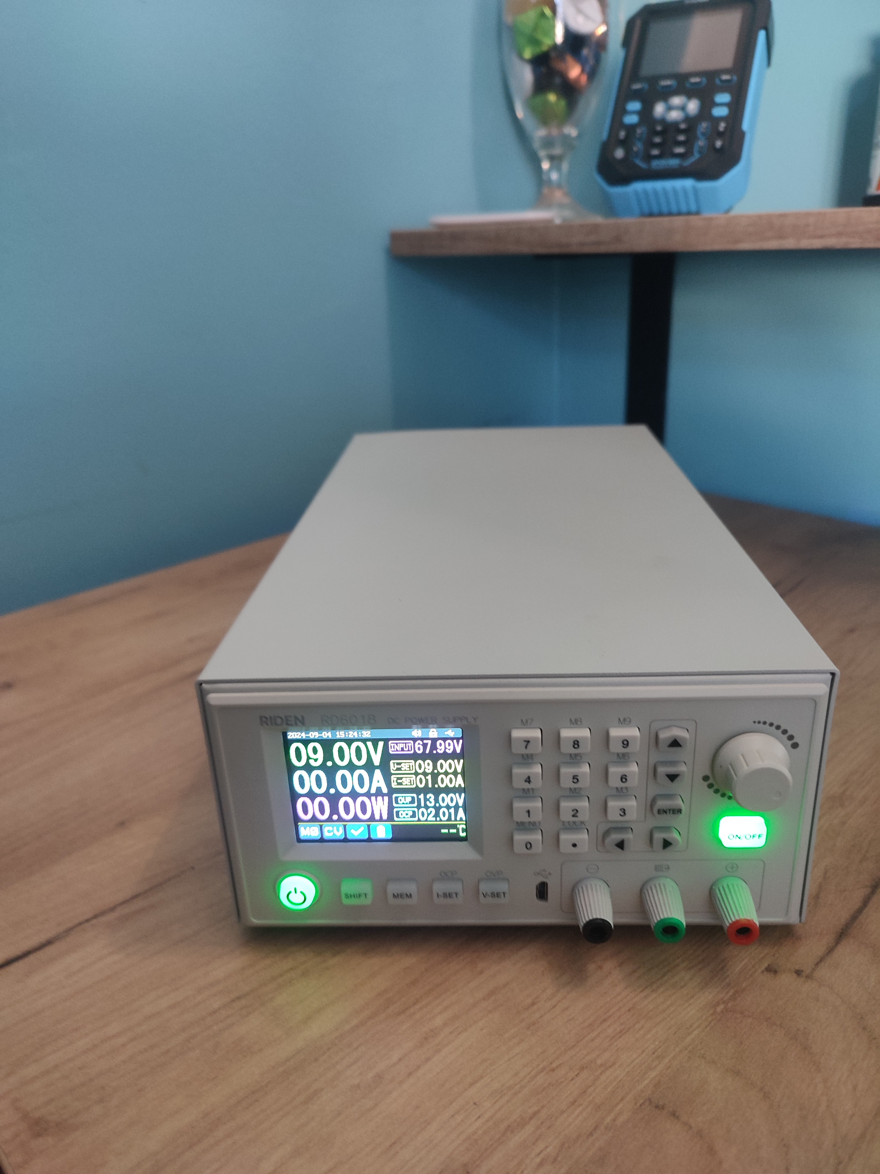

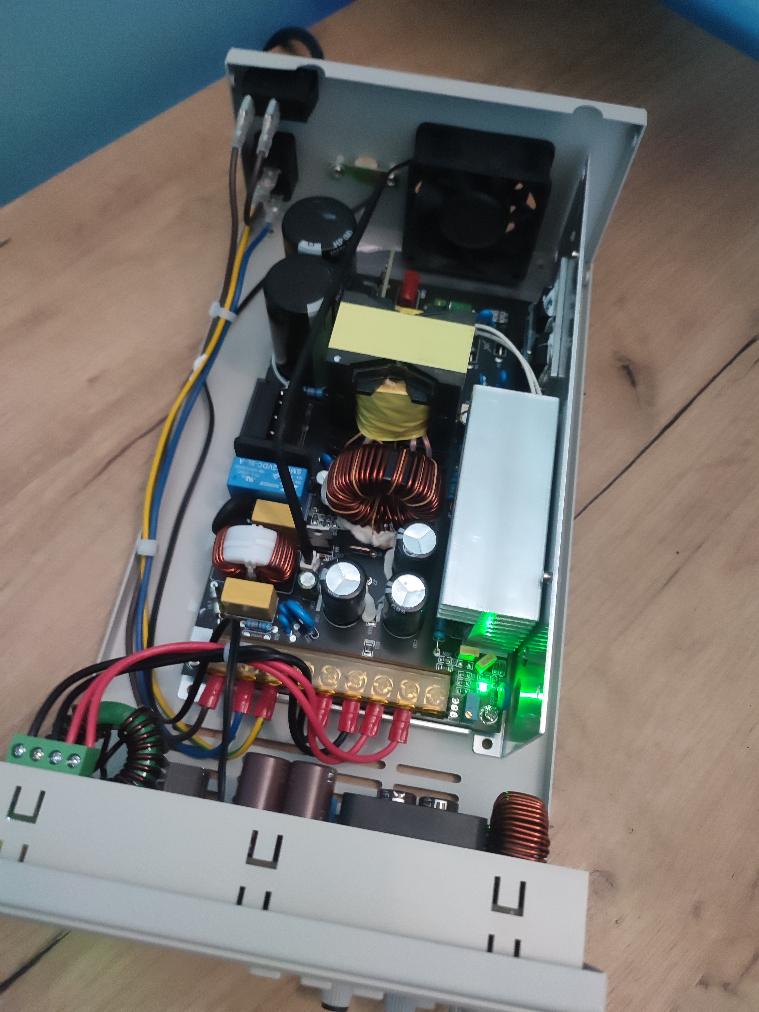

    Recently I was putting together an RD6018, I used the PSU that is supposedly recommended by the manufacturer of these inverters: https://www.aliexpress.com/item/1005004594114....order_list.order_list_main.60.6d811c24921YD9. Unfortunately there is something wrong with this PSU or it just has to be this way, namely even at low 5V and currents up to 0.7A the fan of this PSU starts running when the interior temperature of the case reaches 44°C, then cools down the interior to 38°C and cycles again all the time. This fan howls and makes me nervous. If I had known that such circuses would occur at low currents and voltages, I would have simply bought one of the cheaper pulse lab power supplies. The Korad mentioned in this topic is a linear power supply, and these supposedly heat up more strongly than switching power supplies, so that's probably why the fan used in this power supply has to cool the inside non-stop. Maybe replacing this fan with some quiet company fan would help. There is another worthwhile PSU that has no fan at all, is passively cooled and is said to have very low noise for a switch mode PSU - the Gophert . Today I don't know what to do with this junk, whether to put it away and buy one of the cheaper PSUs I've listed here, or maybe try to replace the fan of this PSU with some company's fan. Edit: I'm attaching pictures of my PSU after removing the PSU sheet metal and moving the fan to the very end of the case it's a bit quieter going this PSU but it still has something wrong with it.

    slavo666 wrote:
    lfldp wrote:
    https://www.aliexpress.com/ite...er_list_main.60.6d811c24921YD9. Unfortunately there is something wrong with this PSU or it just has to be that way, namely even(...)
    And have you perhaps tried to read the offer description? It's in Polish even.
    Nothing comes out of this description, it's all about quite fast heating, which makes the fan run even at low currents. Perhaps other PSUs work better, but this one is one of the more expensive ones that the manufacturer itself recommends. Here described a similar problem, in that case even better, because the fan only turns on at 50C https://www.elektroda.pl/rtvforum/topic3886034.html#19973865 .
