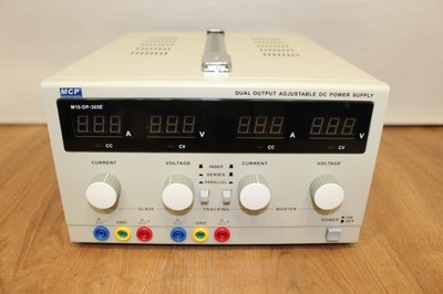

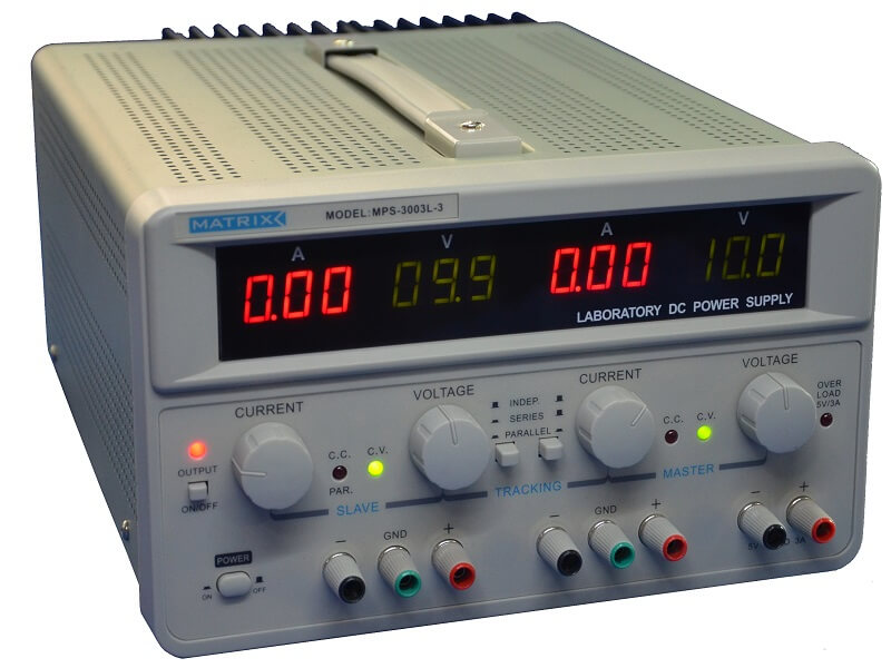

    zdzisiek1979 wrote:
    I'll hook up. And do you know any power supply that will fully withstand a short circuit at max settings? single-channel or two (here, short circuit in, say, serial and parallel operation). I have a choice myself. Rather digital I give up because of the micro processors.
    And how is the warranty for damage during a short circuit because since the short-circuit protection is probably it should oblige.
    Sure I know. I have one like the following and you can both short-circuit for any length of time for max current and max voltage. The heat sinks only heat up a bit.
    They can be bought from national NDN distributors, but in NDN I am no longer called MCP but NDN (if I remember correctly), but the power supply is the same.

    I saw this matrix in tme and I was interested in 5A. Twintex yet. Probably almost the same brandy as.
    I do not know if this matrix has ordinary or many rotary potentiometers because in the movie I saw that V has many rotary switches. Either modification or original.
    In my Matrix V is ten-turn while A is normal.
    In MCP both are usually, but very precise, working with resistance, which allows for accurate parameter setting.

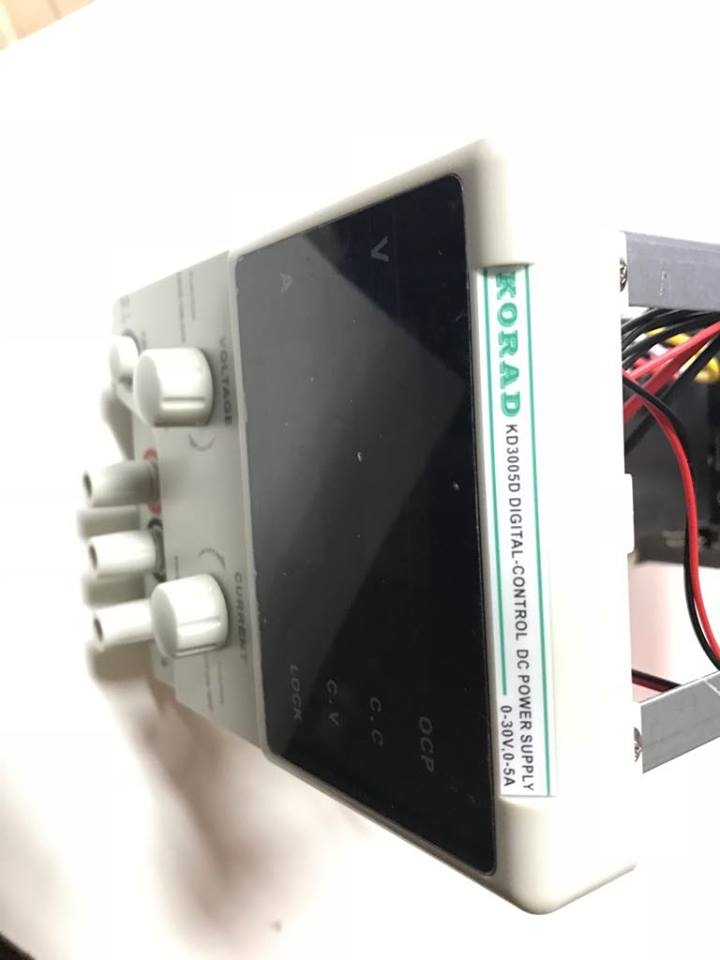

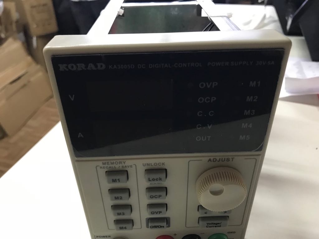

    For those interested in pics. Some changed in Korad power supplies. The fan is quieter than in previous versions. With this, please remember that in previous versions the sound of the working fan would set after connecting the current receiver or load. Noise only if the power supply was not loaded. Keep in mind that, however, in most cases the equipment that we turn on is used, and we connect something under it and then the noise disappears.
    Anyway, now Korad power supplies are quieter. They become even more silent if we connect a power receiver. The most important thing is that they can be set in the operating mode as a current source and the set current values are shown on the display. Within the price limits of the Korad KD3005D power supply, it is a unique advantage and a useful function.
    Which laboratory power supply KORAD KA3005D or KORAD KD3005D? Which laboratory power supply KORAD KA3005D or KORAD KD3005D? Which laboratory power supply KORAD KA3005D or KORAD KD3005D? Which laboratory power supply KORAD KA3005D or KORAD KD3005D? Which laboratory power supply KORAD KA3005D or KORAD KD3005D? Which laboratory power supply KORAD KA3005D or KORAD KD3005D? Which laboratory power supply KORAD KA3005D or KORAD KD3005D? Which laboratory power supply KORAD KA3005D or KORAD KD3005D?
