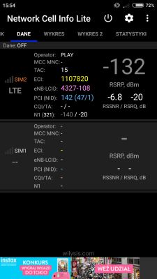

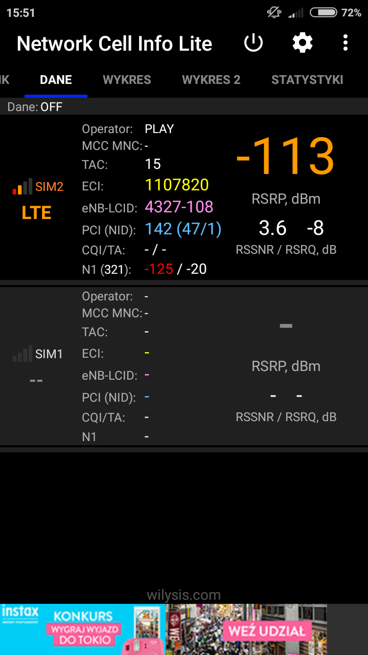

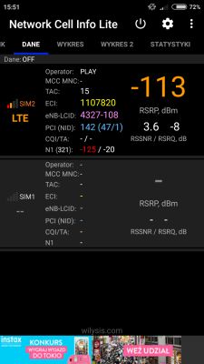

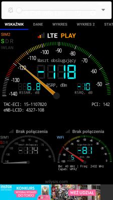

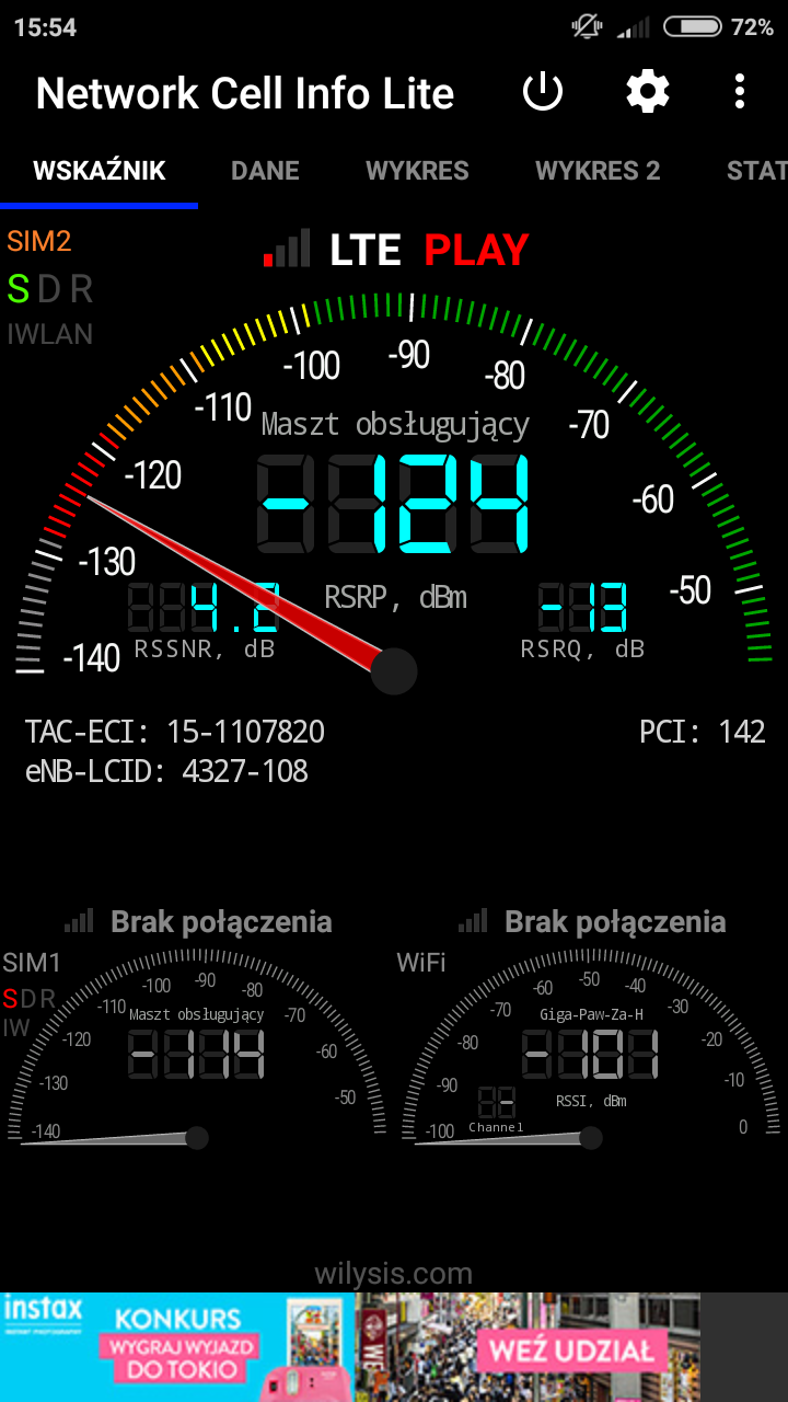

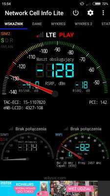

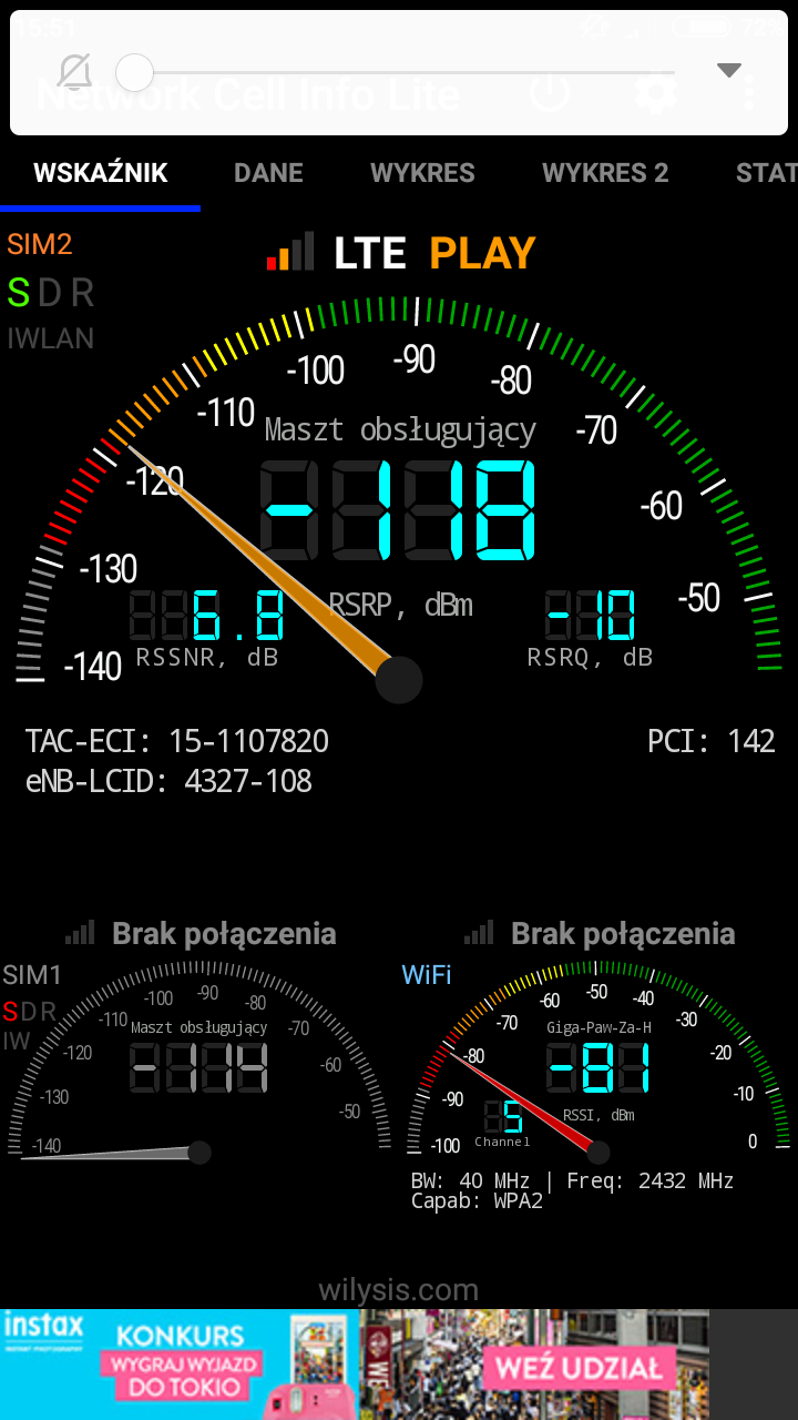

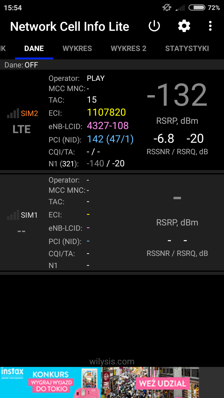

    I did not do this on this card, but on the Play tab I did range tests, 50 meters north of the home range, up to 3/5 strokes.
    I have a couple of discharges from the phone Activating Unlimited LTE on Red Bull Mobile: Steps, Code *111*763*1#, and Conditions Activating Unlimited LTE on Red Bull Mobile: Steps, Code *111*763*1#, and Conditions Activating Unlimited LTE on Red Bull Mobile: Steps, Code *111*763*1#, and Conditions Activating Unlimited LTE on Red Bull Mobile: Steps, Code *111*763*1#, and Conditions Activating Unlimited LTE on Red Bull Mobile: Steps, Code *111*763*1#, and Conditions

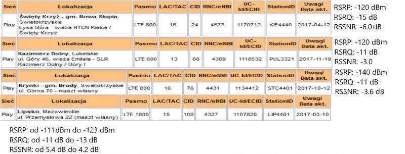

    These are scraps of coverage, those with RSRP on the level of -113 / -118dBm give some hope. but this is a connection to the LTE1800 Play BTS in Leipzig. There is no confirmed LTE800 on it. In Iłża, LTE1800, LTE2100 and LTE800 operate. And routers, sets leave much to be desired. For me, it's monuments. In your location, the basis is to provide the correct LTE signal, i.e. the purchase of an external antenna.

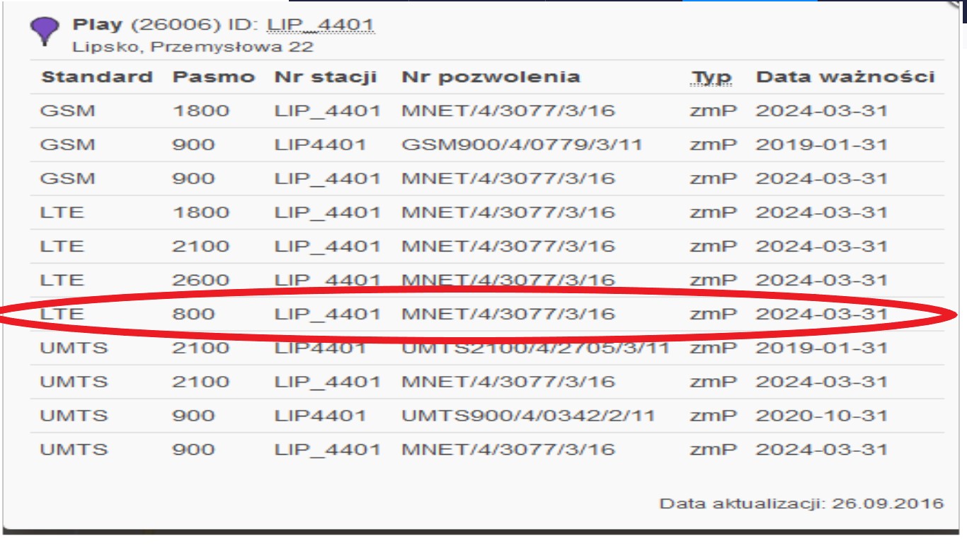

    According to UKE LTE800 in Leipzig there is a BTS on Dr. Anki in Iłża is poorly settled.

    This is permission, the LTE1800 and LTE2100 are verified and they work. Make a current test on the phone with the Play card. NCI will show ECI BTS, with such RSRP at 1800MHz it should connect you with LTE800 sooner if it works.
