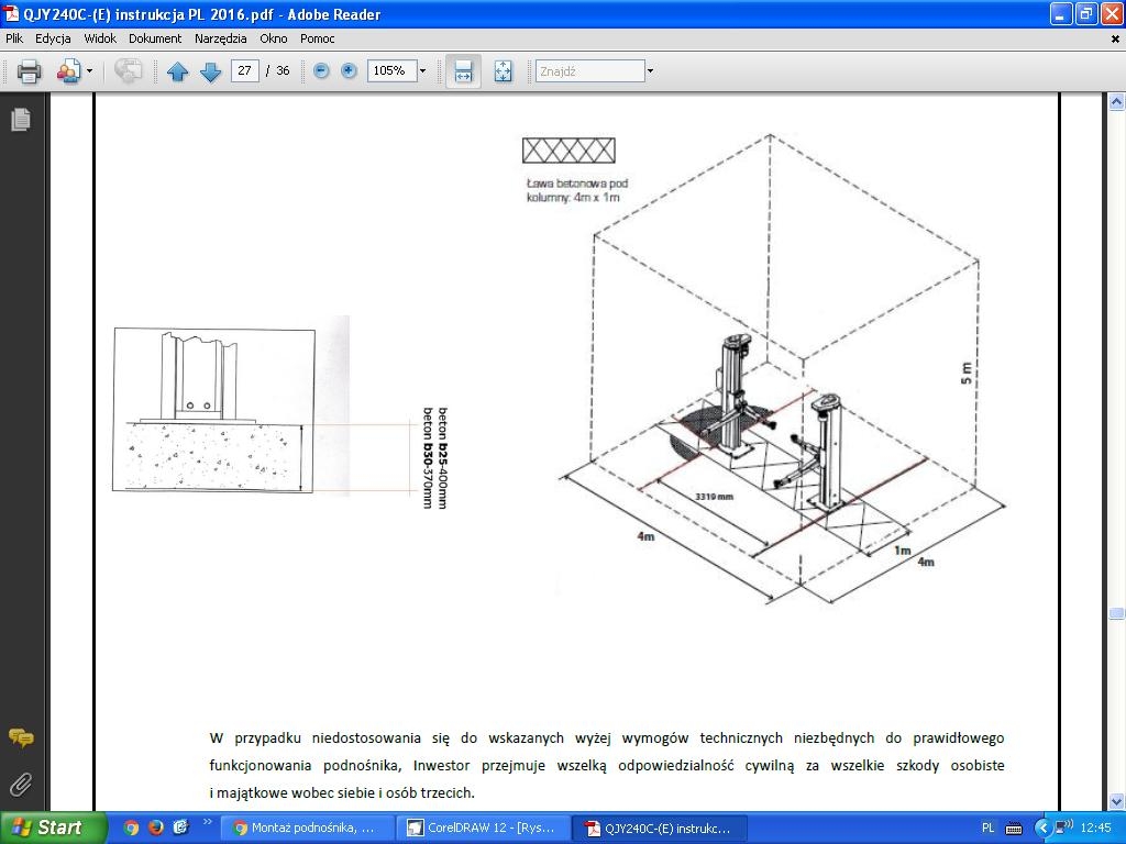

    Download the lift dtr. There, the foundations will be described and dimensioned.

    2-Column Car Jack Installation: Optimal Hole Dimensions and Anchor Recommendations for Concrete B25
    Please, dump from one of my lifts.

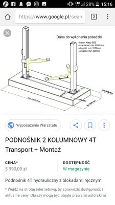

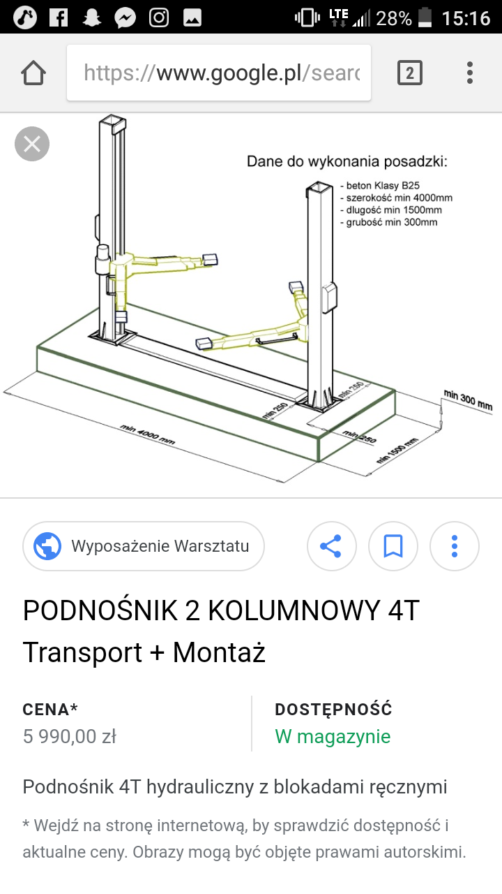

    And I think I will make such dimensions as in this attachment 2-Column Car Jack Installation: Optimal Hole Dimensions and Anchor Recommendations for Concrete B25
    What do you think will be okay?

    Almost 2 cubic meters of concrete. Modestly counting two pallets of bags ...
