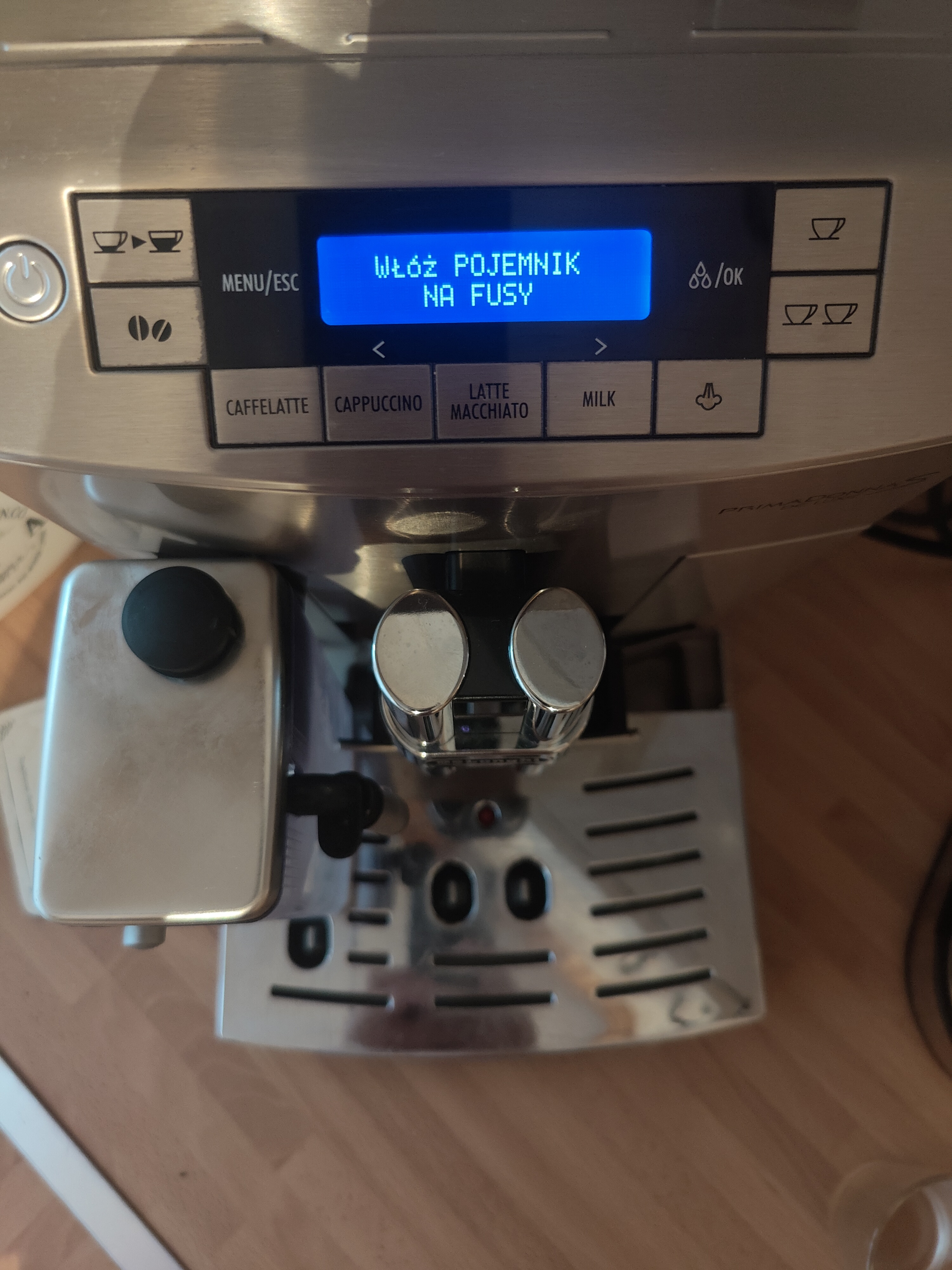

    I have a similar problem on the primadonna de luxe model. After taking the camera out to clean it keeps popping up the message mount the camera. Inside everything is clean and rather seemingly no play. If you can I would ask for instructions on how to do an encoder reset. Thanks
  • #50 20724237

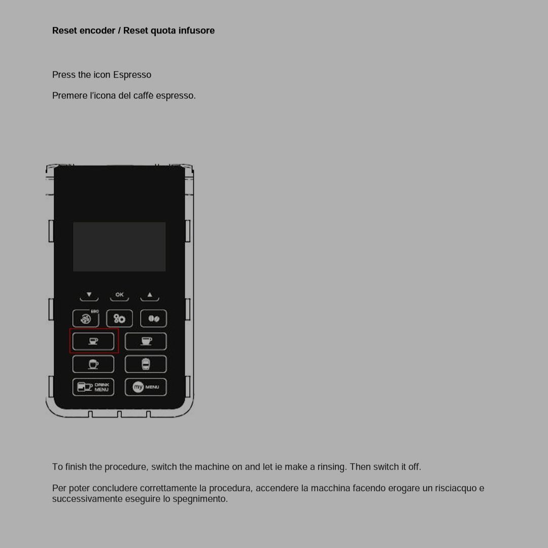

    Due to great interest, I am providing instructions on how to properly perform this reset below.
    Enter test mode:
    De'Longhi ECAM 350.55B - Infuser Attachment Issue & Solution After Descaling Process
    The coffee machine is plugged in but turned off.
    - slide out the trays.
    - press the buttons simultaneously:
    Rinsing; aroma; drink menu and MyMenu.
    After correctly performing the above, the text TEST MODE should appear on the display. then slide the trays into place.
    Now just press the espresso button to select encoder reset.
    After everything, turn on the coffee machine using the button at the top. And let it rinse, then disconnect it from the power supply (remove the plug from the socket)
    *The machine must be clean inside for the reset to be correct.
    **After booting into reset mode, the subtitles will be in English. After restarting, everything will return to normal.

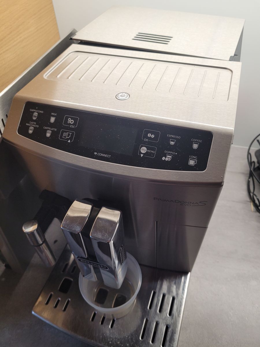

    Thanks. But in my Primadonna S deluxe model it doesn't work like that, no reaction at all. Maybe because there is a different type of display and buttons...

  • #54 20740843
    Bayliner
    Any ideas?

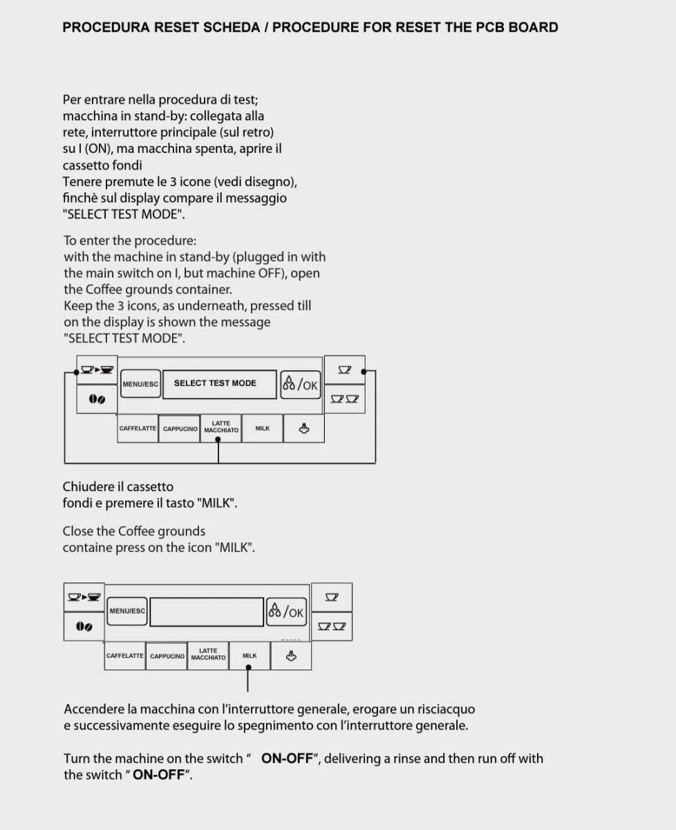

    Below are the instructions Instructions for resetting the coffee machine's PCB board.
  • #56 20740900
    Bayliner
    It's gone. Many thanks.
