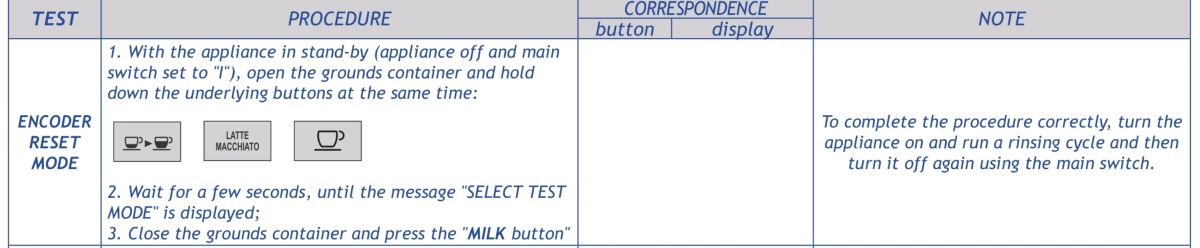

Clean and inspect the brewing unit first, because this error is often caused by play, dirt, or a microswitch being missed so the hall sensor counts incorrectly [#20107513][#20336813] If the mechanism is OK, perform an encoder reset in TEST MODE: plug the machine in but leave it off, slide out the trays, press Rinsing + Aroma + Drink Menu + MyMenu together until TEST MODE appears, put the trays back, then press the Espresso button for encoder reset, turn the machine on, let it rinse, and unplug it afterward [#20738719] If the infuser still does not reach the upper microswitch, the mechanical cause must be removed first; users reported fixing it by cleaning out coffee grounds, tightening the carriage/handle, or correcting the infuser position so it presses the switch properly [#20330869][#20336813] Some cases needed replacing the upper/lower switches, the hall sensor, or worn drive parts such as the screw/nut assembly [#20107513][#20470828]

    Hi, I have a problem with Primadonna XS, it gives me a "fix block" error.
    Please send me this procedure you write about.
    Thanks, regards Marek>>20107513 .
  • #66 21514214
    djszaman
    Posts: 41
    Rate: 112
    >>21514196 .
    Table showing steps for the encoder reset mode procedure of a coffee machine. .
