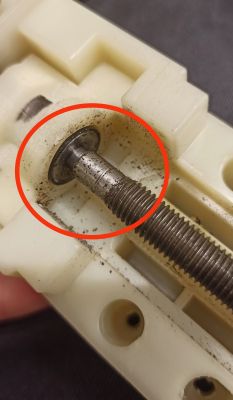

    Does anyone have a specific solution to the problem? I replaced the ompkr at home and read that a reset is needed later, but I don't know how to do it. Someone help? I suspect that it could be similar for you
  • #9 18892754
    piatkowski92
    Perhaps someone will find it useful.
    I had a similar problem with the machine showing the general alarm message. The machine did not rinse, did not make coffee, did not turn off properly. The problem appeared right after making two coffees and turning off the machine.
    I have cleaned the entire brewing unit, including taking it apart and lubricating it. Most of the dirt was under the strainer.
    I unscrewed and cleaned the thermoblock strainer. This can be done from inside the machine. It was very dirty.
    The last step (crucial in my case) is running hot water twice as a whole process.
    If there is a problem with removing the brewing unit, you need to rotate the toothed wheel from the motor with your finger.
    The fault occurred after 1.5 years of use.

    Most often, the problem occurs when there is play in the brewing unit's carriage or it is dirty, then it misreads impulses from the hall. It is best to replace the upper and lower switches and reset the encoder
  • #15 20110278
    radeks1968
    Posts: 735
    Rate: 419
    After two weeks, the return will see the same again with these backlash.
  • #16 20110402
    djszaman
    Posts: 41
    Rate: 112
    Manually, it is difficult to assess these clearances, and the sensor will have a few pulses missing and an error will be crashed. The encoder reset itself without replacing the switches should do the trick, but it's better to replace because the contacts may be overheated and not always catch

    You still haven't removed the cause, he should commute without gluing himself.
    As I wrote earlier, grains could come up or there is still an option that the propeller unscrewed and moved it back a bit, but it's more of a mess than cleaning the propeller itself. Reset here will not change anything and maybe even spoil it, I can send you instructions on how to do it, but you will do it at your own risk, because something is clearly wrong with this drive.
    I sent instructions in DM

    The patent with a piece of rubber from a bicycle tube worked for me (I have a Delonghi ECAM 23.460). After replacing the Hall sensor, all gaskets, gear screws, removing all play, this message continued to pop up. I cut a small circle out of a bicycle tube and glued it to the piston element of the thermoblock that pushes the upper microswitch. After two days of digging and actually major renovation, it turned out that only a piece of rubber did the trick :)
  • #28 20373933
    djszaman
    Posts: 41
    Rate: 112
    @Premos replacing the hall itself without reset will not do anything, data on the number of steps is saved on the motherboard, so after replacing it had to be reset.
    That's why it didn't work after this general overhaul. Most likely, it was enough to just do a reset without digging and replacing anything.
