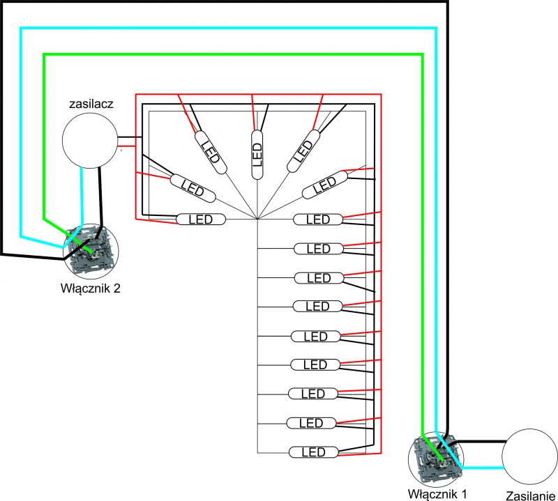

    Hello. I have to do the lighting of the stairs with aluminum profiles with led strip, and I wanted to use a motion sensor, but the client wanted to light the leds with variable switches. I'm sending the file and please tell me if it will be okay ... I think so, but I want to make sure
    LED Stair Lighting with Aluminum Profiles: Using Motion Sensor vs Variable Switches
    and now a few questions:
    1) what is the cross-section of the cable from the power supply to the box? (I think wire, but what cross-section ... 2 * 1mm is enough?) and use the same cross-section between the switches? and then what cable from the power supply to the leds? (link, but what cross-section)
    there are 15 degrees, the total length of the LEDs is about 13 m.
    It's bad !!! you are going to use the green wire as the phase correspondence wire. Place a 4x1.5mm2 cable between the switches
    It is not enough that the minimum cross-section of the wires is 1.5mm2
    Protection of a circuit with conductors with such cross-section not greater than 10A

    ok, what is the cross-section from the power supply to the leds?
    apart from the color of the veins, is this connection good?

    piotr2593 wrote:
    ... the connection is good?
    It is not visible from the drawing if the switches are properly connected. If you drew them schematically with the closing points shown, it would be possible to judge.
    2x0.5mm for LEDY and the main string along the stairs 2x0.75mm2 power supply in the center of the system. If you give a thicker wire to the tapes, there will be problems with deforming the tape.
    For the operation, yes, but the most important conductor in the system, i.e. the protective conductor, is missing.
    1. Not every installation has a protective conductor.
    2.Even if in this case, where to attach it? Is "art for art" to be situated?
  • Protective conductor required for the LED power supply housing
    #11 16998104
    mawerix123
    Posts: 4150
    Help: 482
    Rate: 951

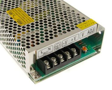

    Each new installation MUST be, whether you like it or not, whether it will be used for the device today or in a year when it is replaced with a new one made of PE. End of discussion !!!
    DiZMar wrote:
    Even if he did, where to join him?
    For the housing of the LED power supply !!!!

    mawerix123 wrote:
    2x0.5mm on LEDY and the main string along the stairs 2x0.75mm2 power supply in the center of the system. If you give a thicker wire to the tapes, there will be problems with deforming the tape.
    and if I planned to lead the cable from the led strip to the led strip (rewind), it would be 2x0.5 or 2x0.75
    No problem with soldering the wires, even at 0.5mm, the entire power supply with a 0.5mm cable, i.e. some 0.2mm2, will probably cause a large voltage drop, and as you know, 13mb of the tape is a lot regardless of its power

    DiZMar wrote:
    You also do not know if the power supply used by the author has a metal housing
    I am not interested in what he wears. Today, in the second forest, and when it ends its life, a new fuchsia will come and will put on the one I showed, but without PE, because a year earlier, according to the TV specialist, a protective conductor was not needed. I will not discuss with you the necessity to lay the protective conductor because it is a dry discussion and for an electrician it is a matter of course.
