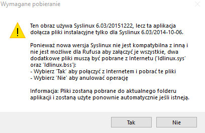

    I downloaded linuxmite 18.3 and it shows up when I try to open rufus [/ img]

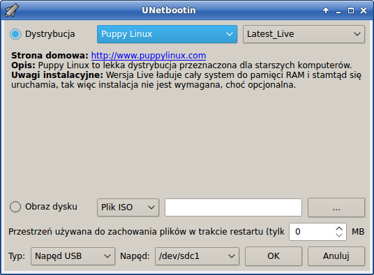

    Unetbootin is also not complicated. It will even download the Linux distribution of your choice.
    Genesis X66 Keyboard: Buttons Not Working & Text Issues for Pawel - Troubleshooting Advice
    I did it / via this download /, and what should I do next?
    because no one explained how to use it now; unless I didn't understand

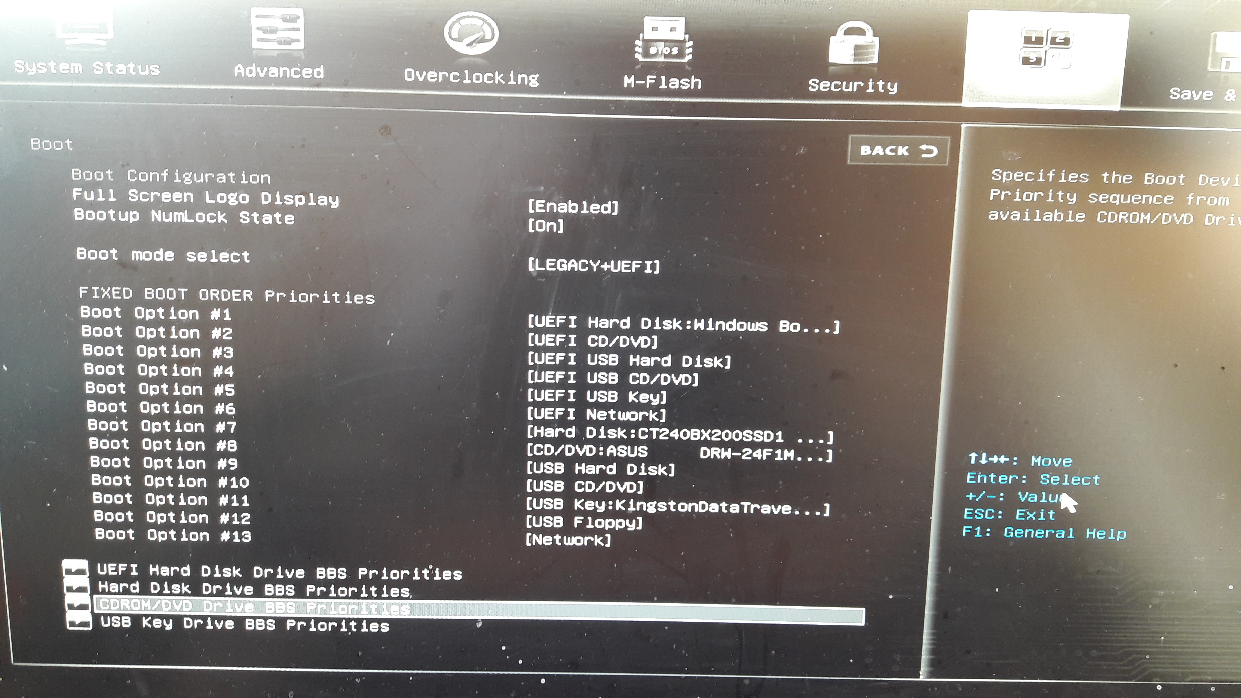

    You enter the BIOS of the motherboard (which model you did not provide for 23 posts) using DEL or F2 and change the boot order to USB on the Boot tab. You write CMOS with the F10 + ENTER key.
    You check the keyboard under linux.
    You describe the effect in words.
  • #25 17021954
    devilanq
    Posts: 17
    I gave it. msi h110M PRO-VD motherboard
    only if I have to enter the bios if the keyboard does not work for me; v
    Added after 8 [minutes]:
    Okay, I'm in the bios and where to change it in this tab? Genesis X66 Keyboard: Buttons Not Working & Text Issues for Pawel - Troubleshooting Advice

    You set it up so that the Kingston USB is at the top of the list. Then F10 + ENTER.
  • #29 17021993
    devilanq
    Posts: 17
    I have to write it down and turn on the computer again. Yes?
  • #30 17022020
    safbot1st
    Posts: 21951
    Help: 2719
    Rate: 1585
    Yes. After saving, it will reset itself.
