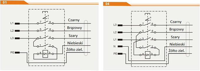

    I bought a new table saw with a 3-phase motor. The saw is equipped with a KOA7 (DZ08-3) 400V switch diagram of this switch below. The switch has a 5-pin power plug
    [/ Img]
    Metabo TKHS315C - How to properly connect to the old 4-wire network.
    In the garage, however, I have an old installation with 3 phases and a N cable
    I would like to advise you how to connect it so as not to break the engine.
    I am asking for advice.

    It is not allowed to make adapters from a 4-wire to a 5-wire installation. The socket should be replaced with a 5-pin socket and the PEN cable should be separated (or rather zero, because it probably is there). It's even cheaper.
    If devices with a 4-pin plug are also to be connected to the socket, then the adapter from the 5-pin to 4-pin socket can be made without problems (unless there are devices in the "bypass" that are converted by amateurs and require a PEN cable, which is not and was not allowed).

    soczi666 wrote:
    TN-C network
    So you have 3x L and a PEN cable.
    soczi666 wrote:
    I will buy a 5-pin plug, a piece of cable and a 4-pin socket.
    So how do you combine it?
    Leave this plug 5x that the manufacturer gave. Replace the socket with 5 x. Now it would be best if you exchanged this piece of cable from the socket to the socket if you can for 5 x. Deriving 3 x L and PE and N separately. And if you can't do it like the subject here.
    https://www.elektroda.pl/rtvforum/topic423870.html
    Here I quickly drew how to connect this socket.
