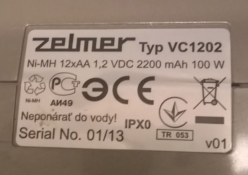

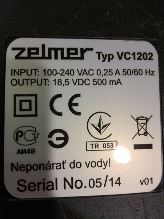

    I have found such a description - supposedly dedicated to this model:
    ZELMER CITO VC1202 Vacuum Cleaner: Battery Replacement, Substitute Options & Reset Cycle
    interestingly, below like two vacuum cleaners and labels themselves - the first one is mine, the other from another vacuum cleaner and here 12 AA is already written
    PS photo and description of the original set from the online store with household appliances:
    Was there a mistake in the description of AA?
