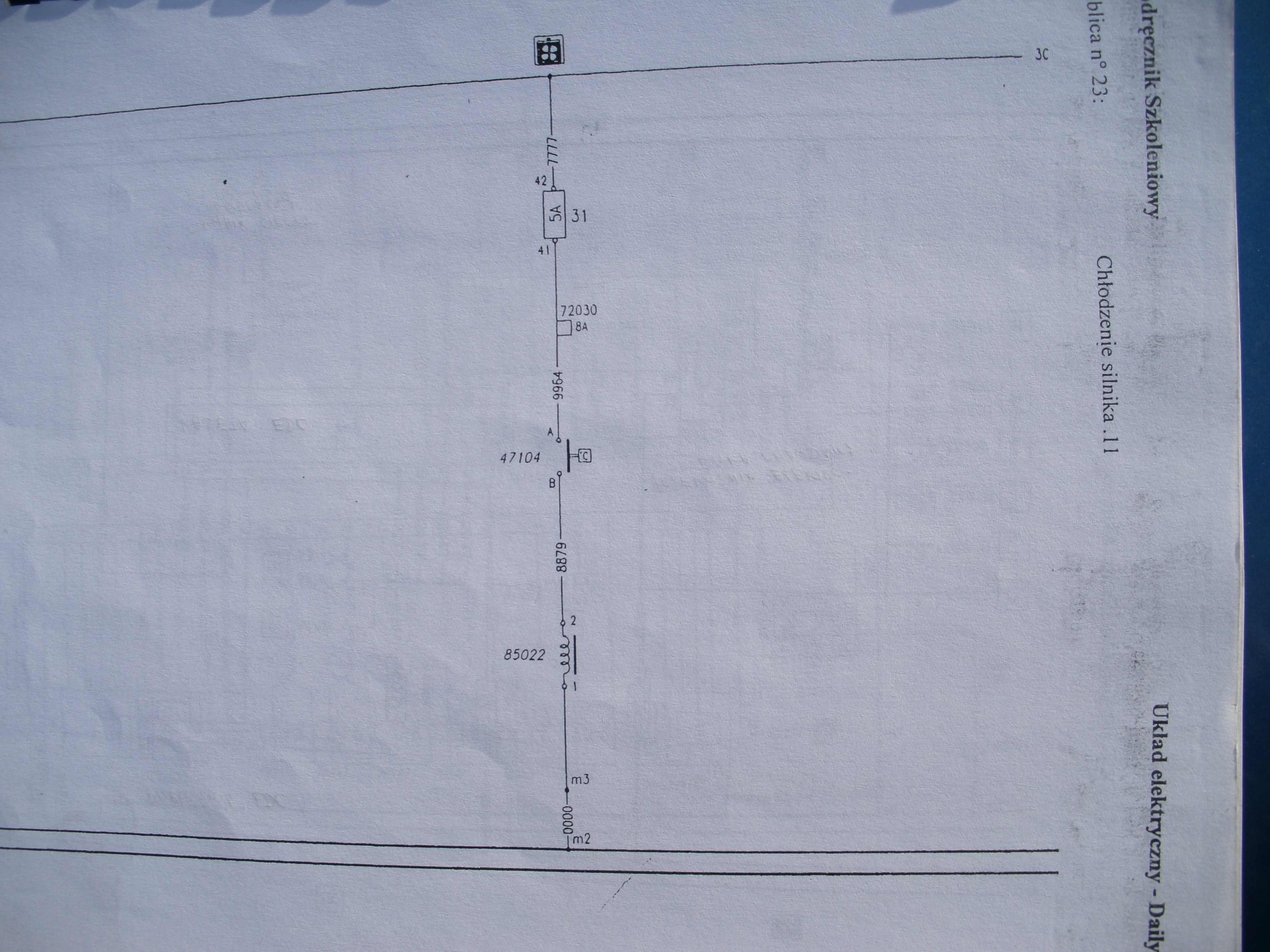

    Daily 2.8 35c11 106KM patient, ordinary pump, 2001 viscose not working. That is, the viscose is new, the temperature sensor in the radiator also does not turn it on. After connecting the pins in the sensor plug, there is no reaction, while after connecting the plus to the viscose, it turns on after firing the car, but after switching off it no longer disconnects.
    Does anyone have a diagram so as not to rip the entire installation?
    Or maybe it goes through some relay? In the fuse box there is no marking that one was from the fan. There is no computer here so everything should be on cables

    I doubt there would be a viscose, ordinary electromagnetic clutch for the radiator fan. Power supply from fuse 23 through the contact of the temperature sensor. radiator to the clutch, no relay. What voltage after a sensor short circuit looks like there is a power drop somewhere. Fuse center on foil with copper paths, after overheating there often drops in voltage.

    The image of the central unit and part of the diagram.
    • Iveco Daily 2.8 - Not working viscose, no power supply, diagram needed WENTYLATOR.JPG (28.74 KB) You must be logged in to download this attachment.
    • Iveco Daily 2.8 - Not working viscose, no power supply, diagram needed CENTRALKA DAILY.JPG (92.5 KB) You must be logged in to download this attachment.

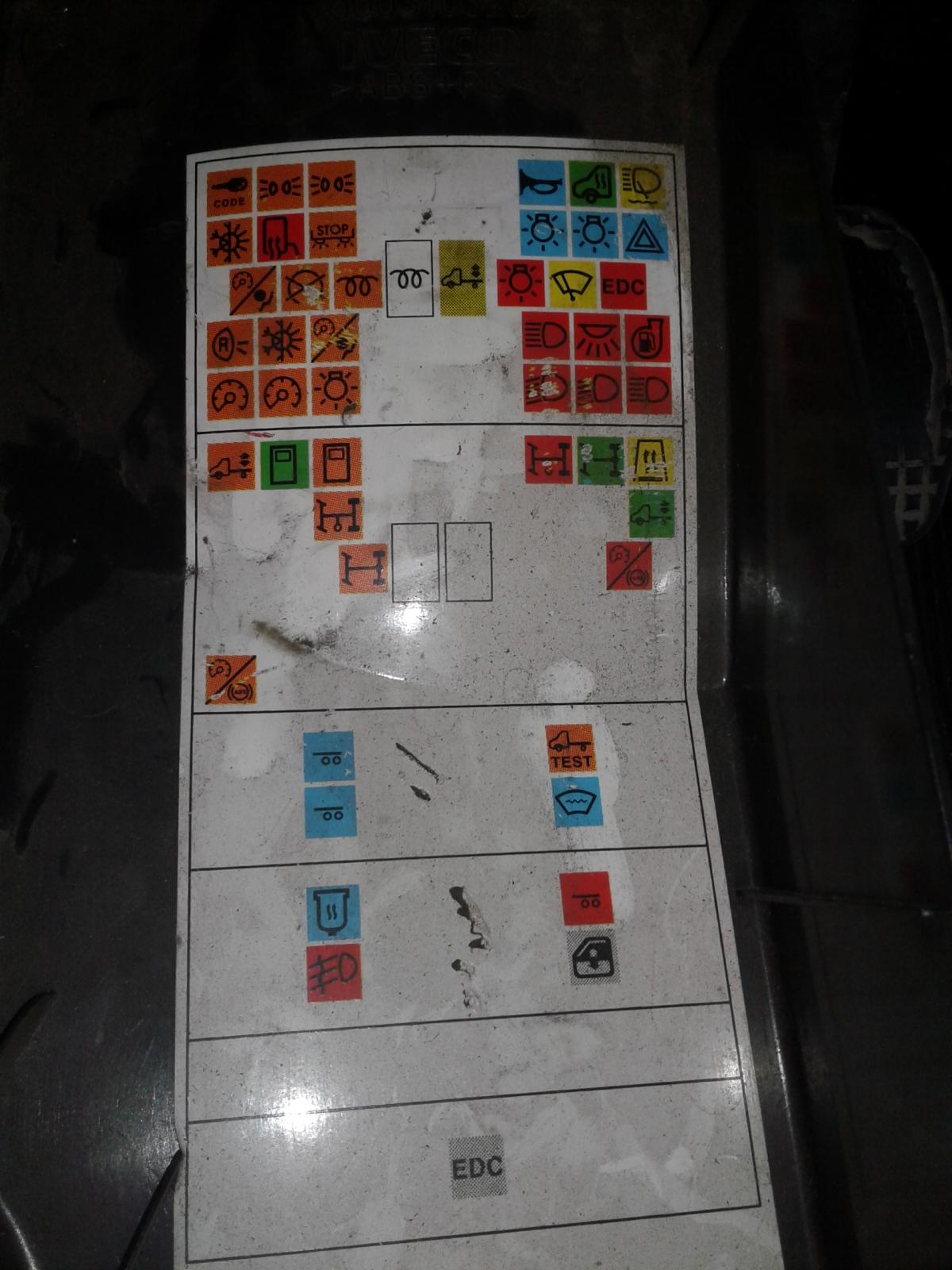

  • #5 17275085
    piorom3
    Posts: 18
    Rate: 12
    Well, we do not understand because in 2001 in my car the fuse board looks like this (maybe not so nice because not which pins are burnt at my place but I generally have one)

  • #6 17276334
    Hart3
    Level 26  
    Posts: 630
    Help: 100
    Rate: 479
    Daily II with such a board I met at the engine with the computer. Switching on the fan clutch via relay 25336 i.e. in your photo first from the bottom left. Power supply from fuse 31 i.e. from the bottom second row from the left. EDC version controls this computer. I checked, in C11 version without EDC, power supply from fuse 31 without relay.

    I give a real photo of my fuses, the problem with the type of plate may be due to the fact that I checked my car after VIN and it was the English version, the seller said nothing. For this reason, I bet that something is badly connected. The fuse is checked, the relay is also. After shorting the pins in the sensor plug, it does not switch on the solenoid. You will probably need to make a separate power supply from the relay installation, but which relay should be installed correctly?

    Well, so different things can be expected with such a guerrilla. You are wrong to inform that you have a relay, from the attached photo you can see that the socket is not planted, compare with the previous photo. This fact is not important because as I wrote in the 35C11 version, this relay does not have this relay. Your photo shows that the fuse is green first from the bottom left. Pay attention to the value of your fuses, totally overpriced. The colors of the pictograms should match the colors of the fuses. Despite my efforts, this is not much.

    Buddy in post 6 you have the relevant diagram, what is the problem of its reproduction. On the radiator you have a sensor, supply power to it and connect the output with the fan clutch. Simple?

    The sensor in the radiator is designed for direct switching, without the need for a relay. To cover the topic you do not need electronics, the topic with your knowledge should be in the beginners section. Please send it to an electrician and a moderator please close the topic.

    I took care of the subject myself, the sensor receives power, while somewhere the rest of the installation was mixed up, I connected the plug to the solenoid with mass and power from the sensor with a 5A fuse, everything works as it should, the temperature does not go over 90 degrees :)
