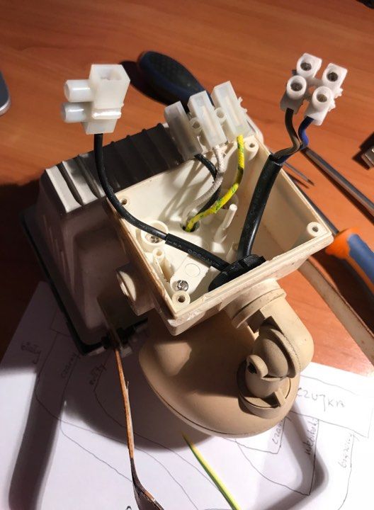

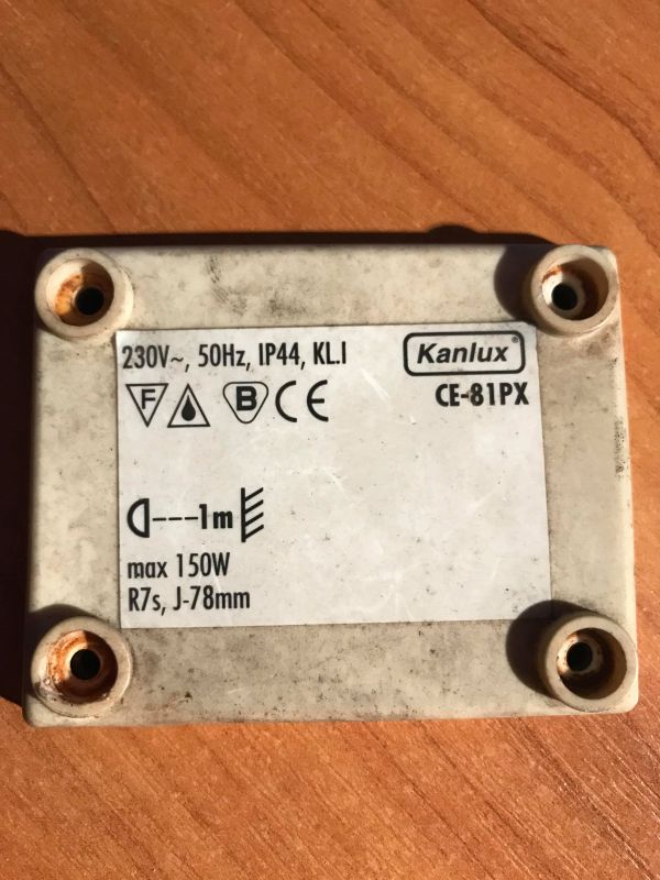

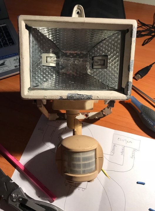

    I would like to connect a halogen with a motion sensor and a two-stage switch so that it works as follows:
    1) The lamp is lit continuously by switching on the first button on the switch.
    2) The lamp does not light at all (both buttons on the switch are off).
    3) The lamp is on for a specified time when the sensor detects movement - this mode is turned on by pressing the second button on the switch.
    Do you have an idea how to connect it? It looks like this:
    - lamp: white, black, yellow-green wire,
    - motion detector: the black wire enters on one side, two brown wires come out and the blue one on the other.
    Thank you in advance for your answer,
    best regards!
    Rather, the brown and blue are the detector input / power supply.
    Black is the output / control of the receiver / lamp.
    ad1. From the detector power supply, the "L" wire to the switch and then to the lamp.
    ad2. You connect the "L" detector power supply through the second switch, cutting off the power to the detector and the lamp.
    ad3. The first switch is disconnected, the second is closed, the detector is working.

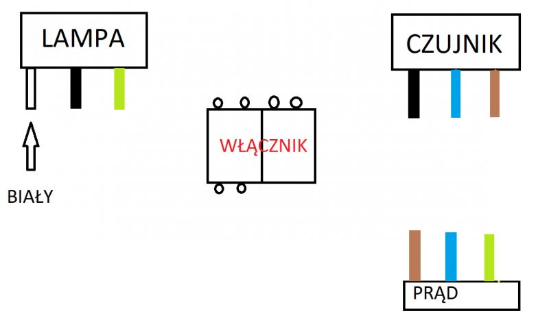

    jakubek56 wrote:
    The first switch would apply power directly to the bulb, and the second, through a sensor, to the bulb.
    Not exactly as you write.
    Provisional drawing. Kanlux CE-81PX: Connecting Halogen Lamp with Motion Sensor and Two-Stage Switch

    The switch power supply cannot be connected by the switch that enables the lamp operation by the sensor.
  • #6 17046291
    p4w3llo
    Posts: 8
    Hmm, excuse me but I'm not very smart about these things, could someone show me this on this makeshift diagram?

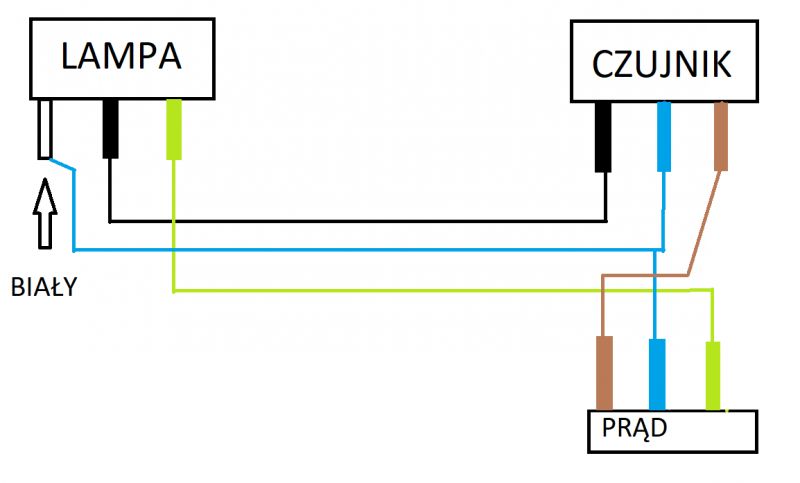

    mawerix123 wrote:
    How are the wires connected in the motion sensor :?:
    In order for the lamp to work with a motion sensor, it must be connected as follows:
    #12 17046608
    mawerix123
    Posts: 4150
    Help: 482
    Rate: 951
    p4w3llo wrote:
    In order for the lamp to work with the motion sensor it must be connected as follows
    Oh
    So that it works as you intend in the double staircase
    It can be combined like this

    I also have a question: what will happen when both keys are on with this connection? Will it cause some failure?
  • #14 17046837
    mawerix123
    Posts: 4150
    Help: 482
    Rate: 951
    It is just that the lamp will be on constantly, no failure will occur.
