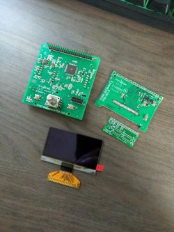

  • #369 18972300
    tom_boy80
    First of all, thank you very much for the great work.
    I assembled three of the boards from j4rek, the first one works perfectly and unfortunately I can't find the fault with the other two.
    With the second I only get "snow" (see picture) and the third flashes briefly with the correct display and is then immediately dark again.
    Maybe someone has an idea what that could be.
    Thank you and best regards
    Tom

  • #371 18972751
    amigos
    Posts: 309
    Rate: 131
    In particular, which version did you use, the entire board or the simplified version? Check carefully the pin connections between the boards on the 20-pin connector. Very often, when desoldering, the vias in the holes fall off and gaps appear between the soldering rings and the tracks. Later soldering only on one side, the tin does not connect the tracks on the other side of the PCB.
    And check if you have a short circuit on the display tape. Did you mix up something while soldering? There is practically no philosophy in soldering the display. Well, unless you inserted the connector instead of soldering it in contact with the tape, look for problems in the connector itself. Many people have problems soldering a connector, e.g. 30 or 32 pin, and the tape hits the pins badly. In addition, the display soldering points themselves are not adapted to such a connector. The tape is too thin and it happens differently with this contact. Give photos from the electronics side.

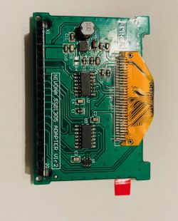

  • #372 18974373
    dekRe
    Posts: 205
    Help: 12
    Rate: 18
    In my Nivon, the display went out, so I brought OLED 1305 and made an adapter according to v2 J4rek. The first adapter installed in my coffee machine works perfectly with the new OLED - a big thank you to the forum team for this project.
    I imported a second identical coffee machine from Germany from Ebay - according to the description that sells only display defect, so hopefully I made a second module and installed it.
    How do I connect my first repaired working display to this machine bought from Germany - it displays, but the system shows an error in German: "Aufschäumer einsetzen" {???} - and I'm stuck here, but I have to disassemble it. I moved the coffee and milk outlet from my machine - this is not the source of the problem. The German woman swears that the coffee machine was working until the end, but only the display was dead.
    I decided to repair the second display, from this machine bought in Germany, to start the repair somewhere - and here it is a failure. After replacing the OLED display, soldering and installing - nothing lights up - the display is dead as at the beginning, as if it was not getting power.
    Is there a way to test the power line to be able to take some measurements, or where does the power line begin to find something on the break - now it's as if the display is not getting power or the motherboard is dead. What is the supply voltage for this module?

    dekRe
    Posts: 205
    Help: 12
    Rate: 18
    I would like to thank the user of Rosenkopf and Amigos - thanks to you today I regained my humor. In fact, the whole secret of this mystery of mine was only that the front cover of the frother actually has a magnet, and if you do not put on the plastic front panel with the magnet embedded in it, the coffee machine will not start. Thank you very much.
    For now, I have dismantled the inoperative display module into the first parts. I would like the ATMEGA324PA chip not to be damaged, because you can buy it, but I am afraid that it is a programmable chip and without getting a batch, the module may turn out to be beyond repair. This motherboard also has a 3.3V stabilizer and one transistor.
    So I will check all the tracks, then the guides - and we'll see if this module moves.
    My advice is also this - if you buy some parts for repair, you should buy a comb of this height (although it would be more convenient) with pins. It seems to be a much easier job of cutting the original pins and desoldering them one at a time than all of them - there is less chance of damaging tight solder pads and the thin tracks going to them.
  • #376 18976673
    tom_boy80
    amigos wrote:
    Which version did you use, the full board or the simplified version? [...] Please show photos from the side of the components.
    Green printed circuit board with visible electronic components and an edge connector.

    tom_boy80 wrote:
    amigos wrote:
    which version did you use, the whole tile or this simplified version? [...] Give photos from the electronics side.
    I see you've put the pcb on ebay - so I understand you're done ;) What was wrong? What was the problem?

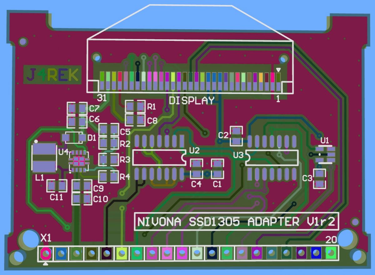

  • #379 18984844
    dekRe
    Posts: 205
    Help: 12
    Rate: 18
    Unfortunately, the second attempt - I did not manage to start the module with the adapter - I dismantled and reassembled it very carefully - dead.
    So I would like to assemble such a full control module for OLED according to the J4rek rev.2 project.
    I would just like to clarify the issue of the elements - please check if I wrote it down correctly from the diagram:
    NIVONA MODULE J4rek for 1305 display - version: full PCB, as in the attachment:
    SMD BOM LIST:
    L1 - 10uH SMD wire choke 10uH 0.4A 560mR 4.5x3.2mm H = 1.5mm
    D1 - MBR0530 Shotki diode 30V 0.5A
    C1 - 4u7 / 16V
    C6 - 4u7 / 16V
    C7 - 4u7 / 16V
    C8 - 4u7 / 16V
    C10 - 4u7 / 16V
    C11 - 4u7 / 16V
    C2 - 100nF / 16V
    C3 - 100nF / 16V
    C4 - 100nF / 16V
    C9 - 100nF / 16V
    C5 - 22pF
    R1 - 1M
    R2 - 1M
    R3 - 120K
    U1 - SN74AHC1G00DBVR
    U2 - CD4071B
    U3 - CD4078B
    TPS61045 TPS61045DRBR QFN-8 Chipset IC REG BOOST ADJ 0.3A, LED driver, 1 output, boost (step up), 1.8V-6V input, 1MHz switching, 28V / 20mA output
    I just started my adventure with SMD .
    1.
    I have a very lame question about the size of the SMD components needed for this PCB - elements should be 0603 or 0805 size ? The size 1206 capacitors I bought turned out to be a bit too big and not very convenient to solder in the fields.
    I left the integrated circuits and OLED display from the experiment with a small adapter, I miss C5 - 22pF, R1 - 1M, R2 - 1M, R3 - 120K, I will sell the rest.
    2.
    The last question - does anyone have one or two bare laminates of the full PCB J4rek rev. 2 and can help me and resell at cost, possibly with these missing SMD C5, R1, R2, R3 components? Or maybe a damaged NIVONA display module with a working motherboard for little money, so that it does not lie in a drawer and help me revive my Nivona?
    Schematic of J4rek printed PCB module for display.
  • #380 18986187
    j4rek
    Level 19  
    Posts: 369
    Help: 8
    Rate: 103
    The R, C elements are in size 0805. The full designation for U2 and U3 is CD4071BM
    and CD4078BM.
  • #381 18988545
    tom_boy80
    amigos wrote:
    I see you set the boards on ebay - so I understand you are done ;) What was wrong? What was the problem?
    Didn't look any further for the error and reordered U1, U2, U3, TPS and replaced them. I re-soldered the other components with flux, probably a component (U1-U3) got too much heat during soldering.
    Thanks again for your help and the great project.

    melse
    Posts: 12
    Rate: 37
    I had the same problem once, if I rememeber correctly is was bad soldering of the TPS component in my case.

  • #389 19151841
    petermdevries
    Hi,
    Thanks to this topic I tried to replace the display of my Nivona. I used Jareks design v21 and after a short test I thought everything worked. However now I assembled my Nivona to run some more tests the display seems to be unstable. I see some “artifacts” and sometimes it switches upside down. Anyone an idea what could be the problem of this? Bad soldering? Other things to check?
    https://youtu.be/zPdoqHddAqU

  1. Measure VCC at JP1 pins 1-2; it must be 3.3 V.
  2. Check boost output at C4/C10; expect ~12 V.
  3. Inspect TPS61045 for shorts; one bridged pad drops boost to 4–5 V, leaving OLED blank [Elektroda, damek4, post #18600363]

Can I reuse the old boost inductor and diode?
Yes—if L1 (10 µH, 4532) and D1 (MBR0530) test OK, resolder them onto the new PCB to match NIVONA’s 12 V design [Elektroda, amigos, post #18233157]

  1. Unsnap front fascia, desolder 31-pin ribbon, lift old SSD1303 OLED.
  2. Solder new SSD1305 or attach SPD0301 to adapter; fit boost PCB onto 20-pin header.
  3. Bridge D0 (pin 7) per schematic, reassemble, set clock.

Reflow TPS61045 and check R4 (set to 120 kΩ). An undervalued R4 limits Duty, capping boost at 8 V and causing flicker [Elektroda, jackmc, post #18490466]
