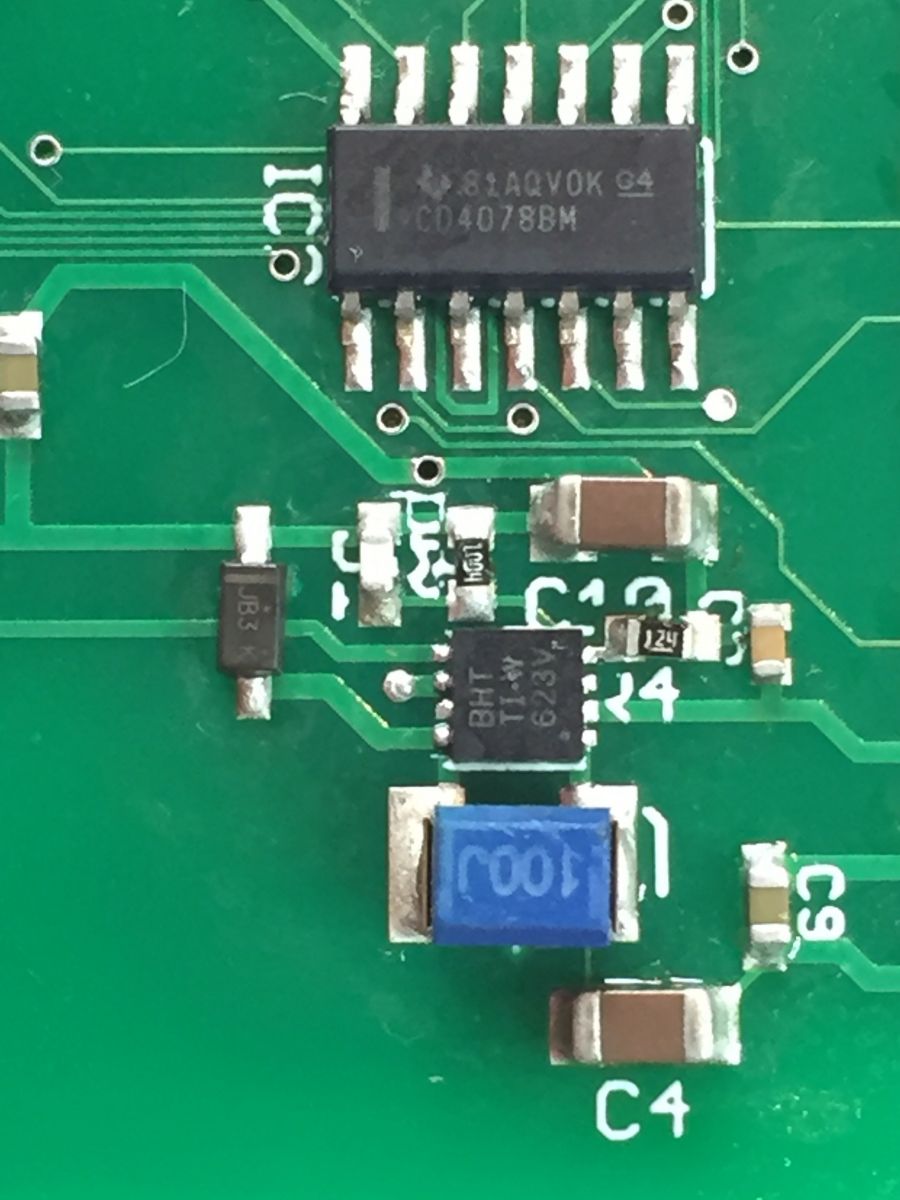

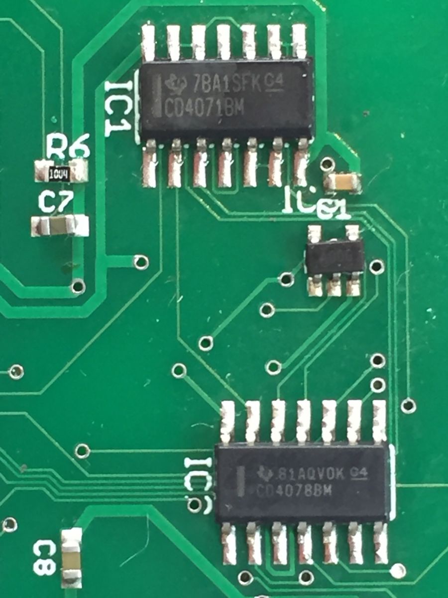

    I converted the TPS chip and now the screen is black. I measured the output voltage and it is 4.9V, I could damage the display.
    Close-up of a circuit board with a TPS unit and electronic components after soldering.
  • #302 18600451
    amigos
    Posts: 309
    Rate: 131
    How did you solder? I don't know what your soldering skills are. To be honest, for me these elements on the plate look terrible. Wash it from the flux to see something :) Check whether there are short circuits between the TPS legs, because often under the system, if you give too much tin before soldering, a short circuit may arise with inefficient soldering. You will have a short circuit between legs 6 and 7 and 1 and 8 with the coil mounted. If you were warming up with a hotair, I hope you have peeled off the display, because if you heat it too much, the display will fall. You will see it after discoloration. If you have a weak soldering, give someone to do it, because you need some skills for TPS.

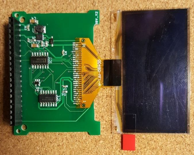

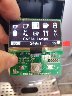

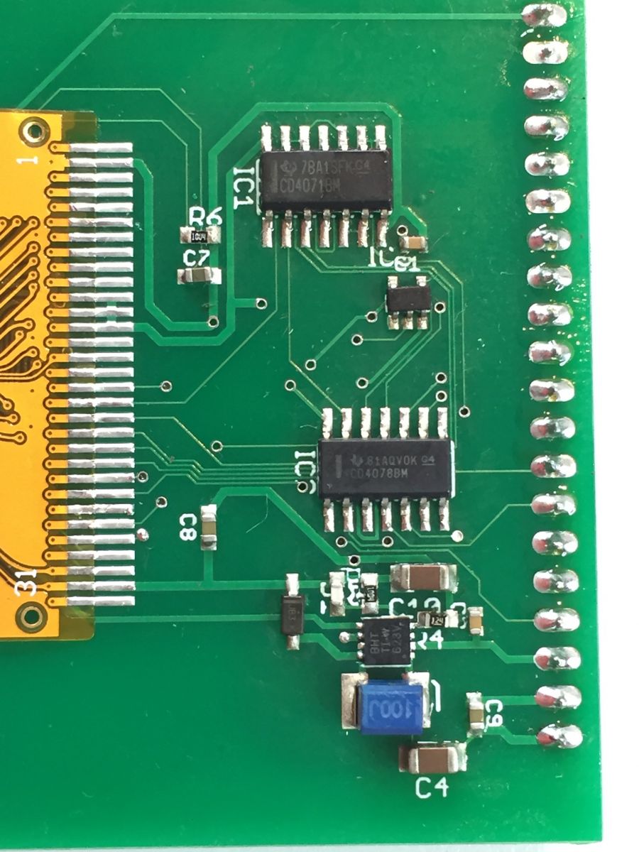

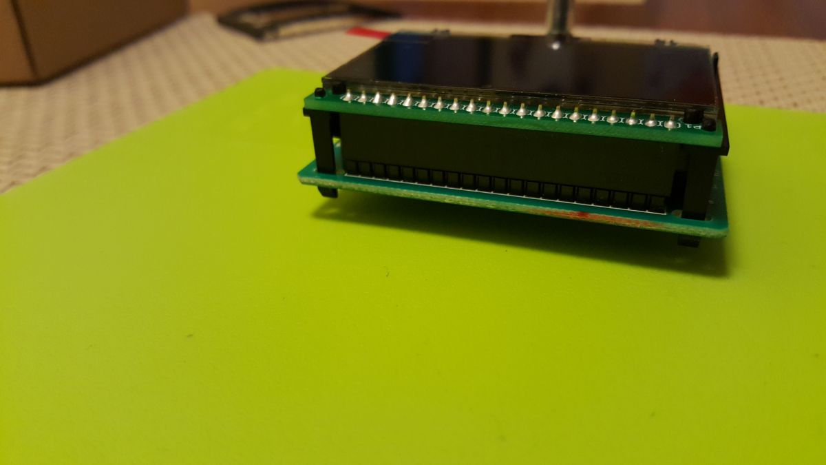

    I received the tiles according to the J4rek design and finally found time to test the variant without TPS. For me a revelation, everything goes without a problem. Below photos.
    It is known that the board must be desoldered on a 20-pin connector from the control board to be able to desolder the old display and solder the new one. Move the plastic bridge connecting the pins as high as possible and bend pins 5 and 7 to fit the holes in the J4rek board. Slide the board onto the pins and solder also soldering 2 missing pins to the controller board. Cut out protruding elements and solder the whole joint in its place. Display ready ;) As a capacitor C1 I gave 4.7uF, and as C2 and C3 I gave 100nF. I haven't tested the TPS board yet.
    NIVONA Caferomatica 830 Coffee Machine: Damaged Display Repair, AliExpress Replacement NIVONA Caferomatica 830 Coffee Machine: Damaged Display Repair, AliExpress Replacement NIVONA Caferomatica 830 Coffee Machine: Damaged Display Repair, AliExpress Replacement NIVONA Caferomatica 830 Coffee Machine: Damaged Display Repair, AliExpress Replacement NIVONA Caferomatica 830 Coffee Machine: Damaged Display Repair, AliExpress Replacement

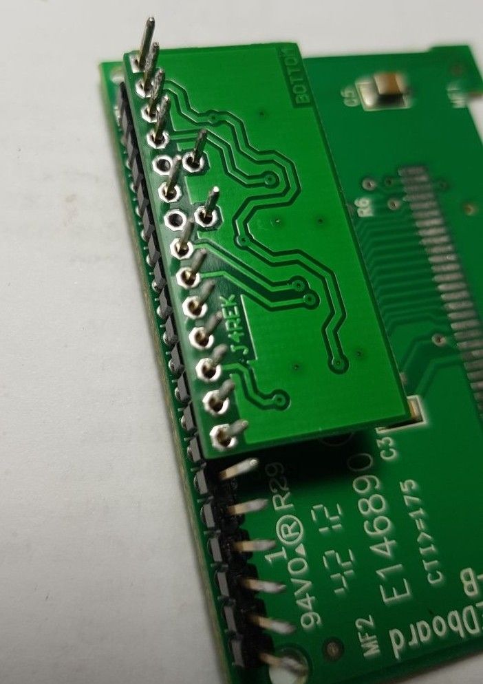

  • #308 18635016
    j4rek
    Level 19  
    Posts: 370
    Help: 8
    Rate: 103
    Hello, it's great that the design has been checked and works properly. C1, C2, C3 can all be 100nF.
    I have a faster (maybe less aesthetic) way to disassemble both tiles - cut the original ladder 'pin by pin' with sharp cutters in about half the length.
    We unfold the plates and replace the display with a new, cut pin 5 and 7 from the display plate remove and clean their assembly points. You can also slightly shorten these pins and solder to them after folding the wires from points X1.5 and X1.7.
    I need to solder 2 longer pins / wires of silverware (to X1.5 and X1.7) into my plate, properly shaped so that after applying and soldering they fit nicely into the exact upper plate with the display. After assembling the whole, we solder the breaks created when cutting the ladders and soldering points 5 and 7 on the display board.

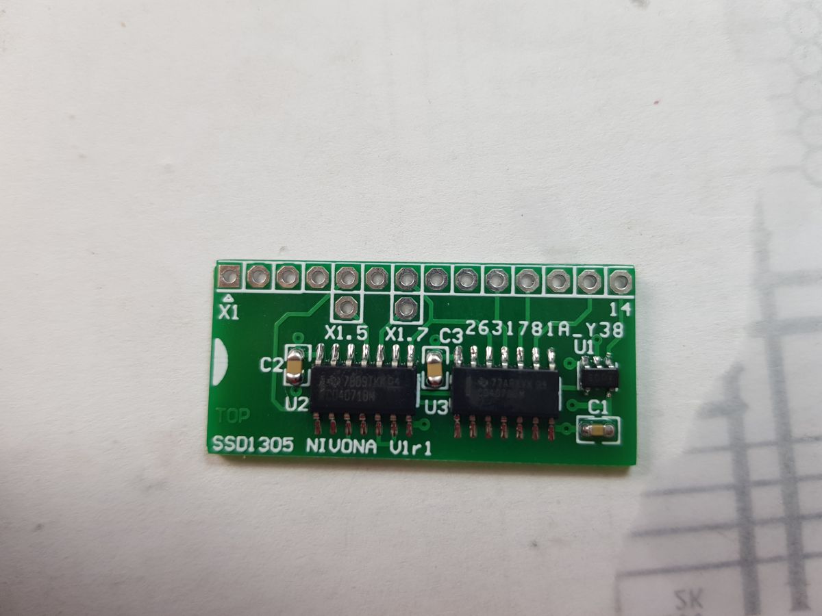

  • #309 18635792
    j4rek
    Level 19  
    Posts: 370
    Help: 8
    Rate: 103

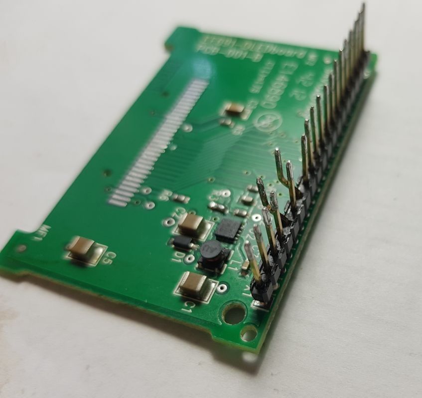

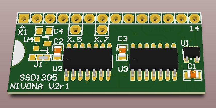

    I place a newer version of the board (V2r1)
    - the previous arrangement of connections in the gates has been restored (this has been verified, however, this does not affect the operation)
    - the option of mounting the LDO 3V3 stabilizer (U4) powered from Vbat has been added
    - on the left side is marked and drilled area, which after breaking should allow to bypass the dowel from the black base
    View of SSD1305 NIVONA V2r1 PCB with electronic components.
    Diagram and gerberas attached.

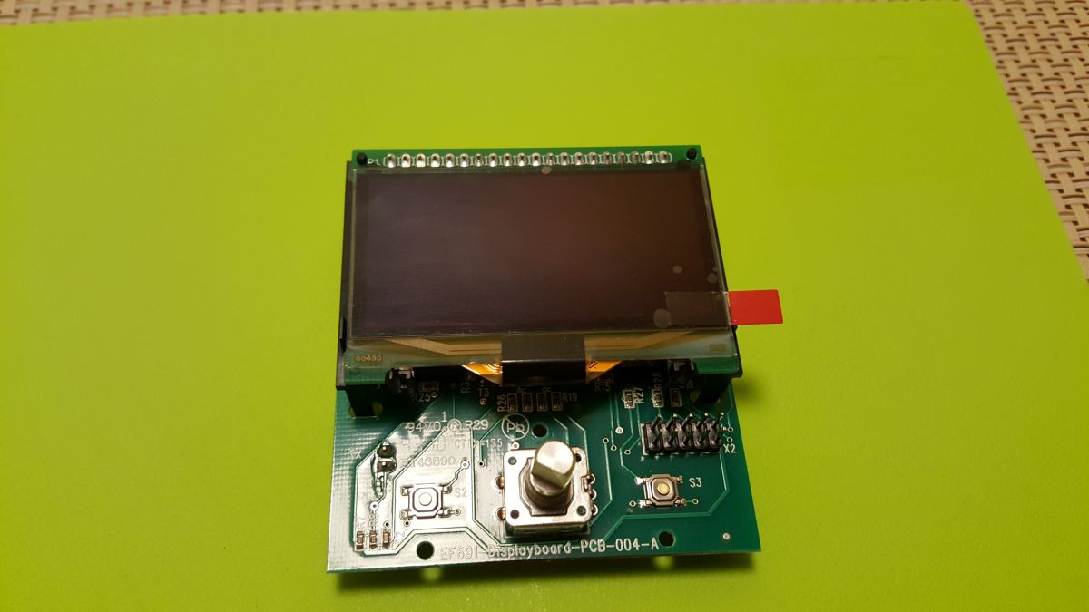

    Somehow it is easier for me to solder in this way
    Close-up of a green circuit board with soldered pins. Circuit board with soldered pins and visible traces.

    The J4rka solution looks brilliantly simple - congratulations, so when it works with SSD1305 in addition - it's a design revelation and full of professionalism!
    I only have questions
    1. JP1 jumper with 2.7V and 3.3V voltage selection - what should be the voltage selection for SSD1305 - or are there SSD1305 with different voltages?
    2. I prefer to be sure just in case, so I will ask here - if the CD4078BM DIGITAL BILATERAL SWITCH SOP-14 E4702
    or from the same seller the second system marked as CD4078BM DIGITAL NOR CMOS SOP-14 E4701
    are the same systems as the CD4078B NOR / OR marked on the diagram and can be used interchangeably in this project?
    Thank you for this project and best regards
  • #314 18652585
    j4rek
    Level 19  
    Posts: 370
    Help: 8
    Rate: 103
    1. By default, you set the jumper on 2V7, and U4 and C4 are unnecessary. This is an option as if the systems have a problem with stability at 2.7V power supply. Theoretically, according to the documentation, they have a minimum 3V guaranteed.
    2. The most important designation is CD4078BM. Generally, the system has the designation CD4078B, and the letter M at the end indicates only the type of housing (SOP-14).

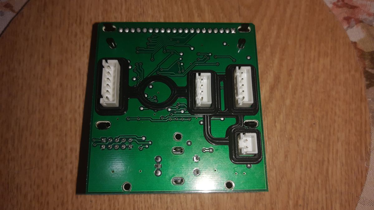

    Hello high class specialists :)
    At the beginning I wanted to announce that it is quite pleasant to read here :)
    I allowed myself to write here because many specialists follow the thread. To the point. In my new used 831 the display fell, but in a very strange way. First there was a problem with making latte, after a few coffees error 9, a few minutes off and continued to work. When such a mistake appeared more often, I once gently tapped the mobile terminal and then everything went on. The guest from whom I bought said to remove the module, remove the plugs and insert again. I did it, put it together, turned it on, made coffee, I say okay. After next switching on it was a standard screen, then before I could choose anything, it turned 180 degrees and everything disappeared, no reaction to the buttons. After switching off and on with the on / off switch on the side, nothing appeared on the screen anymore, no reaction to the on button at the top. I have to understand that the display module to be replaced? I will add that only after switching on you can hear the sound of the power supply inside and that's it.
    The second thing, apparently the screen was replaced recently ... should this be what solder connections should look like after replacement? It looks like a factory to me ...

    Damage to these displays is mainly manifested as burnout - poor visibility, and your fault is rather some errors in the driver or communication between components. It is possible that there is some cold solder in the display module (pcb with microprocessor). It is advisable to replace it with another module to exclude it.
    For model 831 I found a description of error 9 (translated from German):
    Meaning: Engine valve error, device malfunction.
    Cause: Damaged drive motor valve, valve not in (zero) position.
    Source:
    https://www.jura-ersatzteile-shop.de/document...ce_Anleitungen/Hinweise/nivona-error-code.pdf

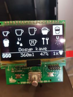

    mjdob

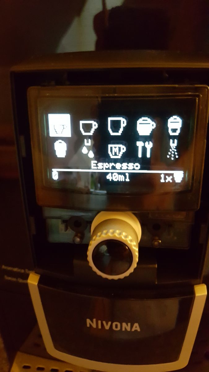

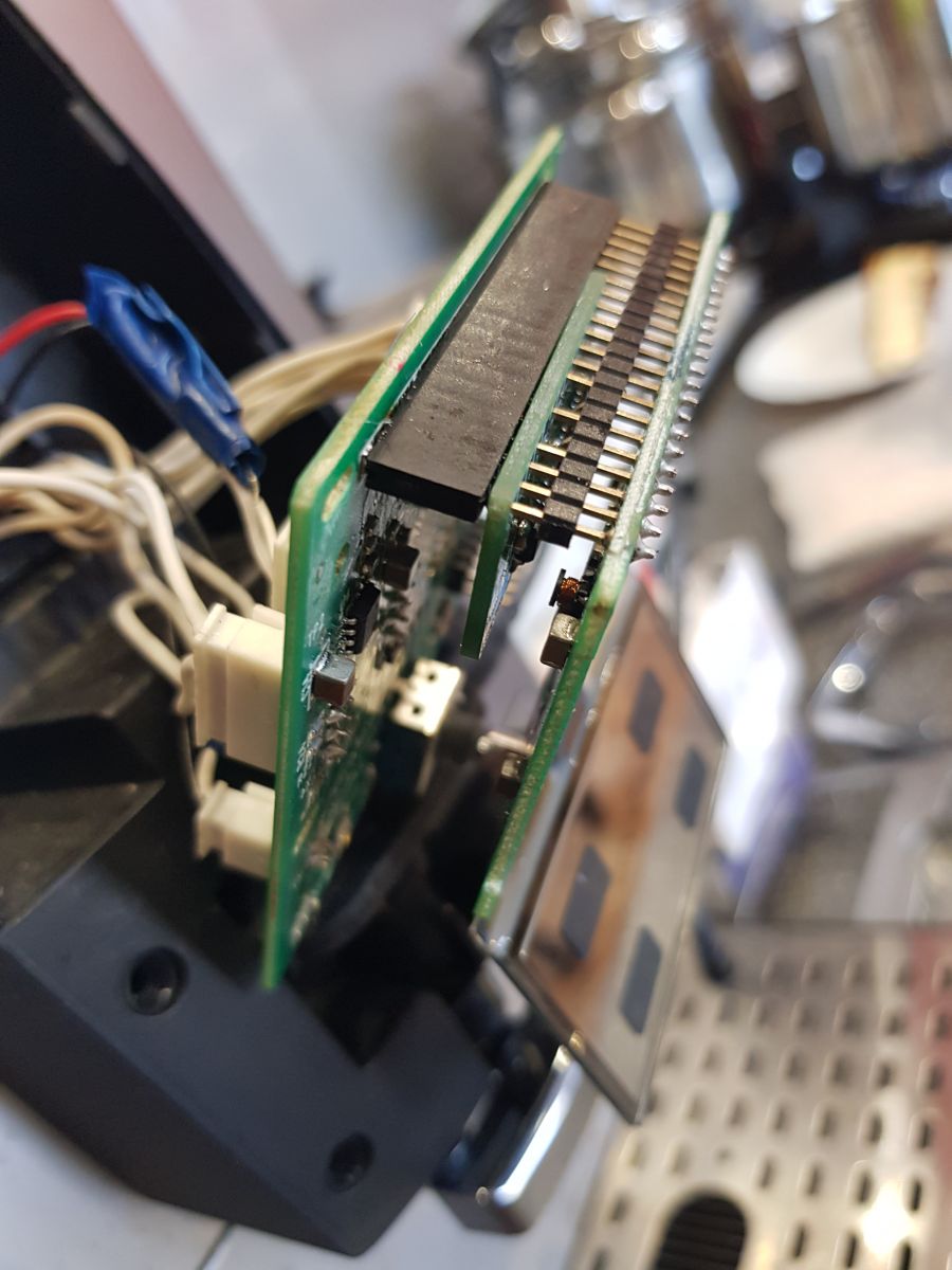

    I would like to begin by thanking the authors of the solutions saving the display module for their work input and sharing projects with other users. First of all, my thanks go to amigos, because it was on his design that I carried out the display replacement. Probably soldering could always be a bit nicer, but the screen fired without any corrections and glows, it's nice. The tile was perfectly matched, entered the factory place on the stand and looks like the original. I left the pin connector original, while I soldered the socket into the display board (in case of disassembly and making corrections). Fortunately, there were no corrections, and the female pin connector fits perfectly in height. The whole looks like the pictures. Amigos, thank you very much again.
    Electronic board with a display module after installation A circuit board with integrated circuits and a pin header on a cork surface. Shown is a display module mounted on a PCB with a green background. Close-up of a display module mounted on a green connector board. Display of a Nivona coffee machine showing the menu and selection of 40 ml espresso.

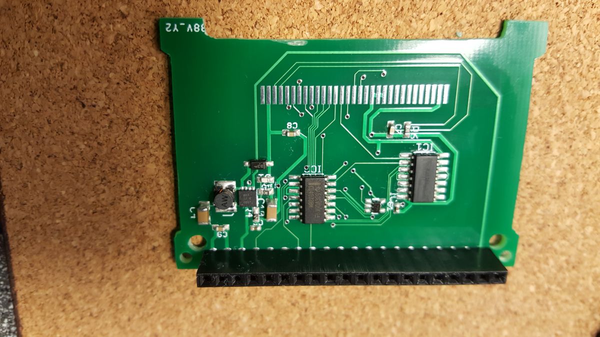

    volkeri

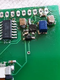

    Hello everyone,
    I soldered three circuit boards and none of them worked. I do not know what I'm doing wrong.
    I have inserted the pictures of the last board.
    Where can I measure something?
