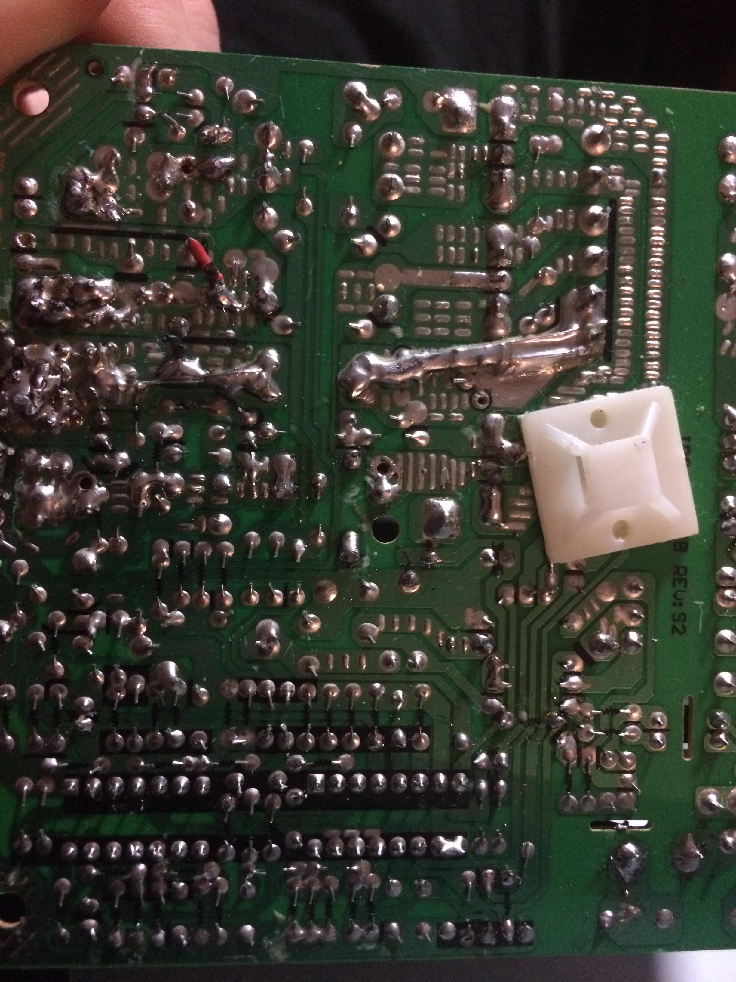

    I just stripped the skayga and my eyes showed these soldering ???
    • Assessing the Quality and Performance of Akyga AK-B1-500 Power Supply Model image.jpg (737.41 KB) You must be logged in to download this attachment.
  • #11 17068528
    pawelr98
    Posts: 6464
    Help: 413
    Rate: 1155
    The picture clearly shows how these power supplies are made.
    In the first post a colleague wrote that he is going to take it apart.
    This is the best application for this power supply.
    A colleague will have high voltage transistors, a handful of low and high power diodes, integrated circuits (operational amplifiers are added), coils and transformers, and other elements useful in building your own systems.
    Luckily, your colleague will have enough elements to build a simple workshop (linear) power supply.
