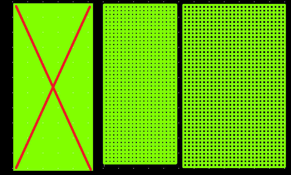

  • #16 18564935
    Bluzman
    Level 4  
    Posts: 111
    I will refresh the topic. I have a Samsung Xpress M2022W, I have not done PCB prints yet, but maybe someone has such a printer or one of this line and printed PCB paths? I saw how it is printed on a black surface, e.g. a filled square on plain paper. It does not impress much. It's a printer that's more meant for text.
  • #17 18566198
    Jacek Rutkowski
    Level 28  
    Posts: 1330
    Help: 69
    Rate: 275
    Is the print blacker at the edges than at the center?
    This is one way to save toner and you need to turn it off for pcb making.
  • #18 18578270
    Bluzman
    Level 4  
    Posts: 111
    Maybe not so much as blacker and with a uniform background it can not fill everything perfectly. There are such white lines - "mijaki". I have now printed a small project (8 cm x 4 cm) on plain paper, there is nothing disturbing. I am afraid that there may be a problem with larger tiles. We will see.
  • #19 18587560
    Jacek Rutkowski
    Level 28  
    Posts: 1330
    Help: 69
    Rate: 275
    Generally, printers are less able to handle large surfaces. If you want to pour a mass, it is better to use a fine path mesh than one large mass. The toner coverage will be much better and the pickling problem solved.
    Best PCB Printer for Thermal Transfer 2018: Current Recommendations & New Models on the Market
  • #20 18600053
    Bluzman
    Level 4  
    Posts: 111
    I tested this printer by printing a large mass. As you wrote - a grid of paths. I believe that this version is better. In the version with the mass, I "poured" it on the printout, after pressing it into the water with dishwashing liquid so that it lay down for a while and the chalky paper went away nicely. The paper went away by itself in a moment and the mass crumbled a little where there was more filling - it left the paper and the plate. I don't know if I kicked the ironing, come on I tried to do exactly that, maybe a little too long. It etched perfectly.
    Technical acetone wiped the toner from the tracks. It came off nicely, but a lot of toner was left on the plate because it smeared when cleaning - how dirty it looks :) It works.
