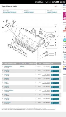

  • #6 17360546
    rustin
    Posts: 673
    Rate: 137
    The description shows that we have the same egr, the tube you are talking about is the No. 4?
    Metal what goes into the intake manifold from egra? If so, I cleaned it and unfortunately it did not help. Fiat Fiorino 1.3 JTD 2012 - Persistent Blue Smoke and Pungent Exhaust Smell Post Firing
