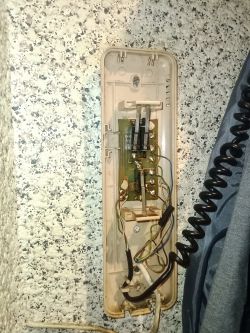

  • #31 20192373
    Spejsonek

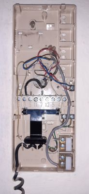

    How to connect it ??
    Connecting & Replacing Old Intercom with Cyfral Smart 5p: Wiring & Troubleshooting Help Connecting & Replacing Old Intercom with Cyfral Smart 5p: Wiring & Troubleshooting Help
  • #32 20192660
    zybex
    Helpful for users
    Posts: 15919
    Help: 2094
    Rate: 2939
    The old one has faint colors. From what I can tell from the top there are white, blue, green, gray, yellow and brown in sequence. Verify them. In any case, from the top you have:
    microphone - MIC
    mass - MASS
    handset - SPK
    call - RING
    button - SW1
    button - SW2
    Jumpers according to the instructions.

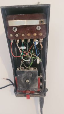

  • #33 20321034
    McCabe33

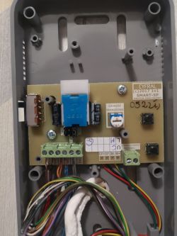

    Sorry Zybex but I am utterly stumped. Can't figure this out. The old model in the pic is a LT Terraneo and we are in Italy if that makes a difference?

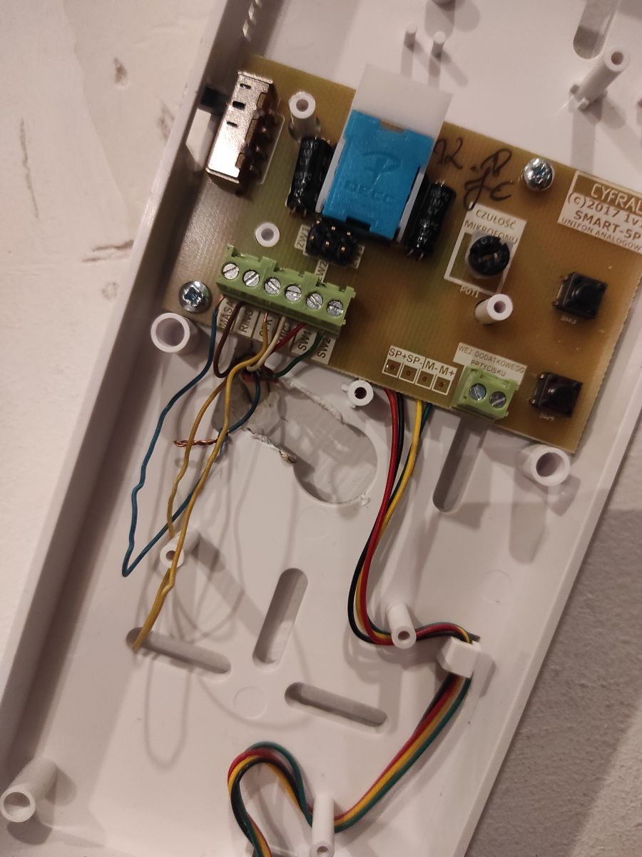

    Gentlemen, the problem is that the old intercom was connected to two wires, the plus was yellow, the minus was blue, I have 8 wires at my disposal, yellow, blue, white, brown, black, red, green and orange, how to handle it all, I found one diagram, I connected it as in the picture, you can hear crackling in the handset, and yet you can't hear anything when someone calls downstairs Connecting & Replacing Old Intercom with Cyfral Smart 5p: Wiring & Troubleshooting Help

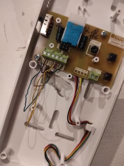

    Can someone help me how to connect the cables to the new Cyfral 5P?

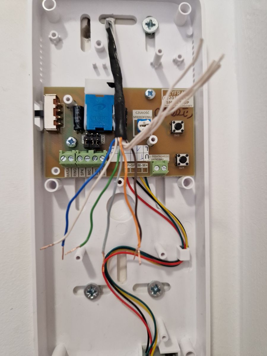

    Good morning.

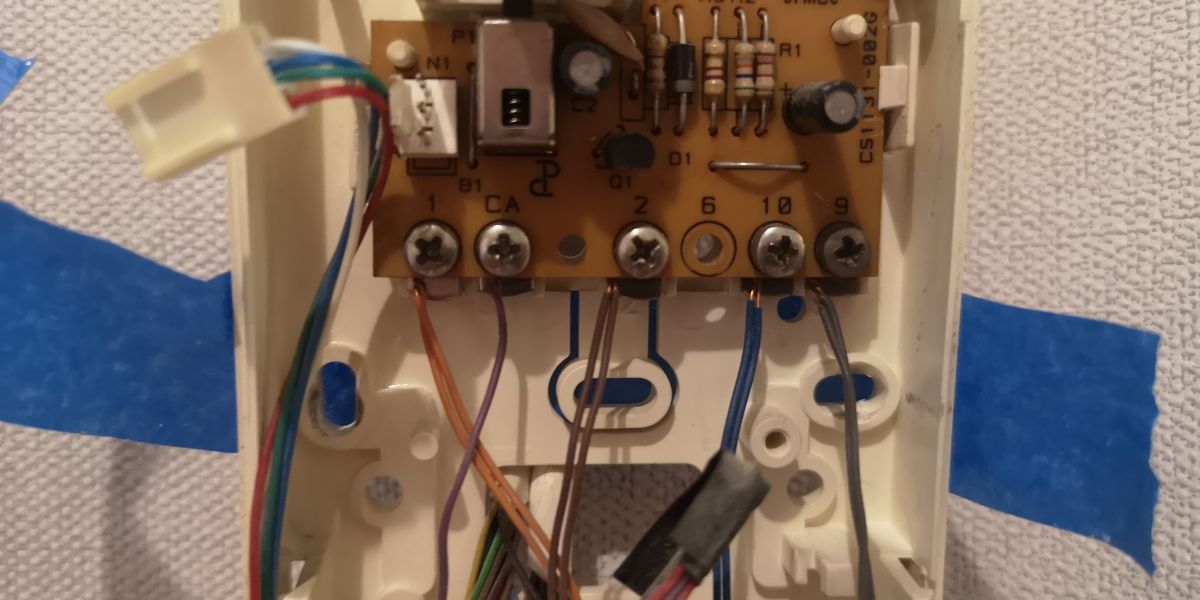

    I would like to ask you for help in connecting the intercom in the block, the first photo is the old intercom, the unassembled Urmet Uniphone, and the second is the new Cyfral 5P intercom. Connecting & Replacing Old Intercom with Cyfral Smart 5p: Wiring & Troubleshooting Help Please advise which color to connect to the new intercom from the left. Thank you Connecting & Replacing Old Intercom with Cyfral Smart 5p: Wiring & Troubleshooting Help

    zybex
    Helpful for users
    Posts: 15919
    Help: 2094
    Rate: 2939
    1 - handset (SPK) - 2 orange
    CA - call (RING) - purple
    2 - microphone (MIC) - 2 brown
    10 - mass (MAS) - 2 blue
    9 - button (SW1) - 2 gray
    The ZW3 jumper is to be installed, the other jumpers are to be removed (ZW1 and ZW2).
    In parentheses I have given the terminals of the new uniphone.
    Looking at the new uniphone from the left, it will be:
    blue, purple, orange, brown and grey.

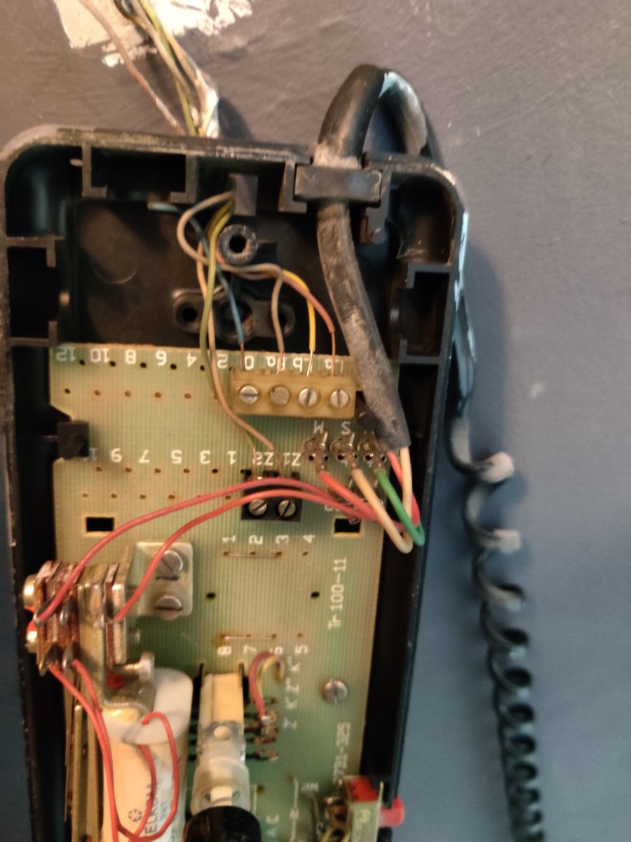

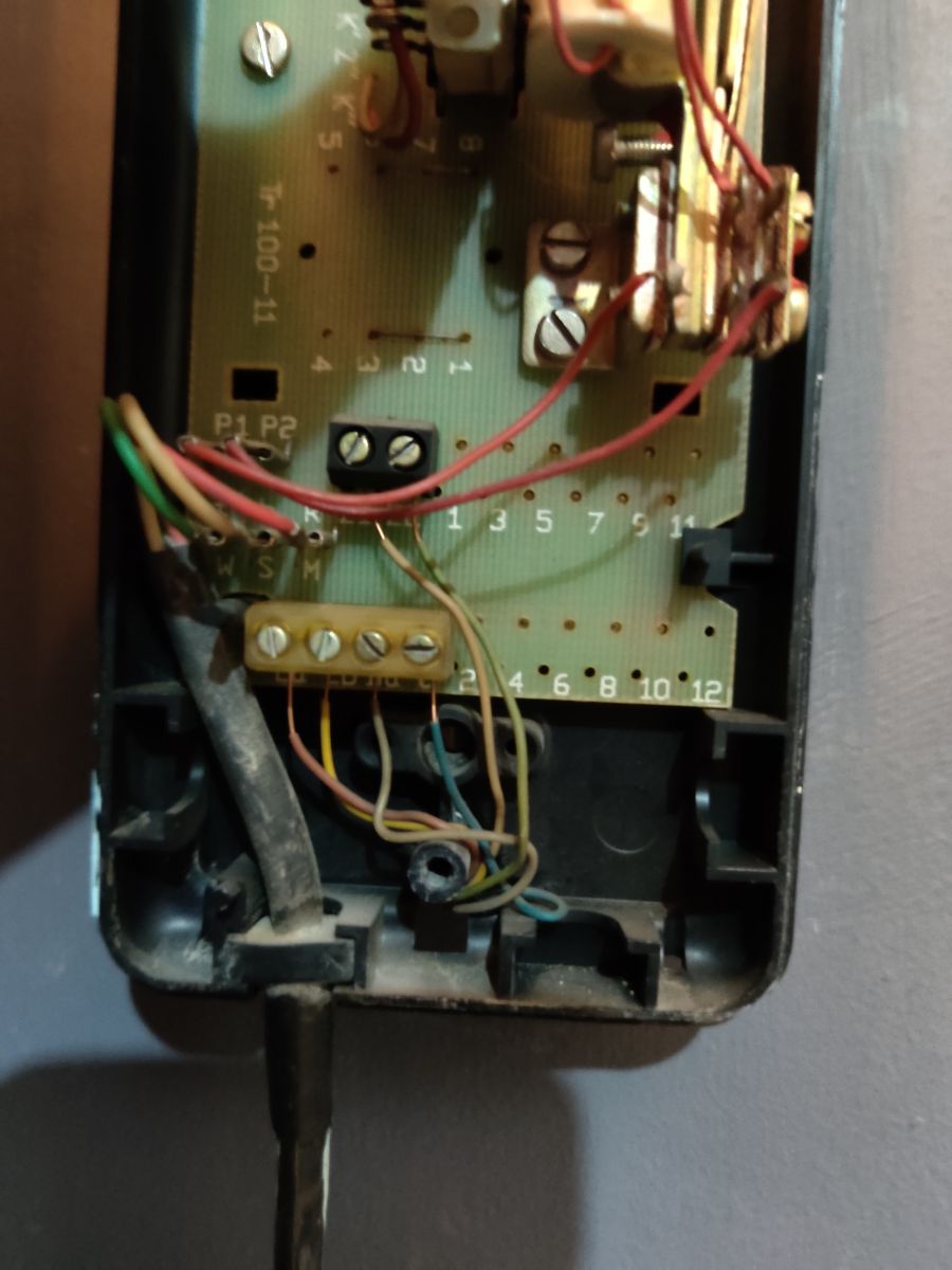

  • #39 20703086
    bryan1233

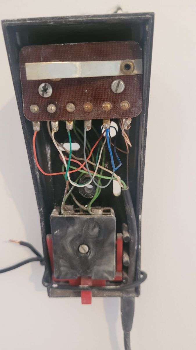

    I would like to ask for help in connecting the Cyfral Smart 5P intercom.
    Photo of the old intercom.
    Old intercom with visible colored wires connected.
    Thank you very much for help :)
  • #40 20703159
    Ircys
    Intercoms specialist
    Posts: 6971
    Help: 1342
    Rate: 2085
    Connection of the Cyfral Smart 5p uniphone:
    MASS - white
    RING - red
    SPK - green
    MIC - gray
    SW1 - blue
    SW2 - brown
    All jumpers removed.

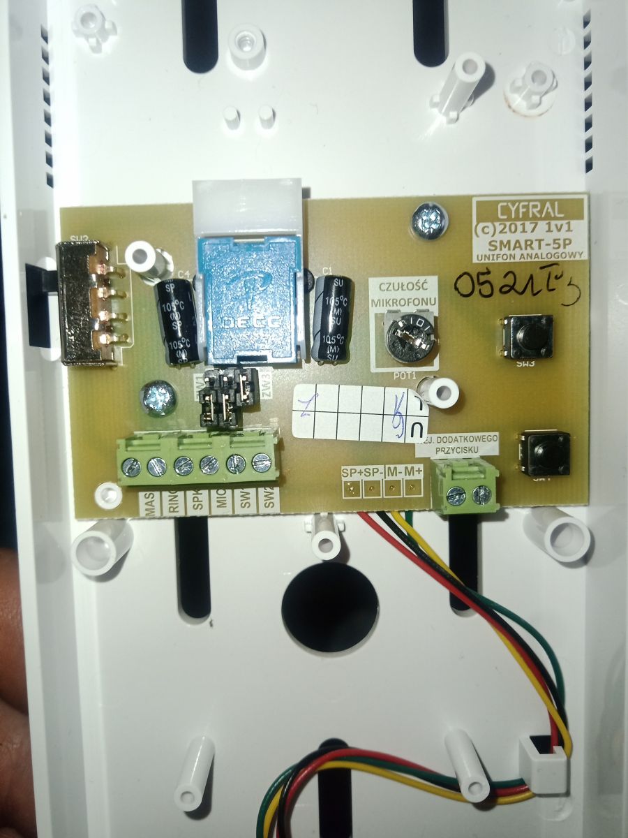

  • #41 20756791
    medykaina10Medykaina
    Interior of a Cyfral Smart 5P intercom with visible colored wires: blue, green, orange, gray, brown, and white.
    I need help. How to connect the digital smart 5p intercom? Cable colors: blue, green, orange, gray, brown and lots of white?
