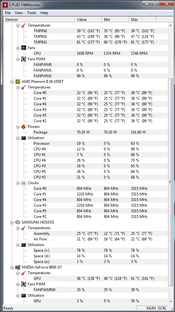

  • HWMonitor temperatures suggest GPU is not overheating

    MichuIT wrote:
    Enter the temperatures and measure the voltages on the power supply
    And how to measure the voltage? I have no gauge.
    What I gave from HWMonitor is anyhow authoritative?
    Screenshots made just after about 5-10 minutes of playing LoL.
    In Battlerite, I know that the GPU temp is 76C max. Also, as you can see, the load is higher, and there are no problems, except for rare drops in fps, but this is the fault of a weak card.
    • The screen freezes during the game - the sound also needs to be restarted. lol temp.png (74.19 KB) You must be logged in to download this attachment.
    • The screen freezes during the game - the sound also needs to be restarted. napiecie.png (33.38 KB) You must be logged in to download this attachment.

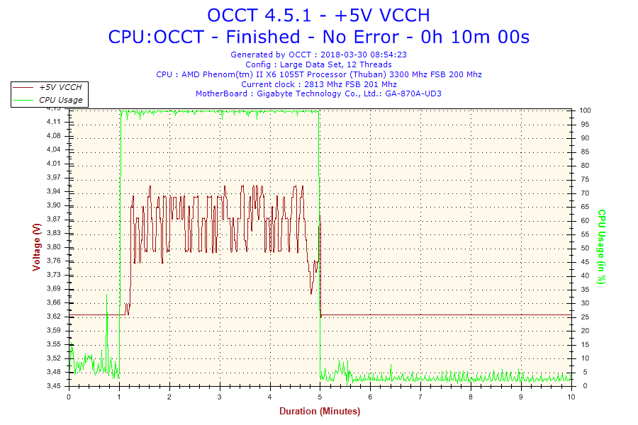

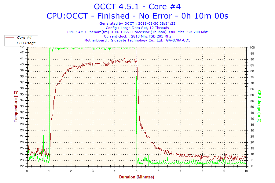

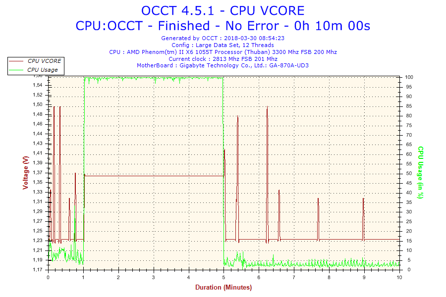

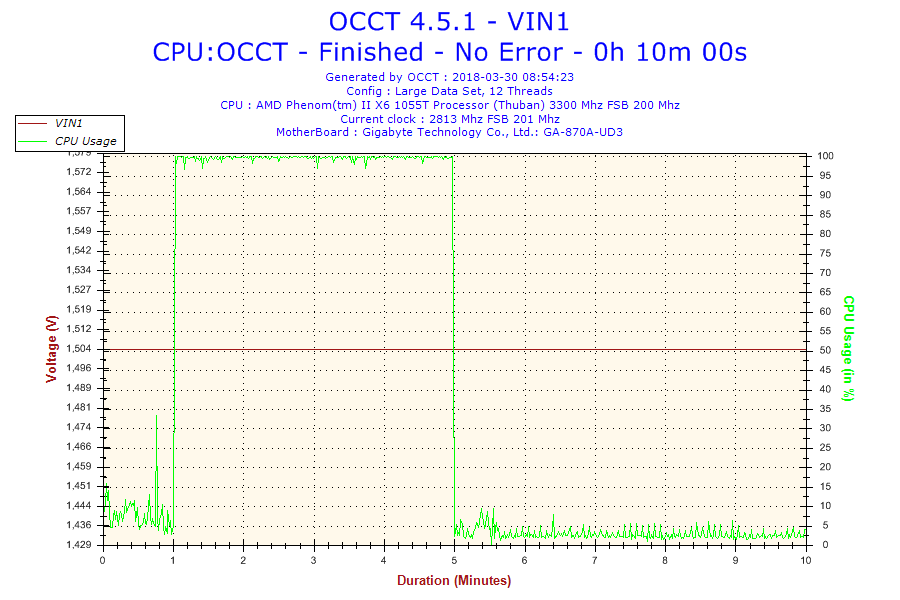

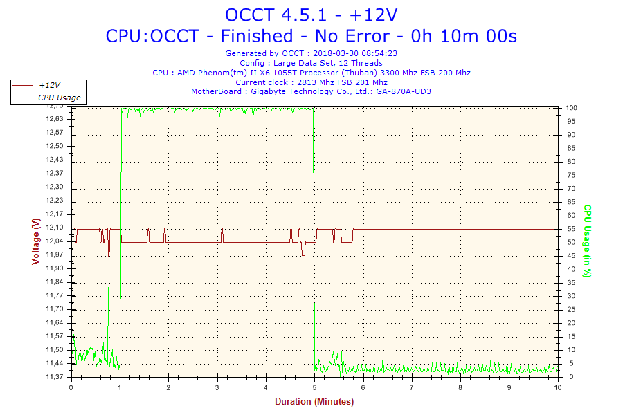

    Perform a 10-minute test with OCCT with log recording (in case it went down / reset).
    If the test passes without a problem, upload photos with charts =>
    http://www.ocbase.com/

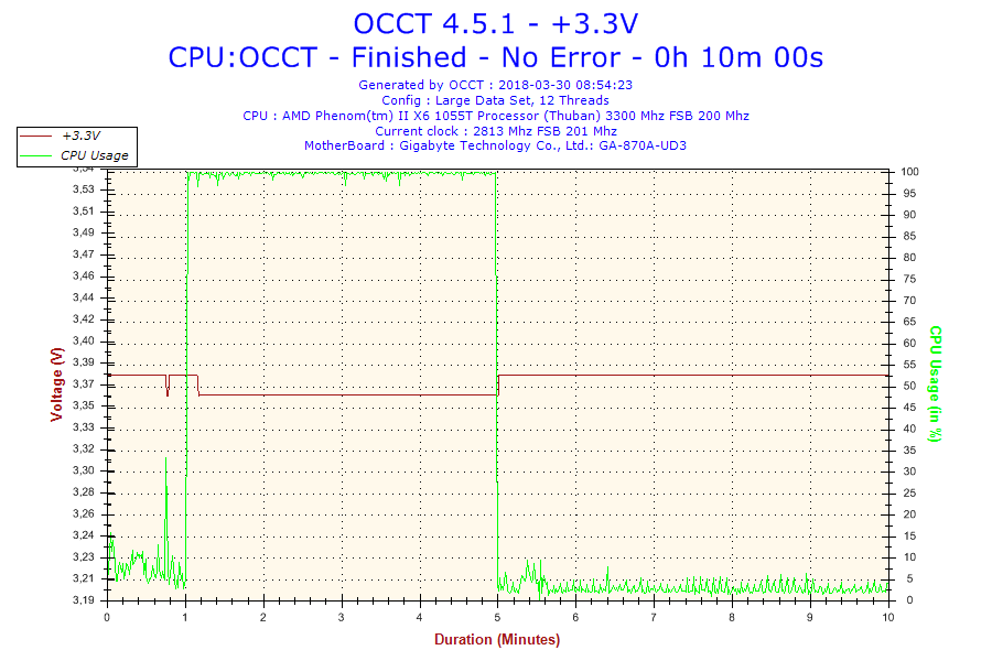

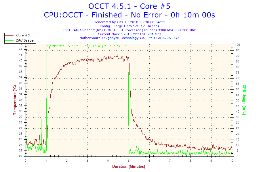

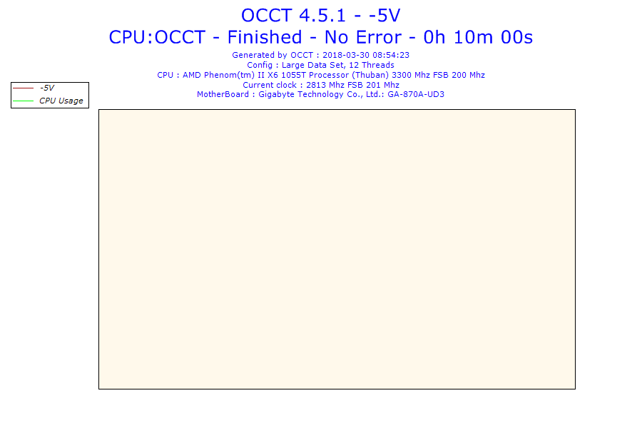

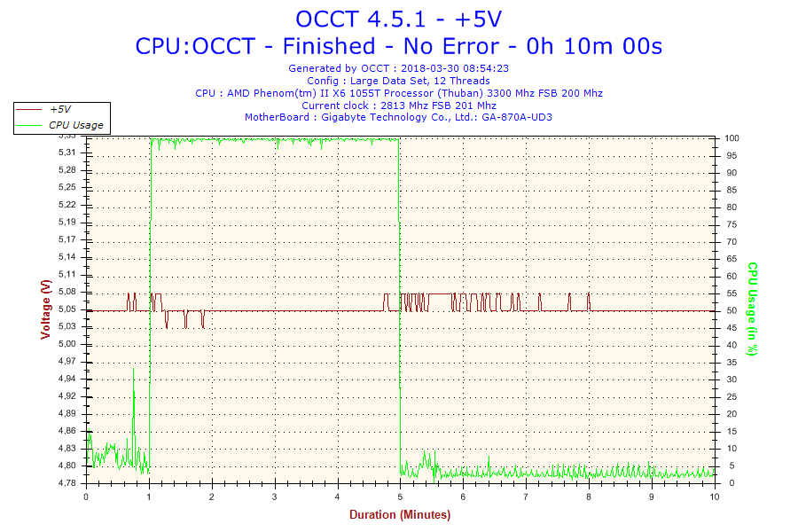

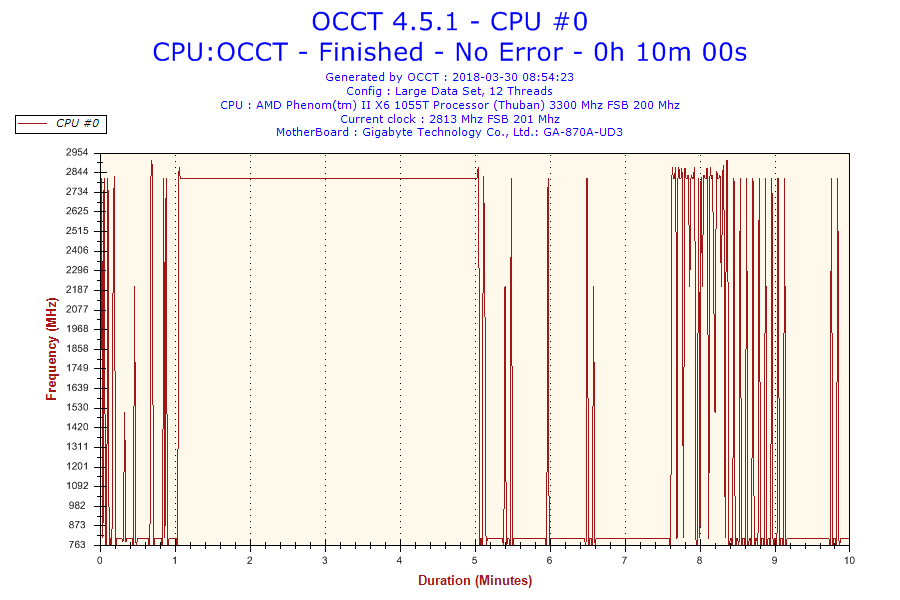

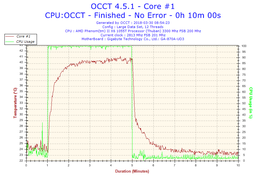

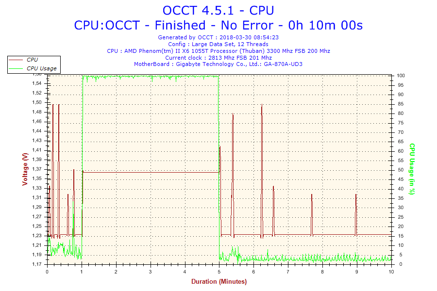

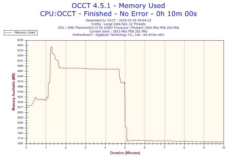

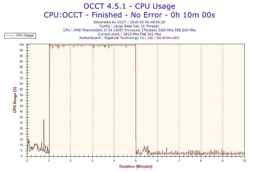

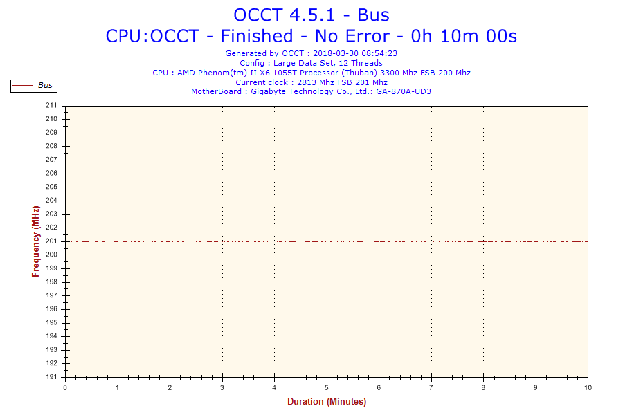

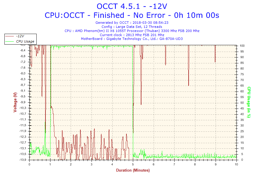

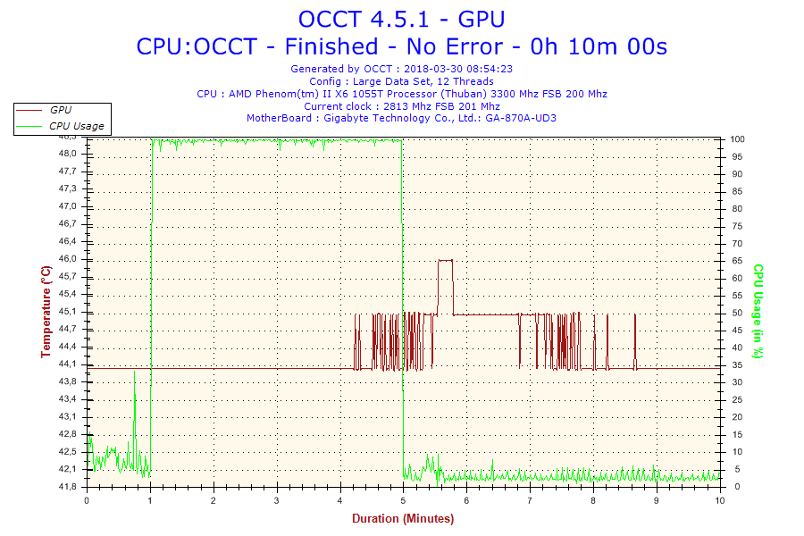

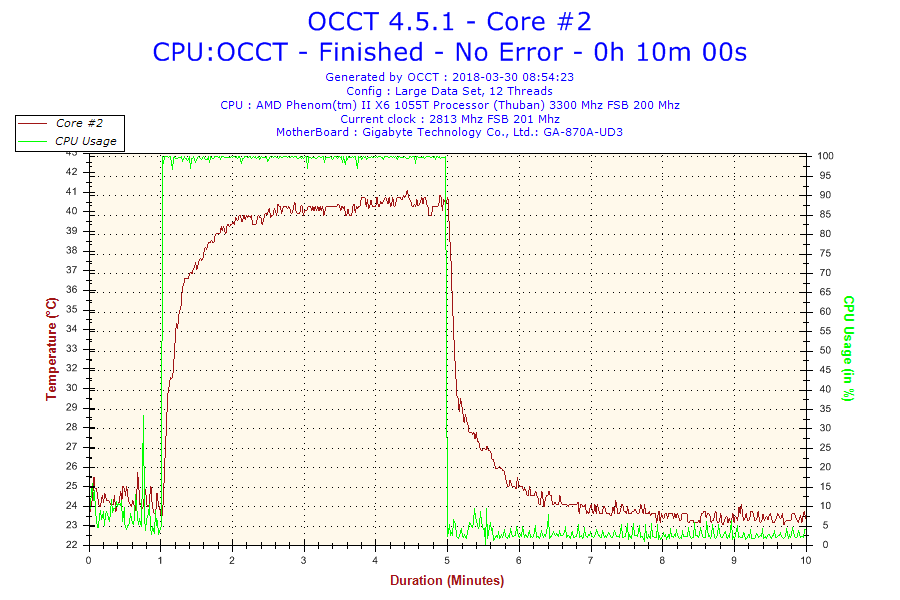

  • #7 17137350
    hadesw
    Posts: 8
    RADU23 wrote:
    The drive is in perfect condition.
    I did this test.
    The screen freezes during the game - the sound also needs to be restarted. The screen freezes during the game - the sound also needs to be restarted. The screen freezes during the game - the sound also needs to be restarted. The screen freezes during the game - the sound also needs to be restarted. The screen freezes during the game - the sound also needs to be restarted. The screen freezes during the game - the sound also needs to be restarted. The screen freezes during the game - the sound also needs to be restarted. The screen freezes during the game - the sound also needs to be restarted. The screen freezes during the game - the sound also needs to be restarted. The screen freezes during the game - the sound also needs to be restarted. The screen freezes during the game - the sound also needs to be restarted. The screen freezes during the game - the sound also needs to be restarted. The screen freezes during the game - the sound also needs to be restarted. The screen freezes during the game - the sound also needs to be restarted. The screen freezes during the game - the sound also needs to be restarted. The screen freezes during the game - the sound also needs to be restarted. The screen freezes during the game - the sound also needs to be restarted. The screen freezes during the game - the sound also needs to be restarted. The screen freezes during the game - the sound also needs to be restarted. The screen freezes during the game - the sound also needs to be restarted.
