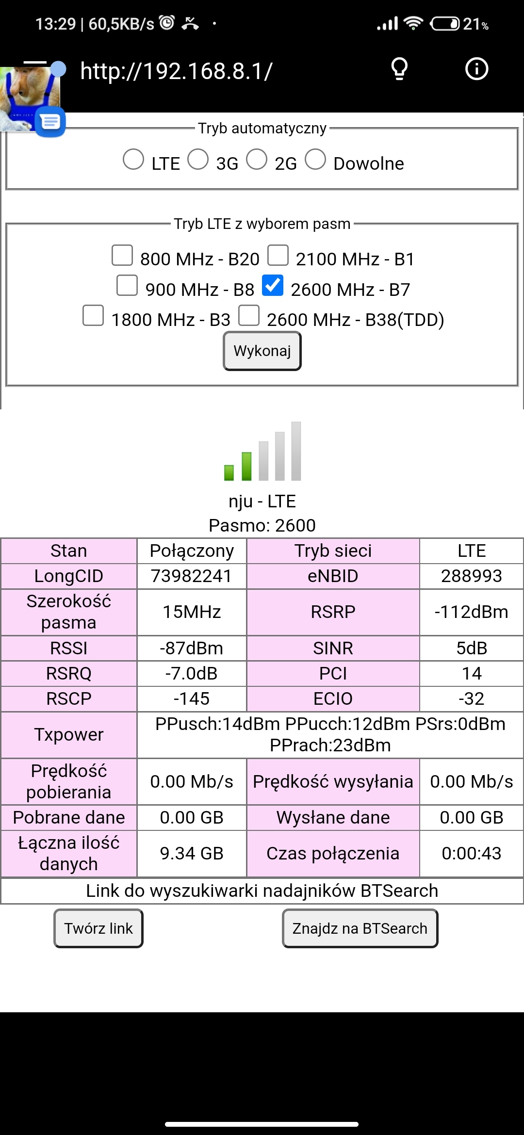

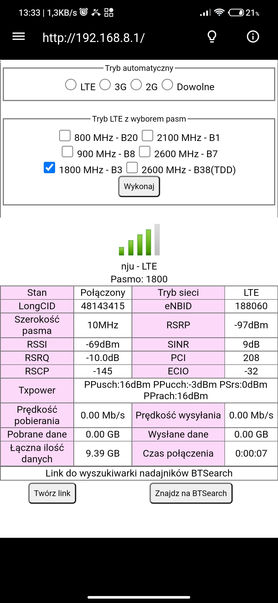

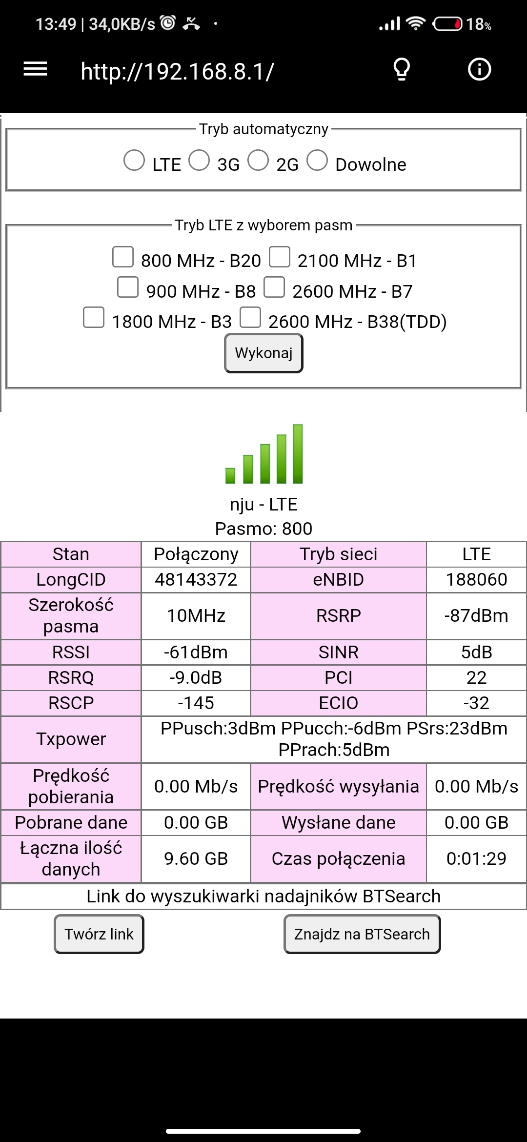

    Hello, I will stick to the topic. I have a Huawei b535 router with Orange internet.
    I would like to buy an external antenna, but I do not know which one. Now for a description of my location.
    I live in the forest between 2 transmitters about 3 km away, one has 3 LTE 800/1800/2600 bands
    On the second, 800/1800
    The router does not aggregate with the first transmitter 2600 the other one only switches to the 2nd transmitter.
    On the other hand, 2 of them already aggregate 2 bands.
    Below I will throw screenshots with the results on specific frequencies
    The speeds I achieve are
    About
    10 m up to 800
    10 meters up to 1800
    20 mb up to 2600
    And after the aggregation of 800 1800 it is usually a little better than 2600
    The test router is wrapped in foil and placed on a mast about 6m above the ground
    The question is what antenna and at what frequency to attack.
    • LTE Antenna Selection: Huawei B315-22s, Orange Mobilny, Bronowo Kmiece, LTE 800 & 1800 Bands IMG_20220521_133336.jpg (370.55 KB) You must be logged in to download this attachment.
    • LTE Antenna Selection: Huawei B315-22s, Orange Mobilny, Bronowo Kmiece, LTE 800 & 1800 Bands IMG_20220521_134916.jpg (367.1 KB) You must be logged in to download this attachment.
    • LTE Antenna Selection: Huawei B315-22s, Orange Mobilny, Bronowo Kmiece, LTE 800 & 1800 Bands IMG_20220521_133004.jpg (378.66 KB) You must be logged in to download this attachment.
