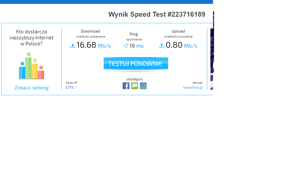

    I have just extended the contract with the operator (Plus) and replaced the router from Huawei b315 with b535 in the hope that the performance will finally improve.
    Unfortunately, as it turns out for nothing, because the new router itself rarely uses aggregation and the rules work on the 900 band (sometimes it will turn on aggregation of the 900 + 1800 band). The router (my location is Zamienie 05-300, ul. Lesna 33) is still connected to BTS, which is 4.9 km away from me (Mińsk Mazowiecki Gen. Kazimierz Sosnkowski 34) (I have one BTS closer to 3.3 km ( Glinianka Rzakta 82) but the router does not catch it at all, probably through the forest that separates us.
    Help me choose an antenna or help me connect to a closer BTS, or choose an operator who will be able to provide me with a more stable and efficient link ..

    The idea of blindly replacing the router to improve coverage in advance was doomed to failure. From the beginning of the contract, it was necessary to purchase an antenna for B315 and conduct tests on it. Plus, it is not an innovative operator, LTE900 was launched on 5MHz instead of LTE800Sferia and it works the same, which is usually tragic. This range band is narrow and usually clogged. There is hardly anything to count on the LTE1800 in such conditions at home. The LTE900 + 1800 aggregation is not much different from the LTE1800 itself. Perform LTE900 and LTE1800 band tests on B315 or B535 by forcing them with LTEWatcH, show results and speed tests. Don't count on much, it's a Plus. the decision to continue the contract with him rashly, in React NetWorks with LTE1800, LTE2100 and LTE800 Orange and T-Mobile. All operators also in Minsk on Sosnowskiego, but there NW and Play have a set of 4 LTE bands with their aggregation, Plus only LTE1800. It also has LTE1800 and LTE900 in Grzebownik.

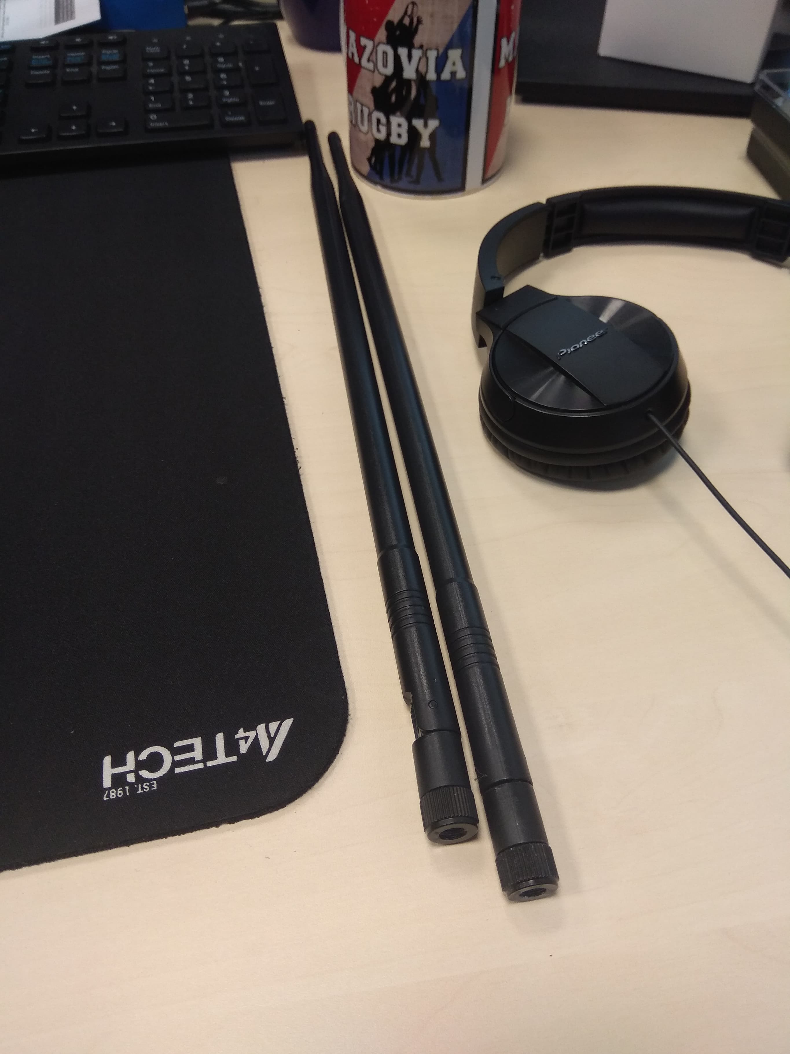

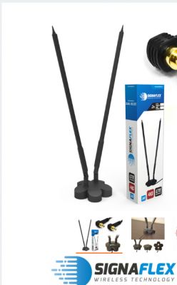

    Today my friend lent me two SMA antennas, but these are not external antennas, so they probably won't work. Don't pay attention to the stand, I will connect these two antennas directly to the router.
    Plus LTE Huawei b535 poor coverage. Antenna selection or operator change?
    archiwum.allegro.pl/oferta/antena-dual-4g-lte-30dbi-huawei-e3372-e5373-2xcrc9-i5611685085.html

    A colleague threw away a lot of money for something that is hard to call an antenna, is electro-waste with a gain of several dBi (3-5), is to work in the 1800-2100MHz band, RG174 cables with a length of 5m are attached to it, the attenuation of such cables at about 2GHz is 2dB / m. The signal loss on the 5m cable will be about 10dBi. So in fact it is a silencer, not an antenna. Of course, you do not connect it to the router so as not to deteriorate the signal parameters on the LTE1800.

    By connecting only the antennas without a cable, so maybe the minimum gain will be. With the rest, I only throw them for tests and now I can guess you're right and this is scrap.

    This is exactly the purpose of this test. I will perform such a test on the inside windowsill with and without antennas, and on the windowsill outside the window, also with and without antennas. (on each band)
    The Allegro seller claimed that
    Working band: 1700 ~ 2100MHz
    Energy gain: 2x15 dBi
    Impedance: 50 ? per connector
    I feel like he "missed the truth a lot" but we'll see :D

    And how do you want to connect it without cables? This electro-waste has RG174 cables permanently, and we do not know if they have SMA connectors or others. You can skip the LTE900 Plus, on the LTE1800 the loss on cables with connectors will be as much as wall attenuation. But check it and you will see how much toto is worth. Like everything from Signaflex, that is a profit sucked away, against the laws of physics. It is the basic supplier of shit for Janusz on Allegro. You are running out of time, buy Orange free starters for PLN 5 with 6GB, T-Mobile for PLN 5 with 7GB (the one with the inscription 111GB) and Pre-paid Internet in Play for PLN 5 with 7GB.

    The best part was that he was very pleased. He used this putty when mining currencies. (But ending these arguments) I'll try to buy starters today and check what and how. As long as they will not make any problems with registering the card ..
    The antennas themselves have an SMA connector, so with these 5m cables I would not be able to connect because they have a CRC9 terminal

    And how do you know that it is SMA and not RP-SMA, they have pins inside, I have already seen various wonders from Signaflex. These types of antennas require this magnetic base to function.

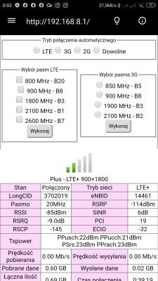

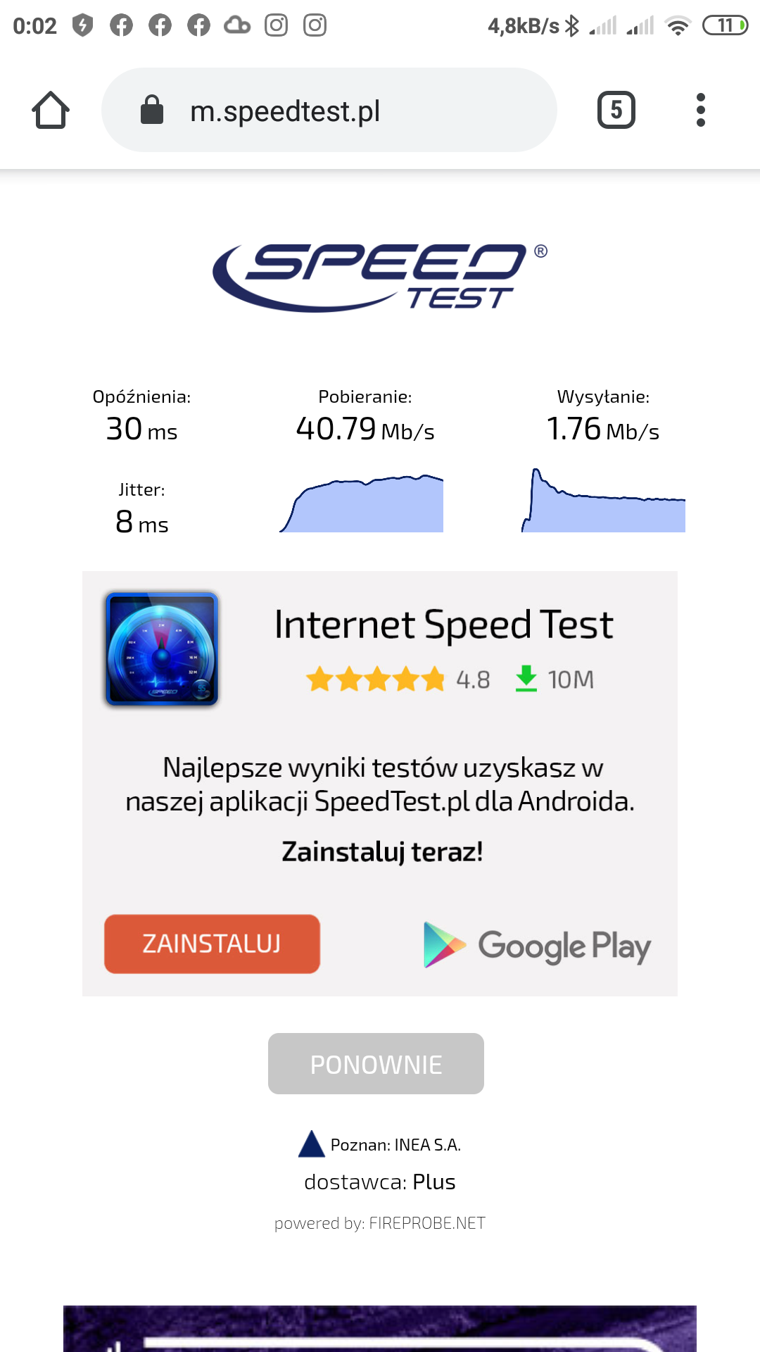

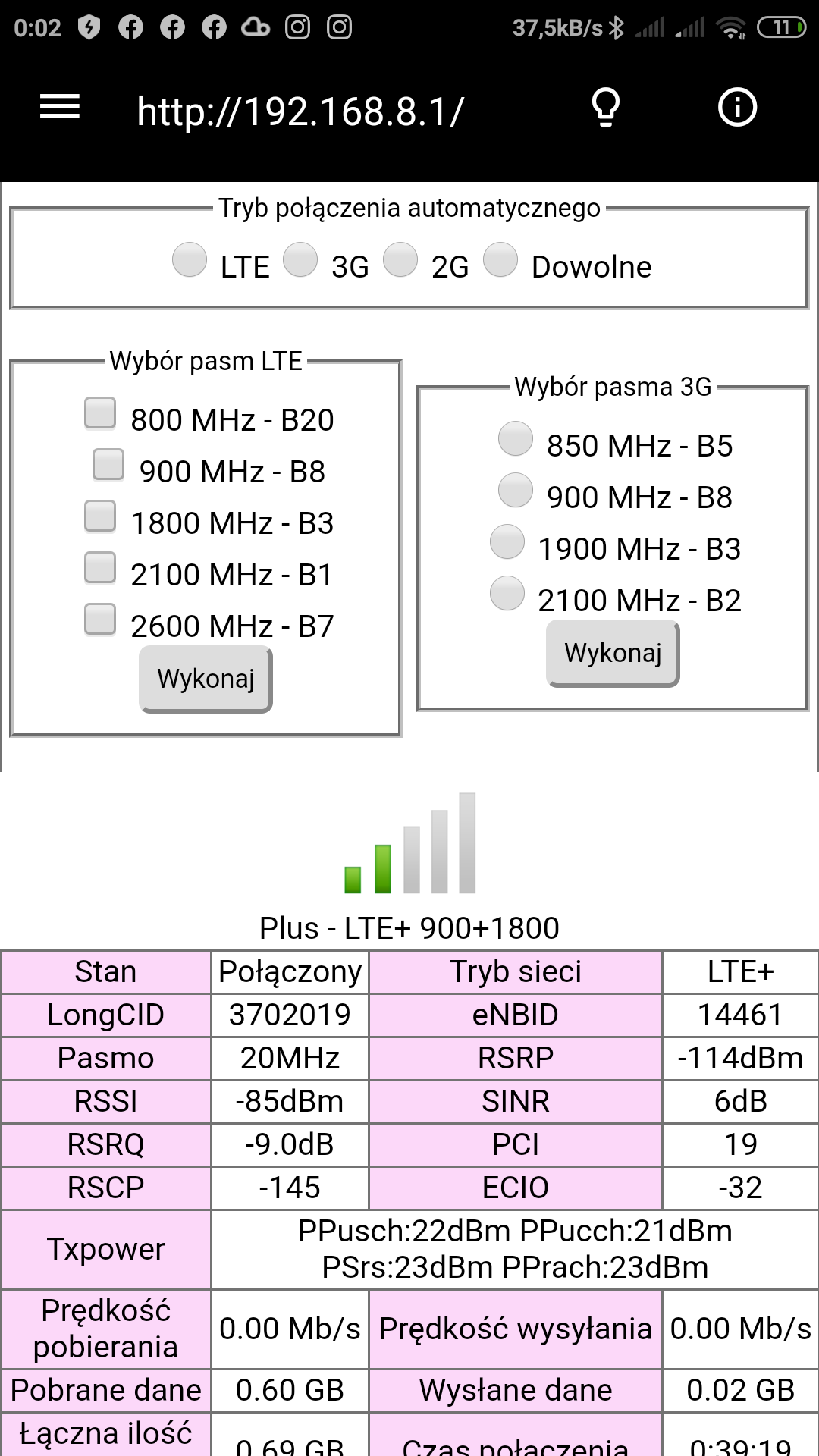

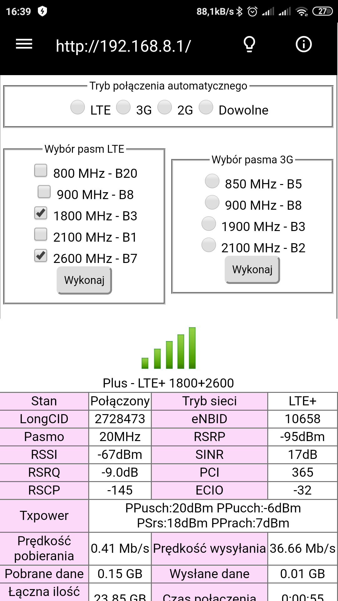

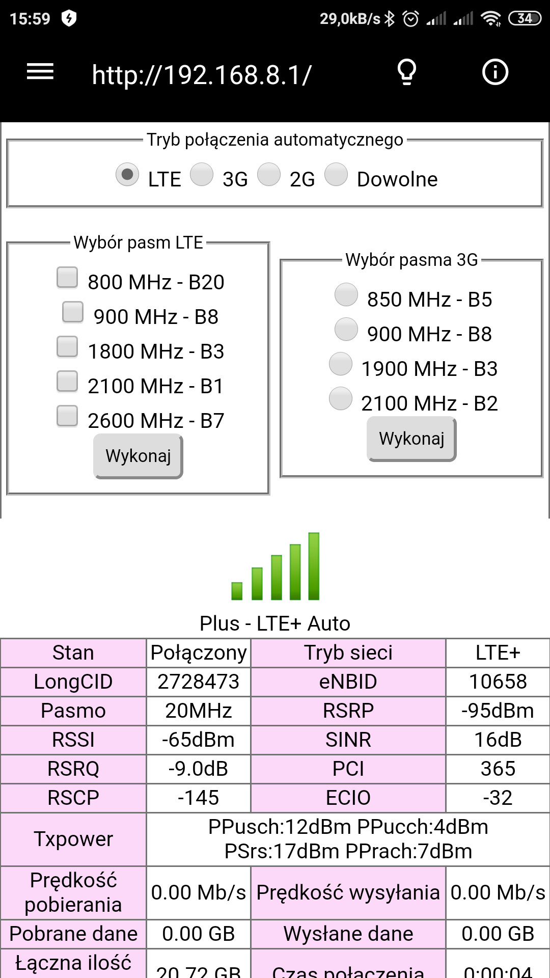

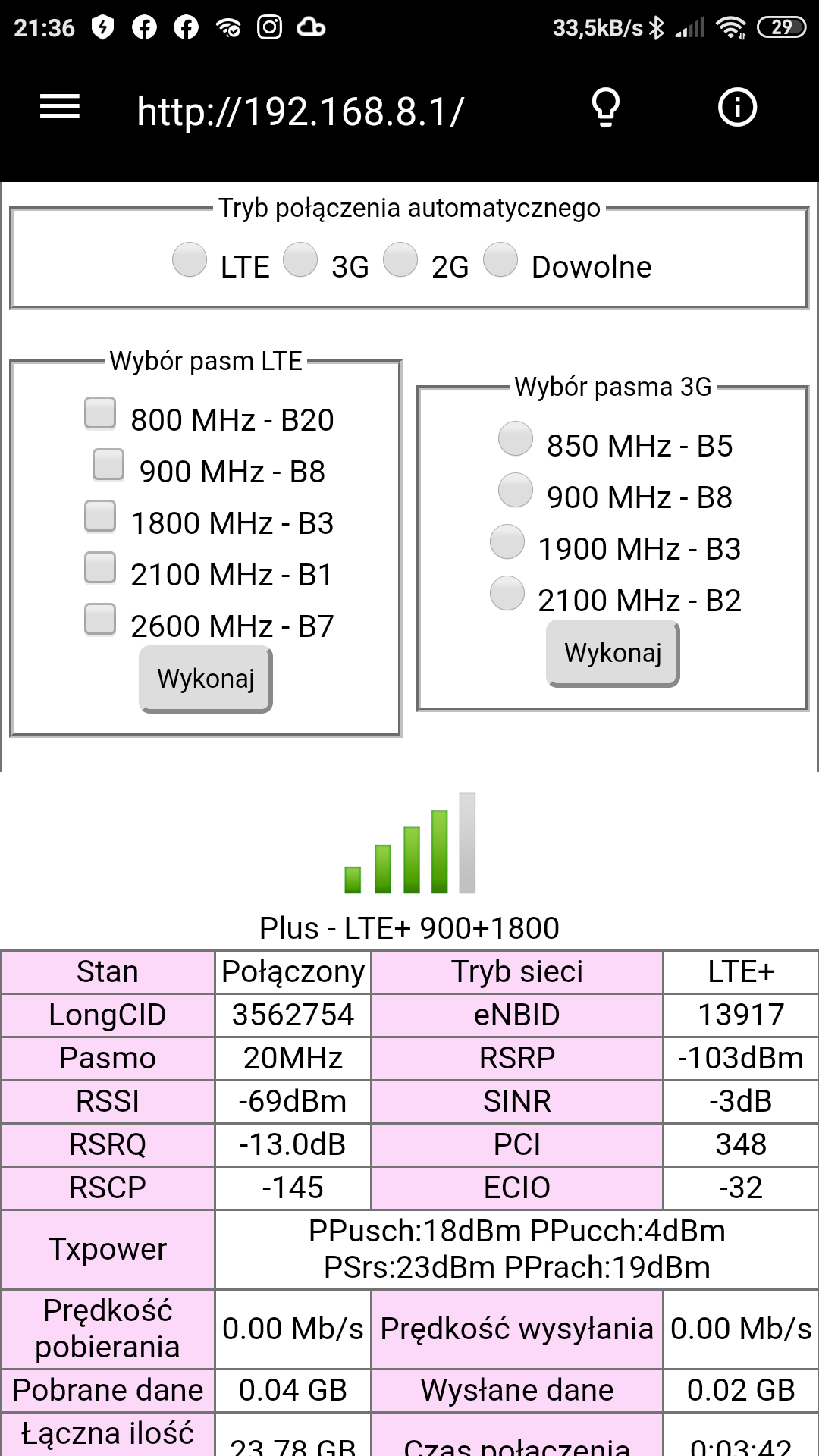

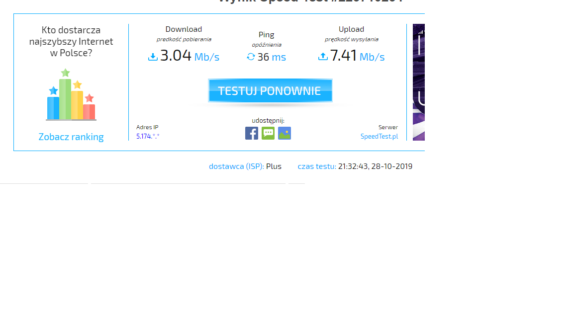

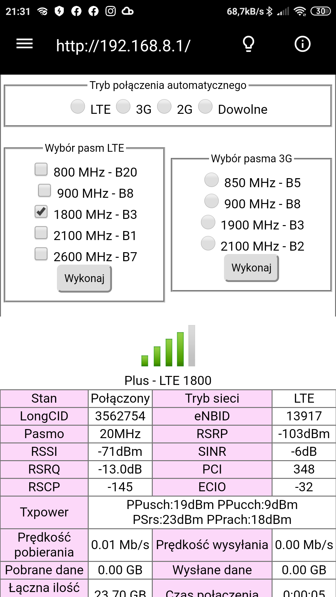

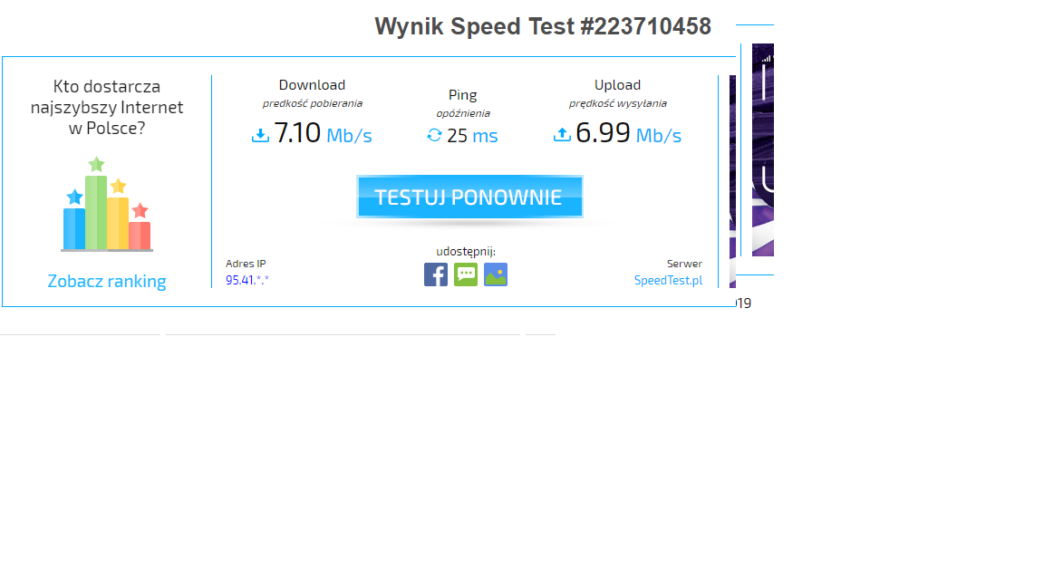

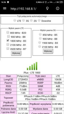

    First of all, Matek451, you were right, the antennas had "SMA female input" .. so nothing came out of the antennas about the tests. Yesterday I did tests on Card PLUS, PLAY and Orange. I will show the results below, but as for the conclusions, with the router outside, Play was the best because I got enough range of 2600 and 2100 and sometimes the DL speed during Aggregation was 50+ .. Orange was not much worse, but it had mega weak speeds at 2100 So Aggregation was profitable only at 1800 + 2600.
    At the end there was a plus which on the outside caught another BTS which was very clogged at that moment and I had to combine with hiding the router home and sticking out the teeth again to stay on the theoretically better one ...
    plus outside the window
    1800
    Plus LTE Huawei b535 poor coverage. Antenna selection or operator change? Plus LTE Huawei b535 poor coverage. Antenna selection or operator change?
    Another BTS

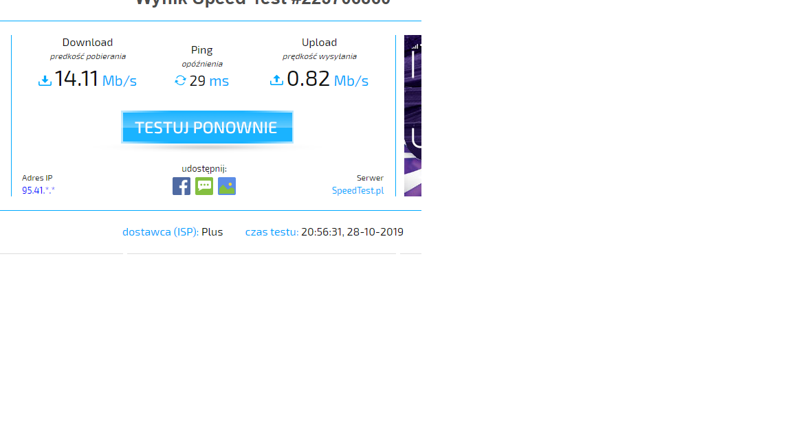

    PLUS Aggregation on a loaded BTS (outside the window)
    Plus Aggregation 1800 + 900 on faster BTS
    [url=https://obrazki.elektroda.pl/3862957300_1572340924.png]Plus LTE Huawei b535 poor coverage. Antenna selection or operator change?

    It's normal, Signaflex is crap and the antennas are rubbish so I'm not surprised. Similarly to the operation of Plus, the BTS in the ZNTK area still works somehow, but on LTE1800 the signal is weak even outside the window, hence the low street. The latter is BTS Stojadła. with others, i.e. Orange or Play, it is a poor relative. In addition, with weak, expensive offers and FUP, i.e. funnels by I see Plus.

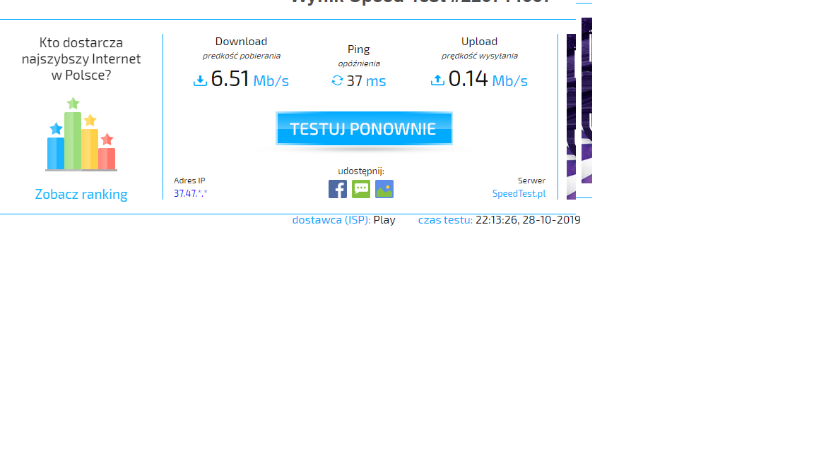

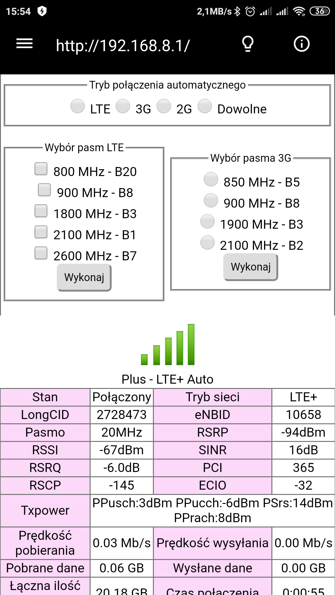

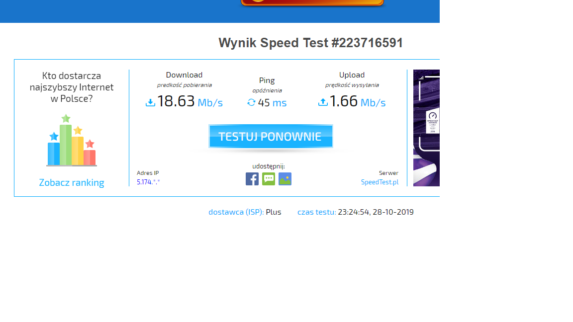

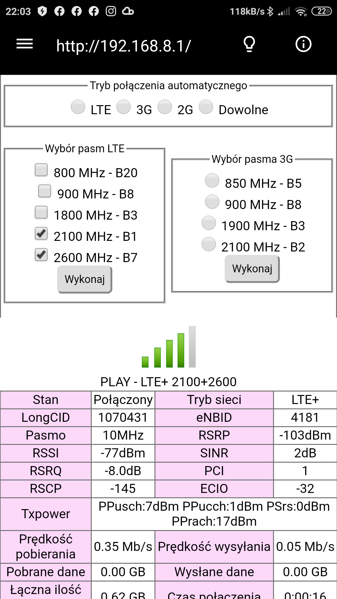

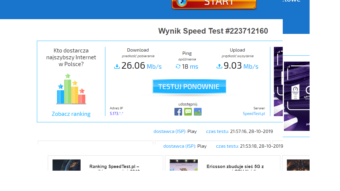

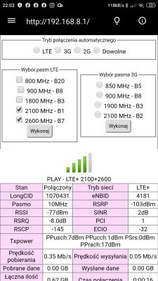

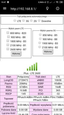

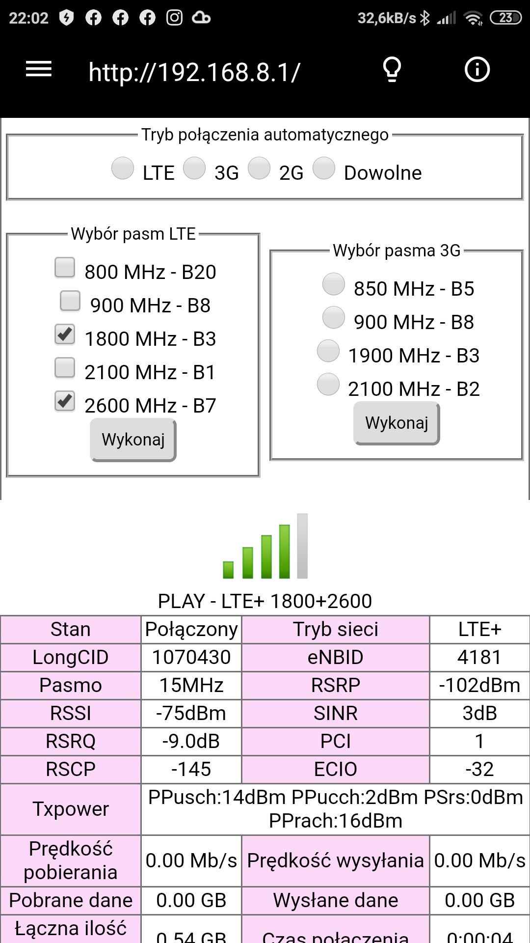

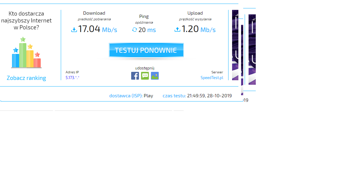

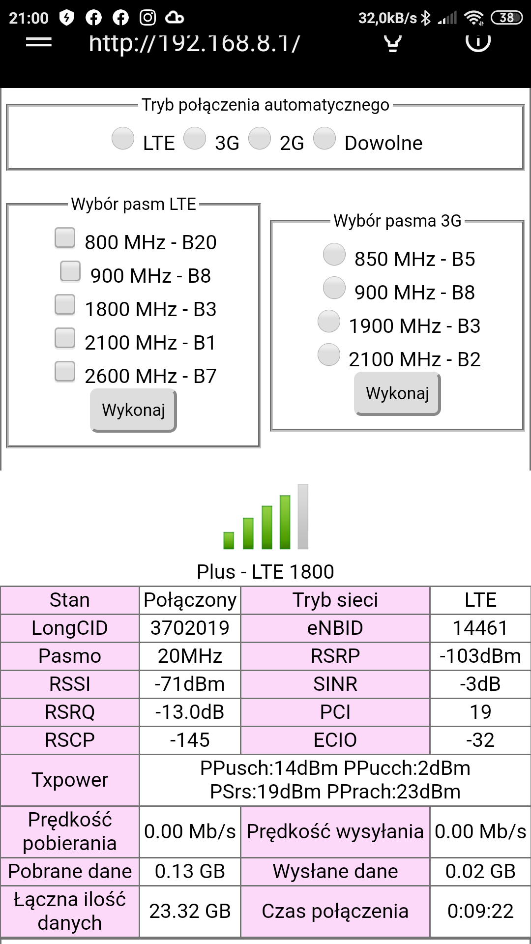

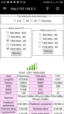

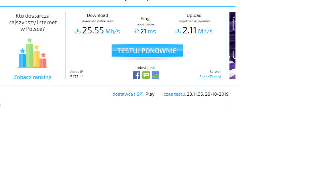

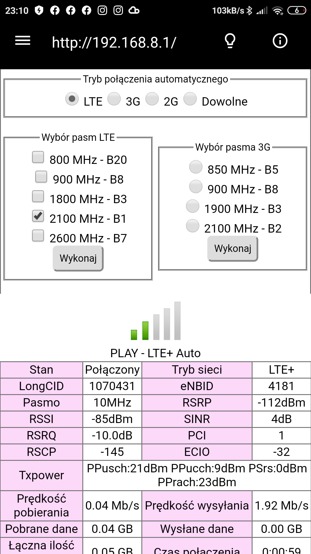

    Play LTE Auto at home

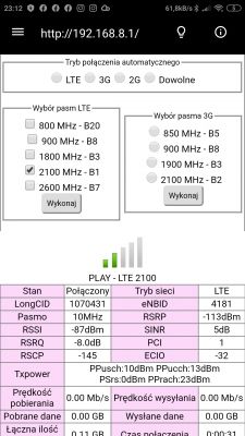

    PLay 2100 at home
    2100 + 2600 Outside

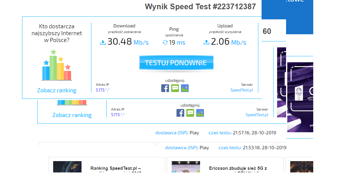

    1800 + 2600 Plus LTE Huawei b535 poor coverage. Antenna selection or operator change?
    Unfortunately, the screen did not save me, but there was something around 30-35Mb / s DL
    1800 inside
    2,100 outside
    2600 outside
    1800 + 2100
    #17 18245884
    matek451
    Posts: 31253
    Help: 4352
    Rate: 5808
    BTS from ZNTK, aggregation with LTE1800 / 2100 + 2600 works fine despite weak signal at 1800 / 2100MHz. on LTE2600 the signal is even worse, although you did not show the LTE2600 itself. After improving the signal on 1800-2600MHz with the external antenna, it will probably jump and with 100Mb / se LTE2600 + 1800/2100 aggregation. Another fairy tale. The 50MHz bandwidth on the BTS does its job.

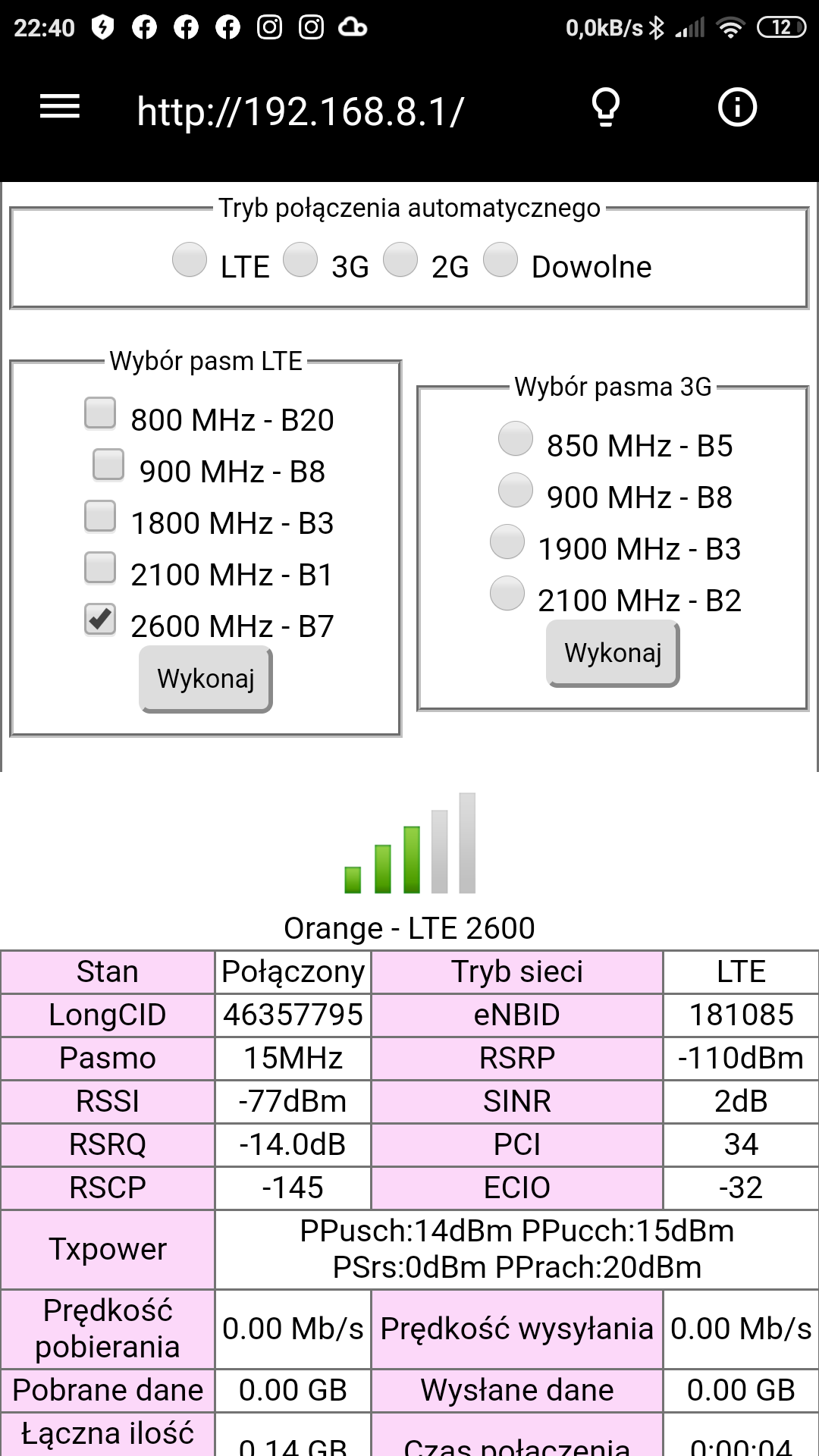

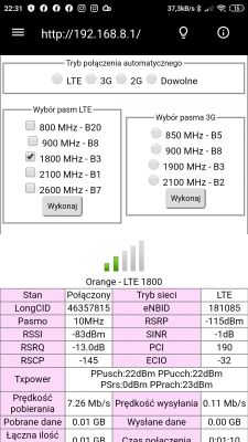

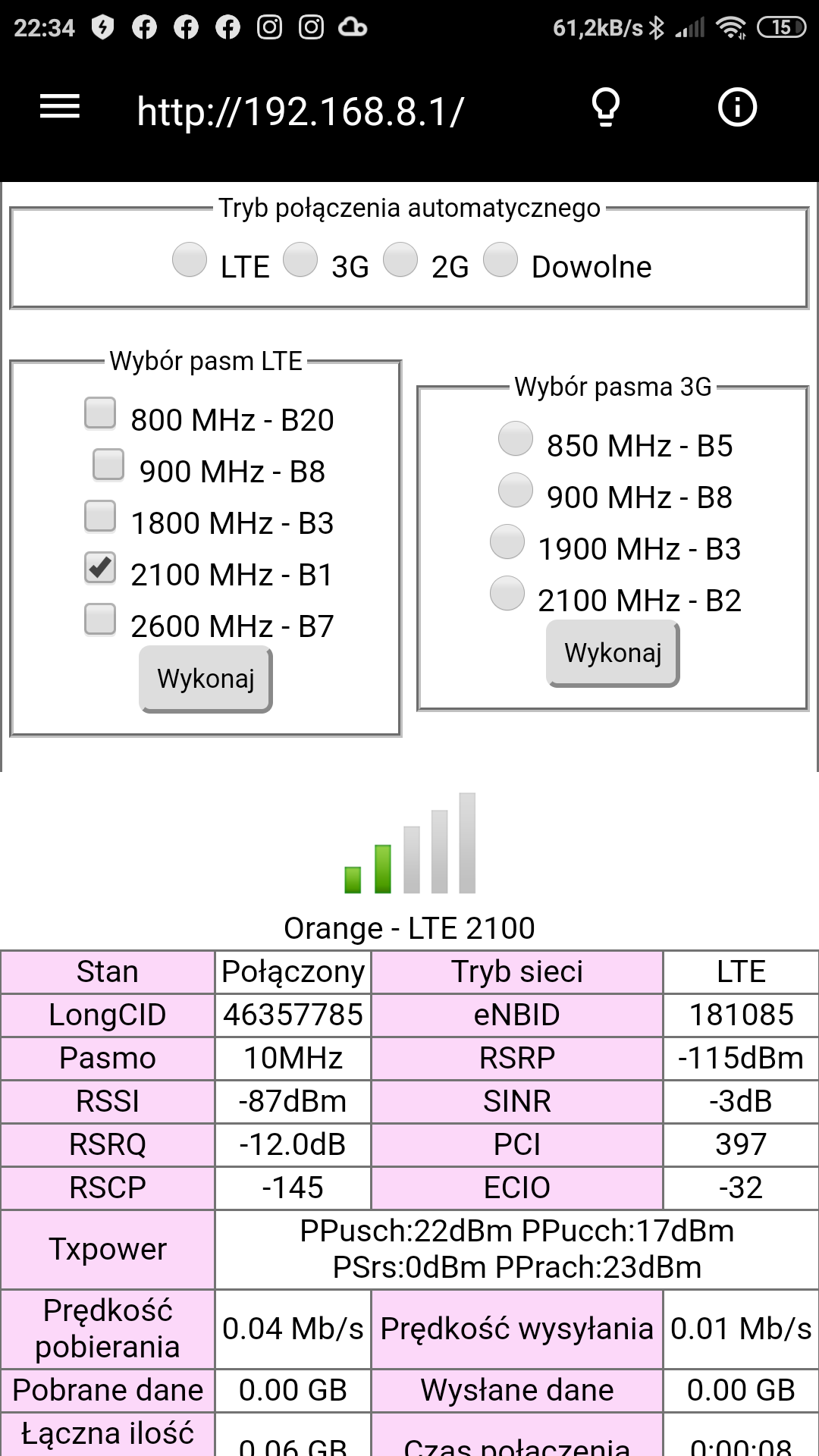

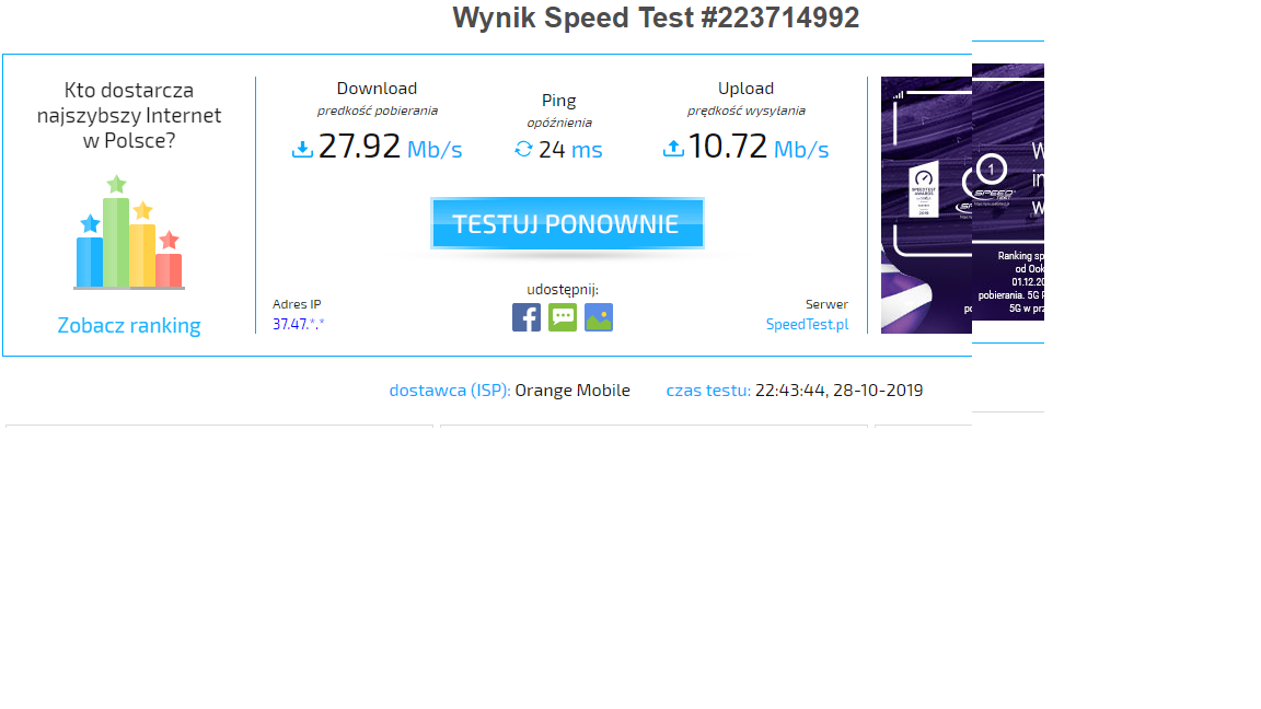

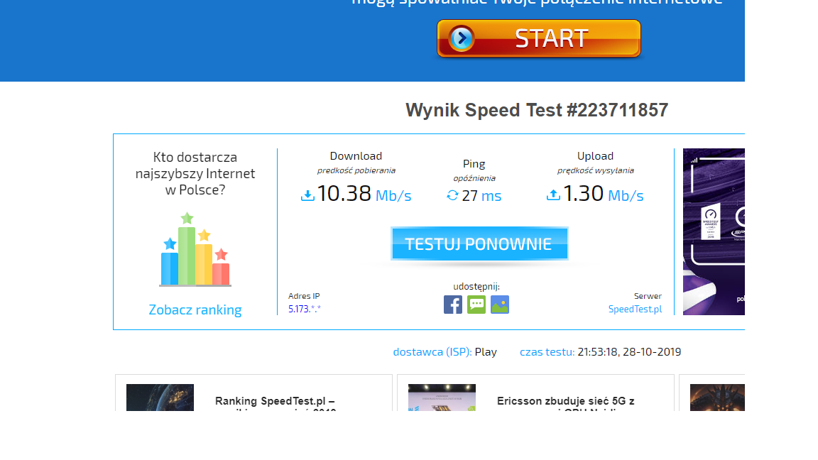

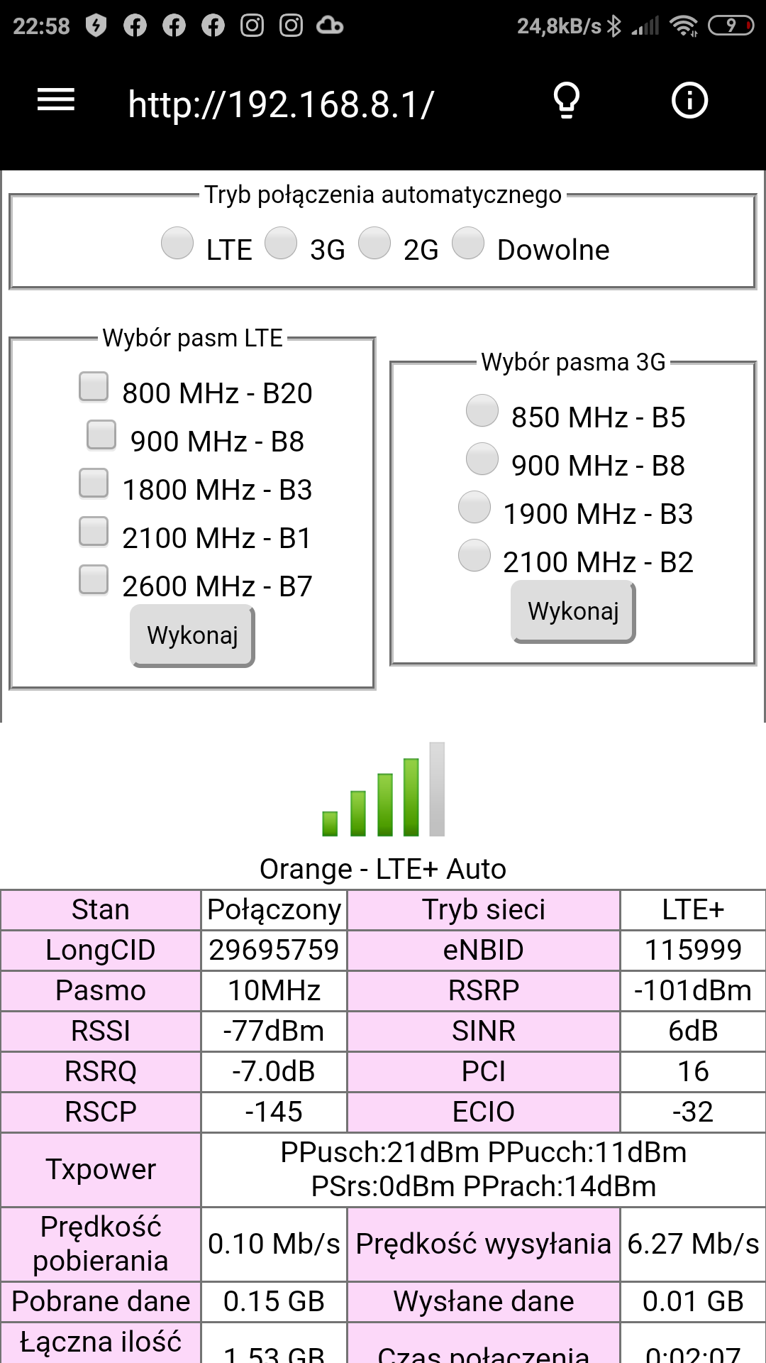

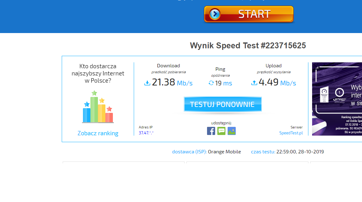

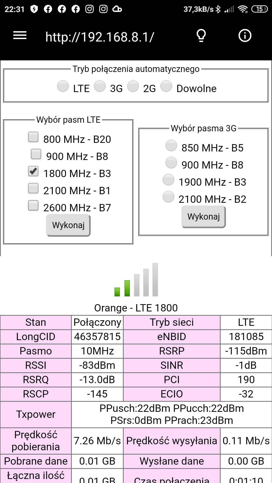

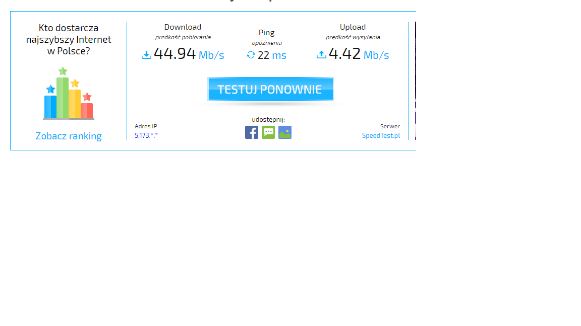

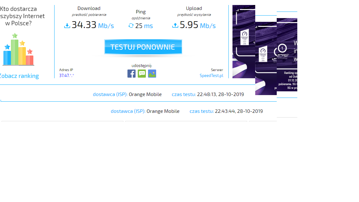

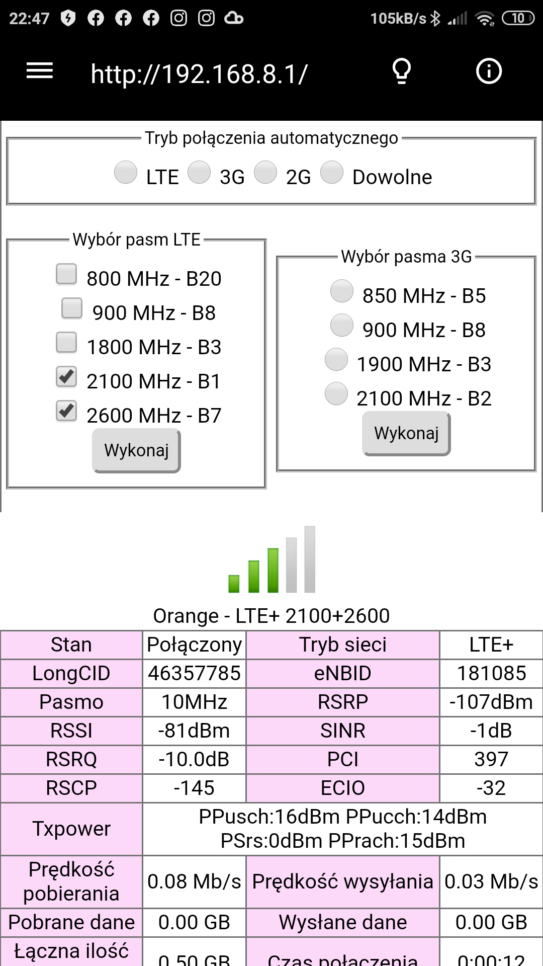

    Orange
    LTE Auto at home Plus LTE Huawei b535 poor coverage. Antenna selection or operator change?
    2600 outside
    2,100 outside
    1800 outside
    2100 + 2600 outside
    Added after 5 [minutes]:
    Forgive me for such screenshots but I was very tired and I was already poorly grasped. That's why it looks so chaotic ..
    Best of all, I was very surprised when I saw such a plus result when I went to sleep ...
    The result after 24, so BTS was not burdened anymore.

    The tests inside for Orange are BTS Chrośla, there are no confirmed LTe bands on it, but probably LTE800 + LTE1800 / 2100 aggregation. Good result. The others are BTS at Stanisławowska 67, and also good results, but it is BTS with 4 LTE bands. Your choice, Plus you have checked and you know what to expect from it. You should also know what FUP is and what their pseudo LTE looks like in Plus. In Play, you can have 200GB for PLN 50 / month, and the 1Mb / s funnel potel and the B715 for PLN 249, aggregates 3 LTE bands. Regardless of the operator, the tests showed that an external antenna is necessary.

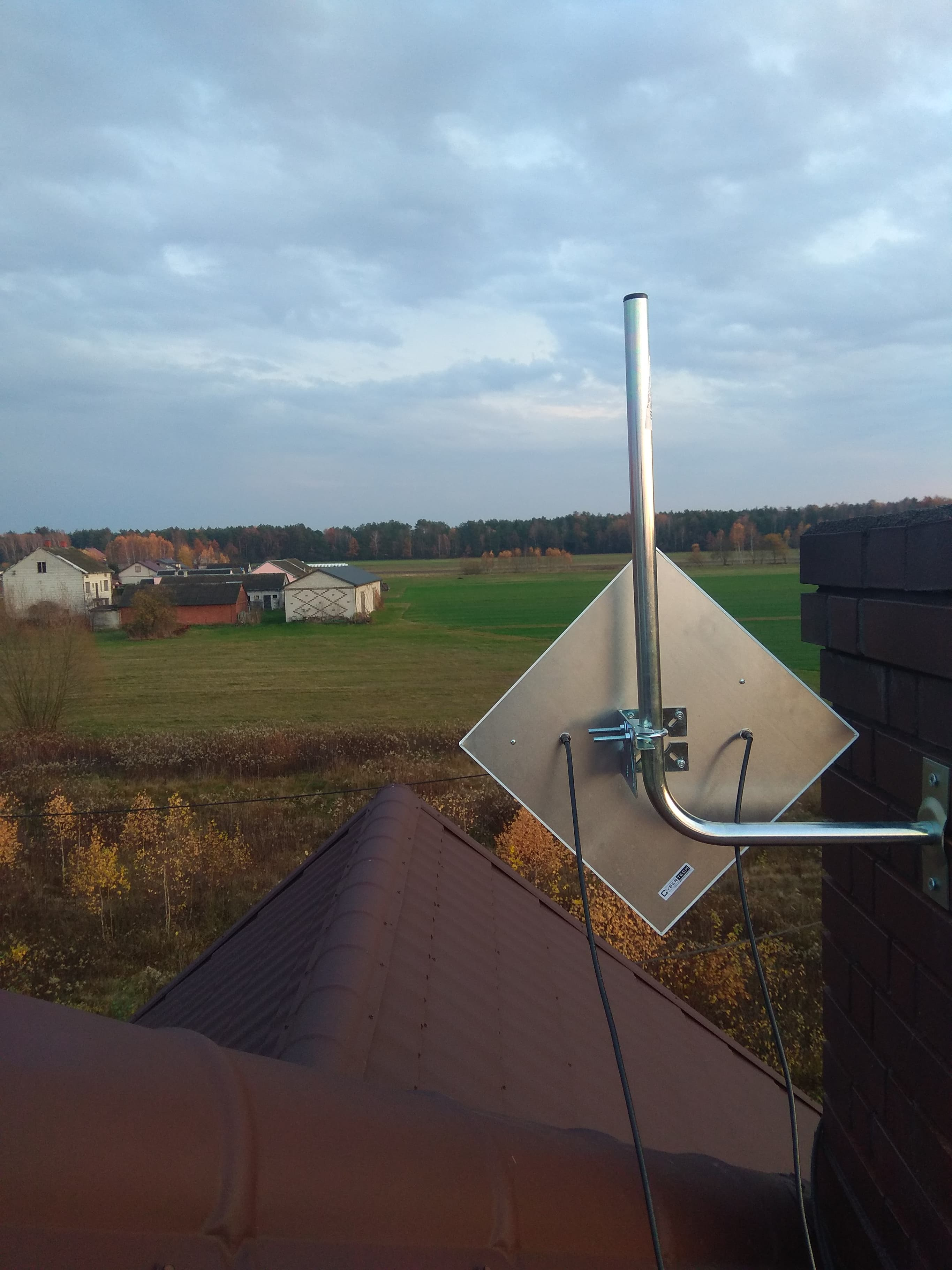

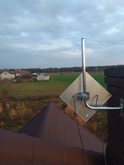

    I am already after mounting the antenna!
    In general, I do not recommend going to the roof with a hangover, but somehow I managed not to kill myself. :)
    Below is a photo of what the mounted antenna looks like.

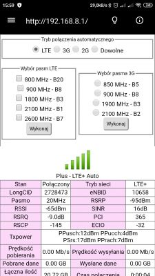

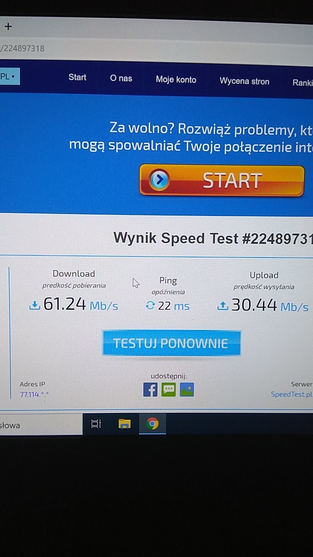

    Surprisingly, the range of BT's from Grzebowilek was the best, and my router without an antenna did not even catch the range ... (Moreover, BTSearch does not have information about the 2600 frequency)

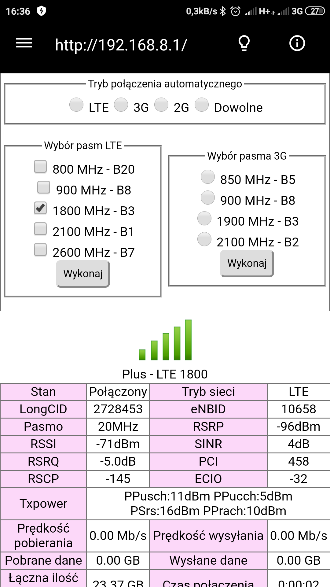

    Below are the results from Hmanager
    Speed at around 4:40 pm
    there was even DL 75 / UP 30 in the peak, but unfortunately I do not have a result, so this one is official
    As for the operator, so far I have not been able to withdraw from the contract (14 days for refusal in the case of signing via the Internet / telephone and I signed in the point so only the complaint remains) plus but maybe it will not be so bad even if the operator is present ..

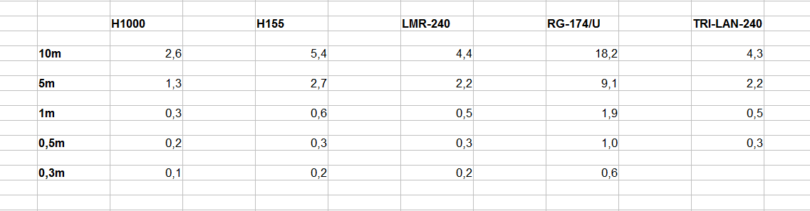

How much signal do I lose with 5 m versus 10 m coax?
Using H155 you drop ≈2 dB over 5 m and ≈4 dB over 10 m. With RG-174 the loss balloons to ≈5 dB and ≈10 dB respectively at 2.6 GHz [Times Microwave, 2023]. Anything above 6 dB can erase half the antenna’s gain.
Do cheap “15 dBi” desk antennas help?
No. The Signaflex whips measured only 3–5 dBi gain, then lost about 10 dB in their 5 m RG-174 lead, turning them into attenuators [Elektroda, matek451, post #18243960] Speeds stayed in single-digit Mbps—an edge-case failure worth avoiding.

  3. Secure the mount and weather-seal the connectors. “Small tweaks can add 5 dB” [Elektroda, Anonymous, post #18259810]
What speeds are realistic after installing the Cybertech panel?
User logs show 75–80 Mbps down and 25–30 Mbps up at 16:40, and even 80 + Mbps at 21:30 when the cell loads drop [Elektroda, kejk1992, post #18276523]
