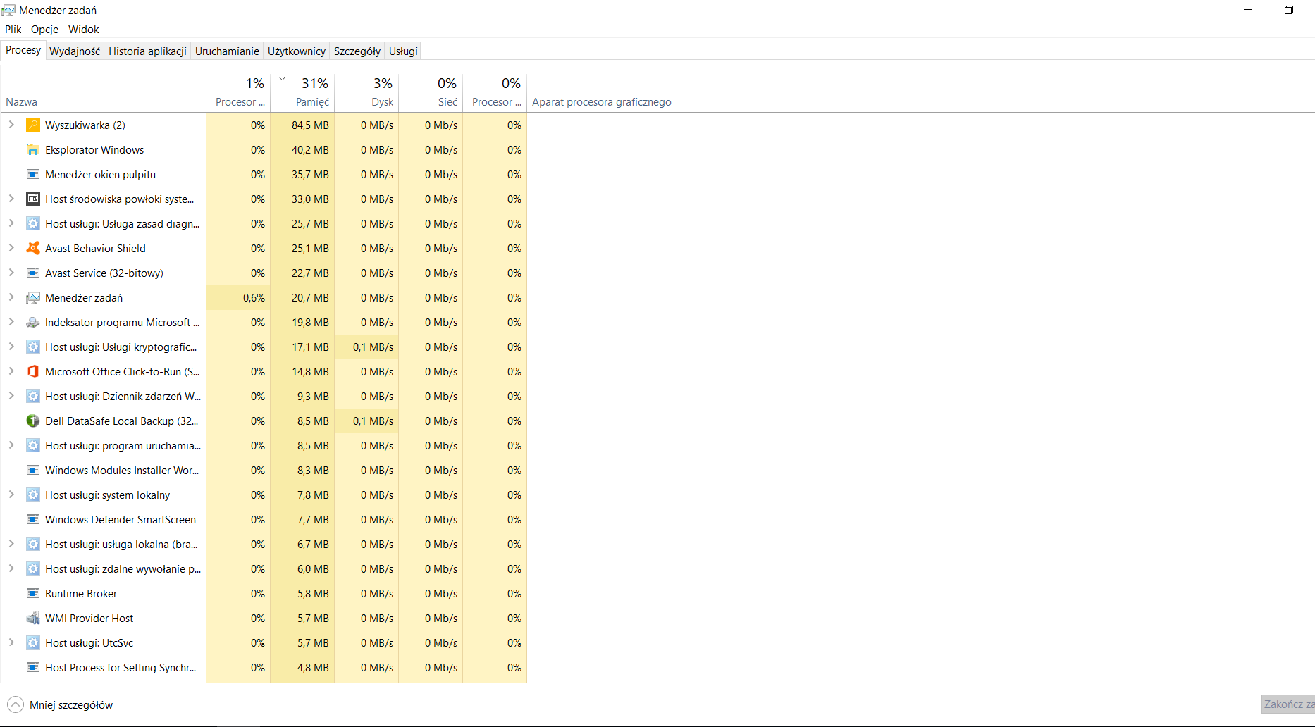

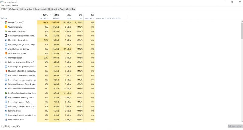

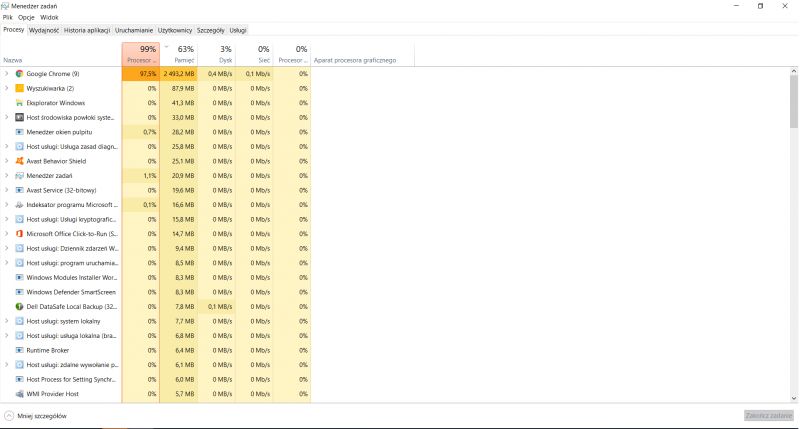

    The situation is that I have about 31% of the frame consumption without running any program. Immediately when I turn on Google Chrome (I have Google Chrome Canary) and the onet start page (the processor jumps to 80% but then drops and stays at around 8-10%, the ram also jumps initially but then normalizes around 35%). However, when I turn on facebook and video on youtube (1080p), ram and processor increase sharply (Ram 63% and still increases and CPU usage also increases to 98-99% which turns off the loaded card. This situation occurred suddenly and did not take place earlier I will add that at Opera with such a load such strange things do not happen (with a movie, fire up face and a few other frame cards about 52% constantly and the processor 40-55% also moves on this scale. What should I do to return it to standards?
    My laptop
    Dell Inspirion 7520 (today is exactly 5 years old)
    Intel Core I5 3210M CPU 2.5 GHZ
    Ram 8 GB
    Windows 10 Home 64bit

    You don't see anything interesting here.
    Install the uBlock Origin Chrome add-on and see if anything changes.
    Next to frst.exe, create the Fixlist.txt file with the contents:
    Task: {8543CF1C-749A-4B36-8254-6A8DB1AF47A0} - System32 \ Tasks \ Opera scheduled Autoupdate 1523387638 => C: \ Program Files \ Opera \ launcher.exe [2018-03-28] (Opera Software)
    Task: {A6636B4A-22ED-422B-AF5A-D8D4FABF8FD7} - \ Microsoft \ Windows \ UNP \ RunCampaignManager -> No file {D0498E0A-45B7-42AE-A9AA-ABA463DBD3BF} -> No file
    Toolbar: HKU \ S-1-5-21-3176346420-1870317931-2783196995-1001 -> No name - {2318C2B1-4965-11D4-9B18-009027A5CD4F} - No file
    Toolbar: HKU \ S-1-5-21-3176346420-1870317931-2783196995-1001- {ED1FC765-E35E-4C3D-BF15-2C2B11260CE4} -04112018100154553 -> No name - {2318C2B1-4965-11D4-9B18-009027A No file
    CHR HKLM-x32 \ ... \ Chrome \ Extension: [daanglpcpkjjlkhcbladppjphglbigam] - hxxps: //clients2.google.com/service/update2/crx
    CHR HKLM-x32 \ ... \ Chrome \ Extension: [eofcbnmajmjmplflapaojjnihcjkigck] - C: \ Program Files \ AVAST Software \ Avast \ WebRep \ Chrome \ aswWebRepChromeSp.crx
    CHR HKLM-x32 \ ... \ Chrome \ Extension: [gomekmidlodglbbmalcneegieacbdmki] - C: \ Program Files \ AVAST Software \ Avast \ WebRep \ Chrome \ aswWebRepChrome.crx
    2018-04-11 10:02 - 2017-07-03 17:20 - 000000000 ____D C: \ AdwCleaner
    In FRST, select Repair.
  • #6 17161719
    kacper2222001
    Everything's back to normal. Thank you very much
