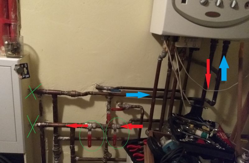

    I have a 24 kW Immergas Victrix boiler (single function) and for the summer I would like to heat only domestic water. Until now, when heating water for use, the water in the entire heating system was heated, which in the heat of 35 ° C will not be pleasant.
    I hope the picture is transparent (sorry for the mess), and I will add that green marked closed valves ("X" means that all valves are closed when separated into radiators).
    Is "closing the heating" thus correct?

    For me, for a 1-function boiler, you have too many pipes coming out of the boiler, and the dimensions do not indicate that it was supposed to be a boiler with an integrated storage tank.
    The number of outputs is more suitable for a 2-function boiler.
    The 1-function boiler needs a water heater with a coil, which I can't see in the photo.
    Generally, heating which when using hot water is a mistake and indicates that the three-way valve is whacked and passes water into the heating circuit, which with flow water heating should manifest as a decrease in capacity for hot water, and if you have a tank with a coil, you lose more energy than in reality need.
    I don't know if your closing is correct because I can't see everything and it is a chaotic installation for me.
    Generally, the heating (boiler) water heats up on the boiler in the primary exchanger and continues to be directed to the radiators.
    In the case of domestic hot water, the same heated boiler water at the 2-function boiler instead of to the radiators is directed to the plate heat exchanger built into the boiler via a 3-way valve. In this plate heat exchanger, cold tap water is heated and already heated it is directed to the tap.
    With a single-function boiler, during the dhw heating, the boiler water instead of the plate heat exchanger goes to the coil built into the dhw tank, thanks to which the tap water accumulated in the tank is heated. In other words, a coil with hot water flowing in it is such an equivalent of a hot heating spiral from a traditional electric kettle.
    The domestic hot water tank itself is usually near the boiler, it can be standing or hanging.
    With these basics, you can analyze how hot boiler water should flow to heat only radiators or only hot water
    At the moment, it looks like the 3-way valve needs to be replaced or possibly cleaned, closing valves manually is more to powder the corpse than solving the problem ;)

    The 120 l container under the stove (this mess on it) is connected to the three-way valve built into the boiler.
    So it turns out that only the 3D valve could fall.
    I currently have other important expenses, so the boiler will be able to run as it is now (with the valves turned off), is the valve eligible for immediate replacement?
    A problem similar to this, so it must be 3D. Thanks for the help.

    Assuming that the filter is well mounted, the flow directions are poorly marked.
    In principle, the 3D valve is responsible for directing the boiler water into the central heating or hot water circuit and it depends on it whether heaters will also be heated during hot water heating.
    Nothing else comes to my mind, hence the conclusion that it is the fault of the 3D valve.

    I took a look at the instructions for the new Victrix EXA 24 and power supply what is the extreme right exit, and return what is the second counting from the right, which means that the author has mistaken directions.
