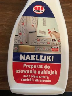

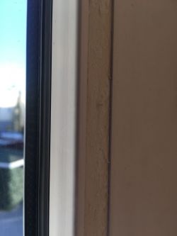

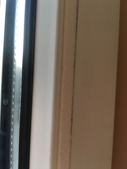

    For many years, I had roller shutters installed in my apartment, with side slats glued to the glazing beads (for better blackout). For some time, the blinds not only fell apart, but did not suit the household members. I decided to disassemble them and replace them with pleats.
    The problem arose with these dimmer bars. They were of good quality (assembly quality was also good) and were stuck on a thick, "sponge" double-sided tape. After being torn off, the tape practically remained - in the form of a "sponge". I carefully scraped off the remains of this sponge. It's not all gone and there's tape glue underneath - I treated it with chemicals:
    - a preparation for removing stickers
    - WD40
    - extraction diluent
    - and even a nitro thinner
    It barely comes off, only after stubbornly rubbing it and rubbing it with a rag. I grumble, and I won't clean it. Anyone have any idea what else I can do with this? I attach photos 1- before scratching, 2 - after scratching, 3 - after chemistry.

    Some standard from the market for PLN 15.
    How to "dissolve" the old, "sponge" double-sided tape?
    I've already searched the entire internet and many people recommended WD40. Nitro advised me against it, but nothing would help me, so I even decided to try it. But I am still standing still: /

    vampire86 wrote:
    Some standard from the supermarket
    And that is why such "effects" :lol:
    Buy a decent dedicated spray, not some water-based crap and additionally expensive. Must contain solvents.
    E.g:
    http://www.soltronik.pl/spray-zmywacz-do-etykiet-150ml-micro-chip/p-14505.html
    https://bau-tec.pl/pl/p/LABEL-KILLER-spray-300ml-do-usuwa-naklejek%2C-kleju-i-etykiet/1331

    Robert B wrote:
    E.g:
    http://www.biall.com.pl/item,PRF-LABEL-OFF-Spray-do-usuwa-naklejek-220ml,402082.html
    Are you saying it can handle it, and gasoline and nitro sucks ...?

    If it does not come off with an extraction solvent or nitro - then alcohol or acetone remains, or a gel remover for old paint coatings may cause the tape to "swell" and it can be removed with a plastic spatula (so as not to scratch the frames).

    You have to be careful with everything - it's best to make a gentle sample, I was washing the stickers with acetone from the windows and nothing happened with the plastic, but the nitro was dull.
    Of course. Gasoline is good for degreasing and evaporates quickly, as does nitro, and the solvents in sticker remover are slow-evaporating hydrocarbons that stay longer on the surface of the adhesive, dissolving it. After covering with the remover, wait a few to several minutes.

    I had a similar problem with the window frames but it was related to adhesive tape ...
    The tape stuck on the outside under the influence of the sun even "vulcanized" with the plastic frame.
    This preparation helped me:
    In general, he cleaned everything up - even the old emulsion from the last century ...
    I'm not saying that you will splash and everything will run off ..... you also have to scrub, but the torn piece of glue does not smear and does not stick again.
    Shake the container (two-phase agent), spray it, wait a few minutes, then spray it again and scrub the soaked ones.

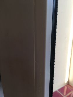

    Because of the "porous" structure, you must first mechanically remove as much as possible.
    Then with a preparation for removing stickers.
    Fresh orange peel can be used as a substitute. Breaking it, sprinkle the juice that peels the glue. It should dissolve.
