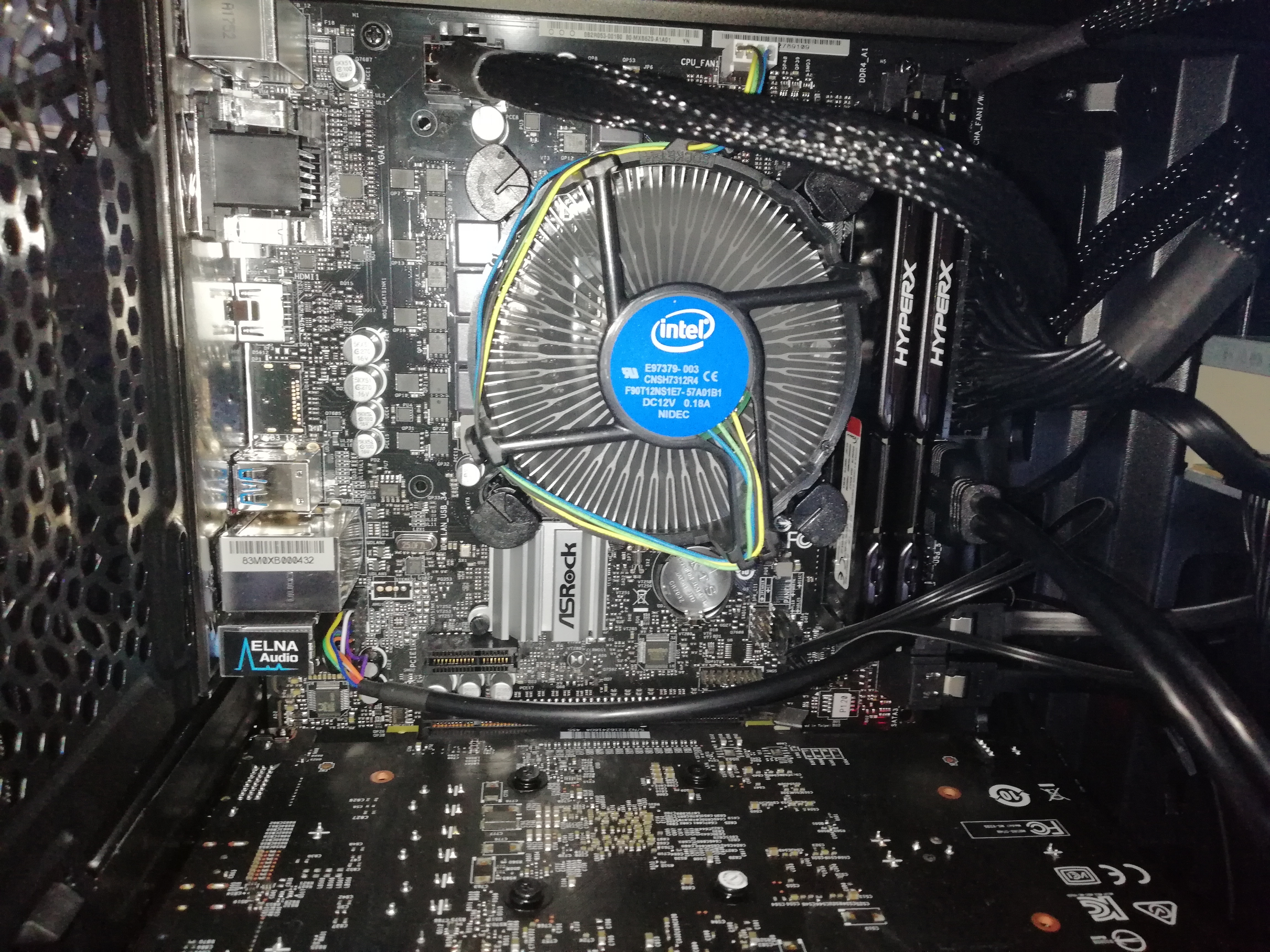

    Hi, I have a very unusual problem with Windows 10. I installed the system, the drivers are fine. But the problem is, the computer won't turn off. When I select the "Shut Down" option in Windows, everything seems to turn off on the monitor, after a while the mouse and keyboard with the monitor go out, but the graphics card, processor and fans work at their best. You can wait for half an hour and nothing happens. Please help.

  • #4 17181729
    Pedros050
    Posts: 17914
    Help: 2471
    Rate: 3927
    The computer was assembled by the store? You just installed the System?
  • #5 17181734
    matyjeste
    Posts: 8
    I assembled it myself and installed the system
  • #6 17181759
    Pedros050
    Posts: 17914
    Help: 2471
    Rate: 3927
    And show how the power supplies are connected there? Everything well set in the BIOS?

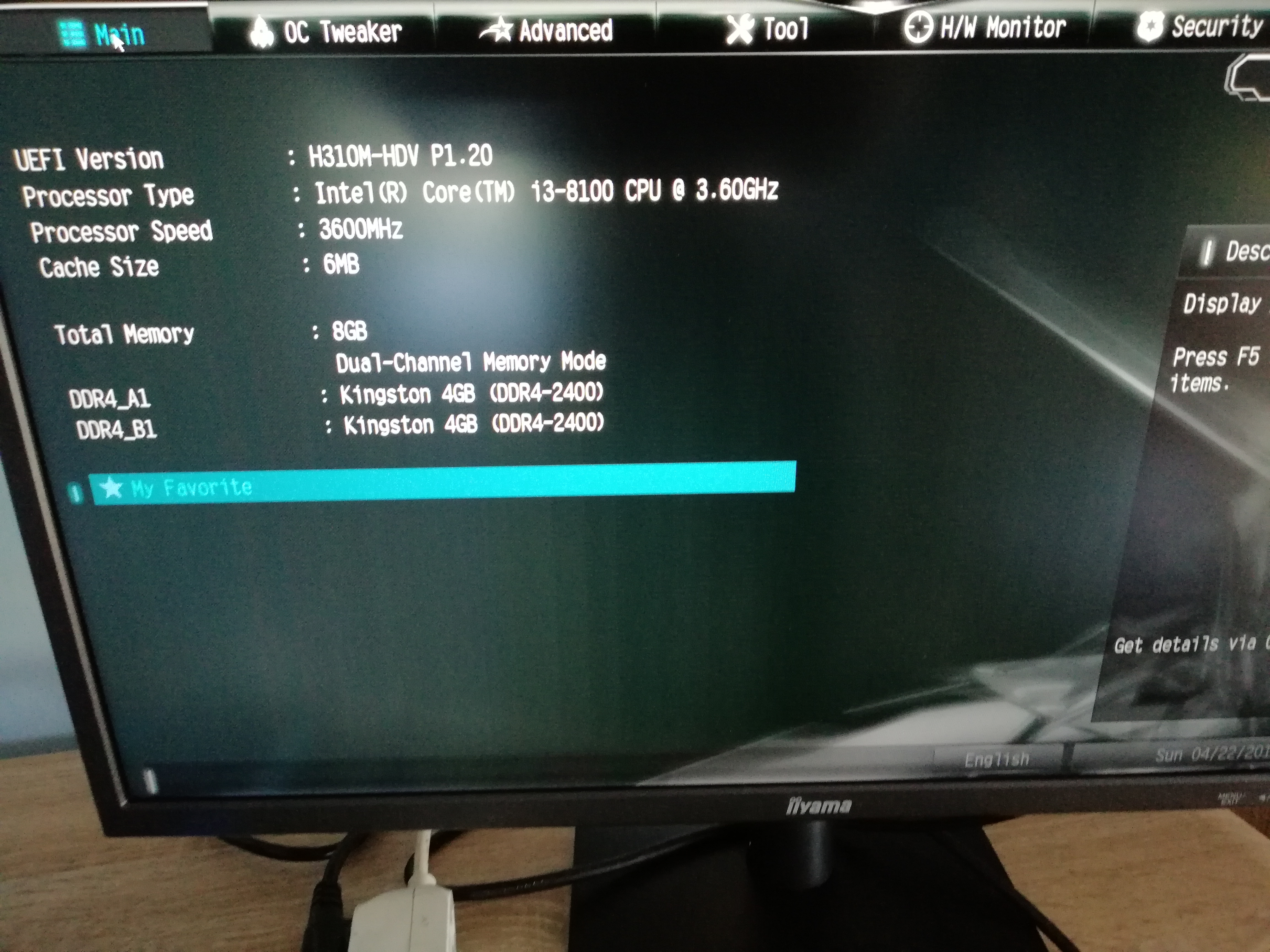

    Computer Won't Turn Off - The computer shuts down the OS, but the components factory settings in bios, nothing buried

    Put the settings from the BIOS.

    Which bookmark? Computer Won't Turn Off - The computer shuts down the OS, but the components

    Open Tool and see if there is anything about power supply.

    UEFI Tech Service
    UEFI Update Utility
    Instant Flash
    Instant Flash- DHCP (Auto-IP)
    Network Configuration
    that's it in the Tool tab
    #12 17181995
    Pedros050
    Posts: 17914
    Help: 2471
    Rate: 3927
    H/W Monitor?
  • #13 17181998
    matyjeste
    Posts: 8
    Okay, topic to close. it turned out that removing the BIOS battery for 30 seconds solved the problem. thanks for the trouble :)
