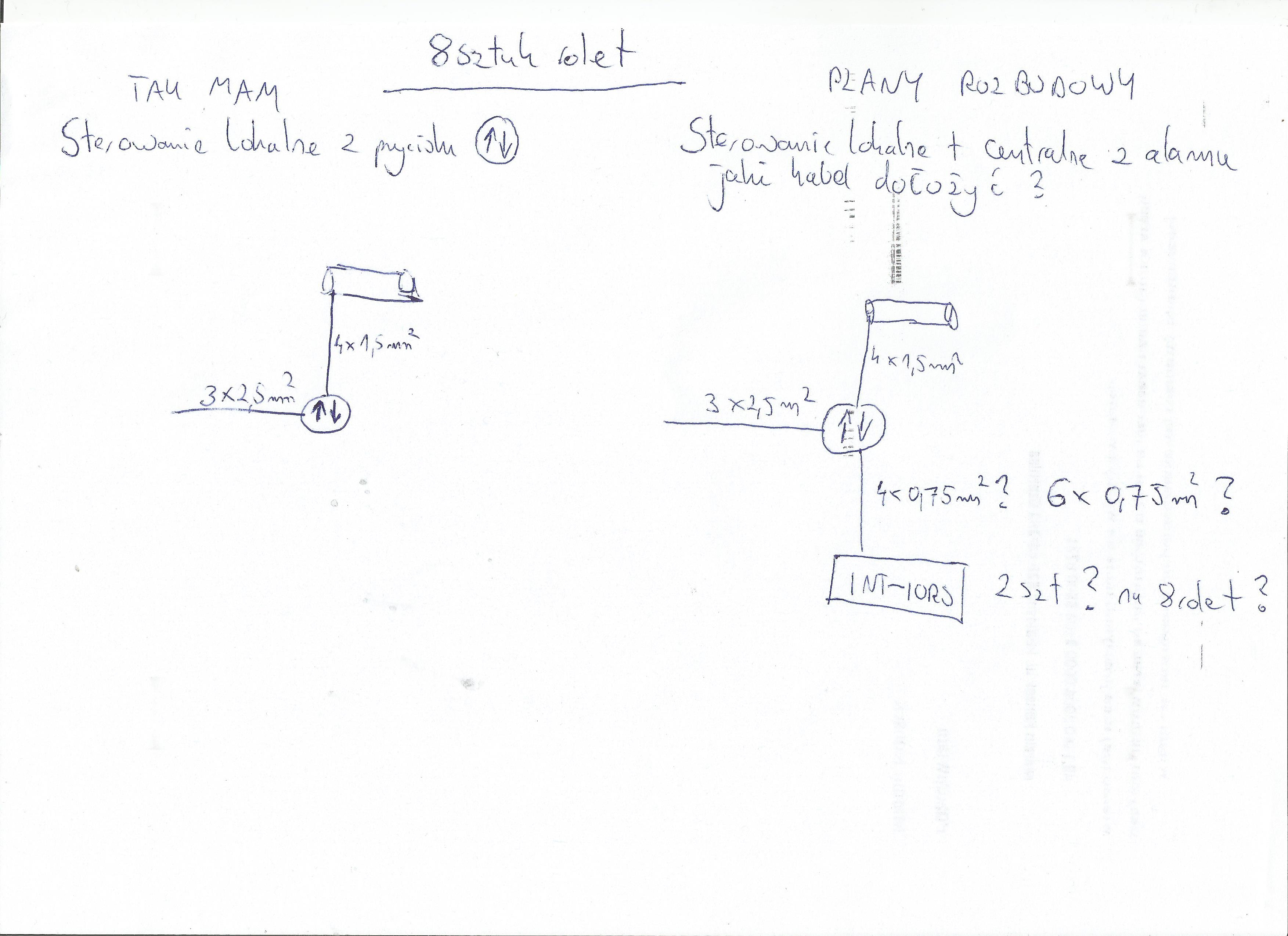

    Hello. I am finishing the electrical installation and slowly starting the alarm system at home. Initially, my wife wanted to control each roller shutter with the up / down button next to the window. . While browsing the internet, my wife came up with the idea to prepare the roller shutter control by the alarm control panel (we have not bought the model yet, so I will not provide it). Please help, because I have 2 weeks to plaster, what's the easiest way to convert my current roller shutter installation? Which cable should be added to each box by the window? The only thing that caught my eye quickly was the diagram I found:
    Local Button & Centralized Alarm Panel Roller Blind Control: Converting Installations & Wiring
    If I understand it correctly from the local button to the motor, 4x1.5mm2 is still enough, and you need to add a 4-wire control cable between the control panel and the box with a local button?

    Add a 4-wire cable between the local buttons and the output expander, only take into account that the roller shutter controller can be controlled L so the cable must be selected for 230V. It doesn't have to be 4x0.75 thick, it's enough.
    At the central button, do not run the cables to the button only to the central controller, there it will be connected to the controller a bit differently, but the controller will definitely be in the switchboard, so there should be no problems.

    Of course, 4x 0.75 is the minimum for me. I assume the controller will be in the switchboard, i.e. from the local button I run a 4-wire cable to the switchboard?

    Write exactly how you plan to do it. For each roller shutter there will be a controller, e.g. STR-1 and a button next to the window to control, and besides, you want to be able to control it all through INTEGRE, will there be no other drivers and everything should be done by Integra?

    then if without other drivers, put the INT-IORS expander in the switchboard, from the switchboard to the 4x1.5mm2 roller shutter, from the switchboard to the local button controlling the roller shutter alarm, e.g. ytdy 6x0.5
    And do not forget to put an alarm device from the switchboard to the alarm control panel, preferably 2 pcs.

    buddy, it's best to draw a diagram of how you are going to lay the cables and write what functionality you require, it will be easier to get along and check if you have no veins when firing.
  • #15 17194403
    kood
    Posts: 1896
    Help: 259
    Rate: 443
    So now you have an installation placed under the roller shutter controls without the possibility of central control.
    I see such possibilities here:
    1. you put on a controller in a box, you add control cables from the control panel to each roller shutter
    2. you throw out what you have, you put between the int-iors and the 4x1,5mm2 roller shutter motor and between the int-ors and the ytdy button
    3. you leave everything as you have now, you choose Fibaro.
    Option 3 will be the most expensive but it gives the greatest possibilities, you will save a little on the control panel because it can be simpler and without additional modules and cabling.

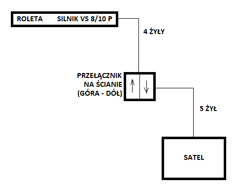

    If I understand your concept correctly, can I do this (so as not to pull the cables separately from the blinds to the control panel and from the switch to the control panel):
    1. From the roller shutter I pull a 4-core cable to the box where there will be a switch on the wall.
    2. I pull a 5-wire cable from the box, where there will be a switch on the wall, to the control panel.
    3. In the box on the wall (where the switch will be) I make all connections between the shutter, the switch and the switchboard.
    Is such a solution an option?

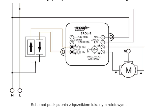

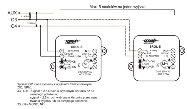

    Or maybe it is better to use the SROL-S roller shutter module and central control from the OC outputs.
    The module also solves the collisions of local and central control, full OPEN / CLOSE control from a short press of the switch.
